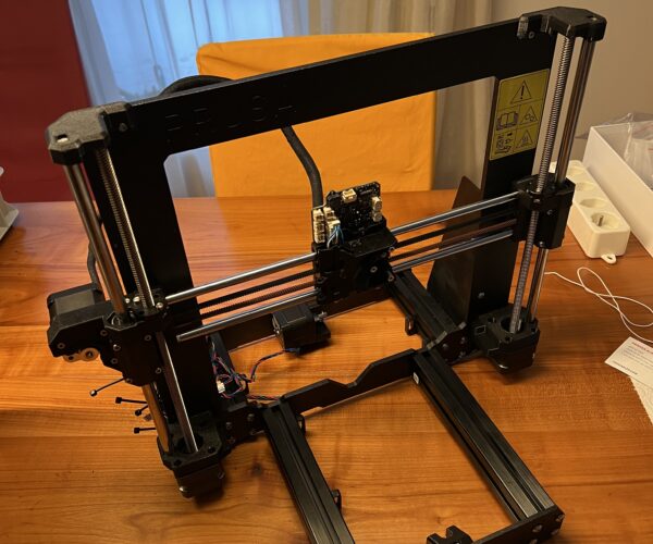

Things seem to be going well. I have completed the Z-axis assembly.
My only key insight at this point is this: if – for whatever reason – you print all your parts in black, it is sometimes very difficult finding holes and other parts that you need for orientation. I'll admit to being old and having eye-sight that was once better, but I think this might affect others too.
My ideal set-up for this work would be a pedestal about 110 cm high with a plate on the top just big enough to hold the printer so I can get 360° access, and with a good light source immediately overhead. I'll bear that in mind if I ever diversify into Prusa construction. 🤣

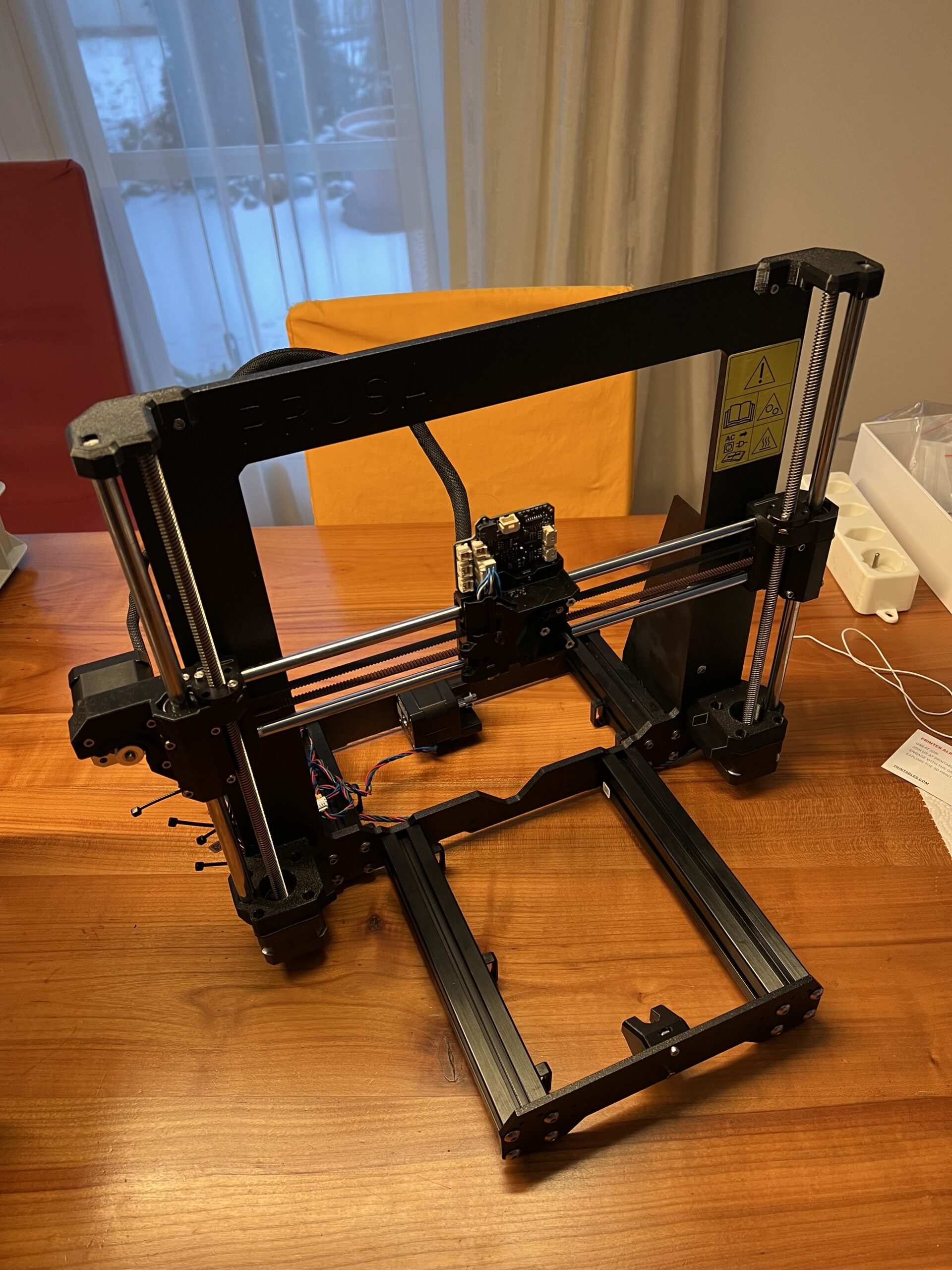

This is what it looks like at the moment. I haven't mounted the PSU because it will be going straight back into the enclosure. I've also got a "PSU Cable Quick-release for Original Prusa Enclosure (MK4)" on order.
I'm now doing the extruder assembly. I am filled with respect for the guys who designed this stuff.
Also, the parts that I had to get done by a third party because I didn't prepare the prints properly (see above) are not as precise as the ones I printed on the Mk3S+, as it was. The third party doesn't use Prusa.

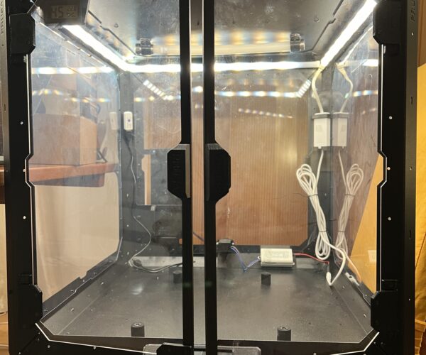

I've got to the but where you assemble the xLCD. When I moved the Mk3S+ into the enclosure I had to use modified xLCD supports to move the xLCD (or whatever it was called) onto the front of the enclosure. I tried mounting the xLCD using its current supports onto the enclosure thus:
As you can see there are physical problems with this as the doors of the enclosure no longer close. It may also be that the xLCD cable is too short to reach from outside the enclosure into the xBuddy box. I'll solve this one later. The answers seem to be here.

yeah once you have a working printer again you can always print modified parts lol.   I have a different enclosures for mine but my xlcd is still attached in the default place on the printer itself.

To tidy up my enclosure and make it easier to handle, I’ve ordered a quick release for the enclosure. I find it difficult to understand why it is an extra and not part of the basic enclosure offering.
However, I’m now at the point where I have to start wiring up the PSU, which is attached to the enclosure anyway. Prusa don’t seem to have thought of that in their otherwise superb installation guide. I’m going to have to wing it one way or the other. Not sure how to proceed…
