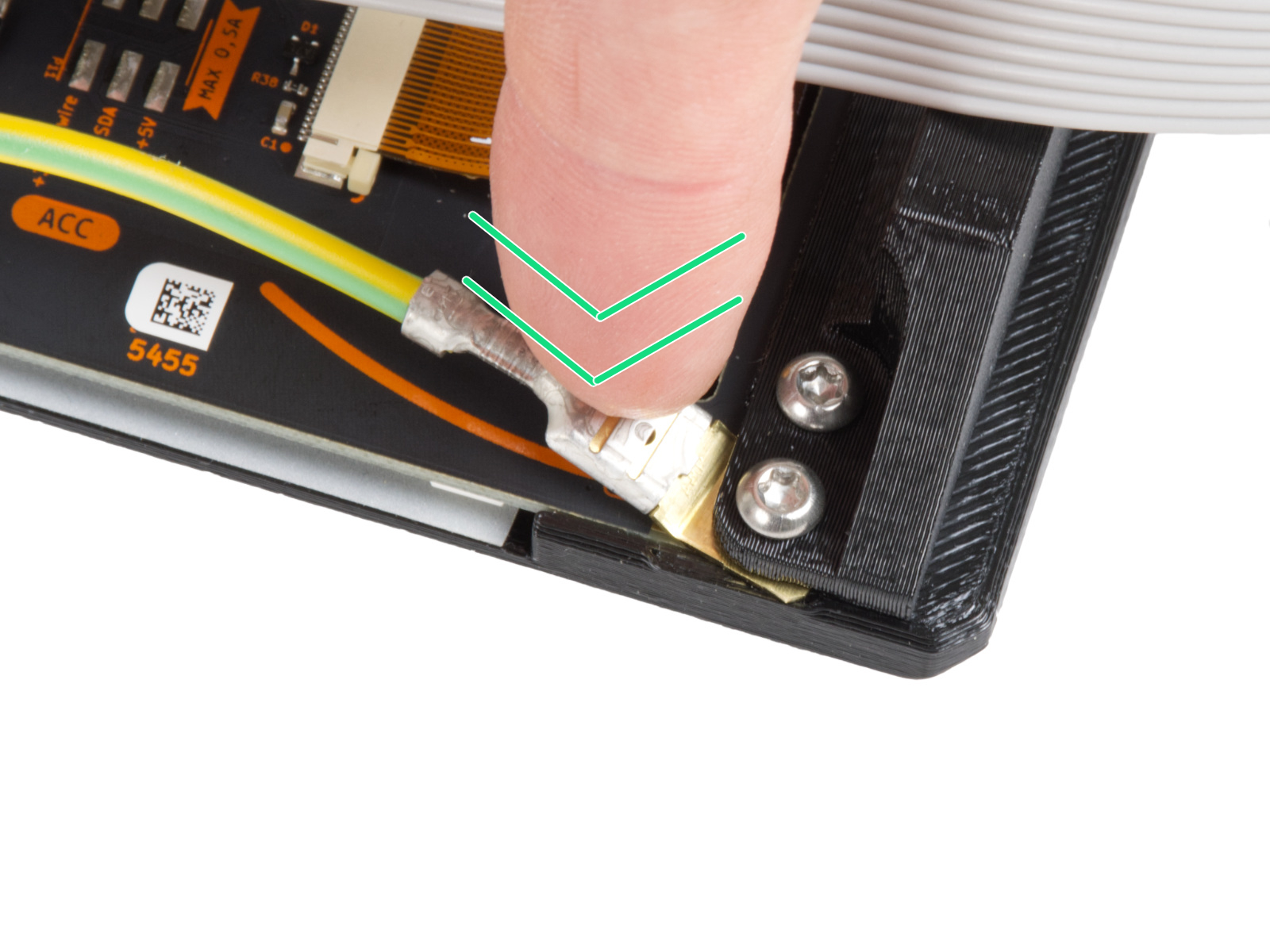

Version B of the XLCD Assembly puts the PE cable within millimeters (or less) of the surface of the printer stand. Any slight angling of the printer while moving it can cause the PE cable connector to gouge your table or stand.
I recommend:
  1. angling the connector slightly inward (as is shown in the assembly documentation pictures), and
  2. connecting with the flat side towards the board (flipped from what is indicated in the assembly docs)
With the connector oriented with the flat side down, you will be able to bend the connector closer to the board and further from your table.
From MK4 assembly instructions
