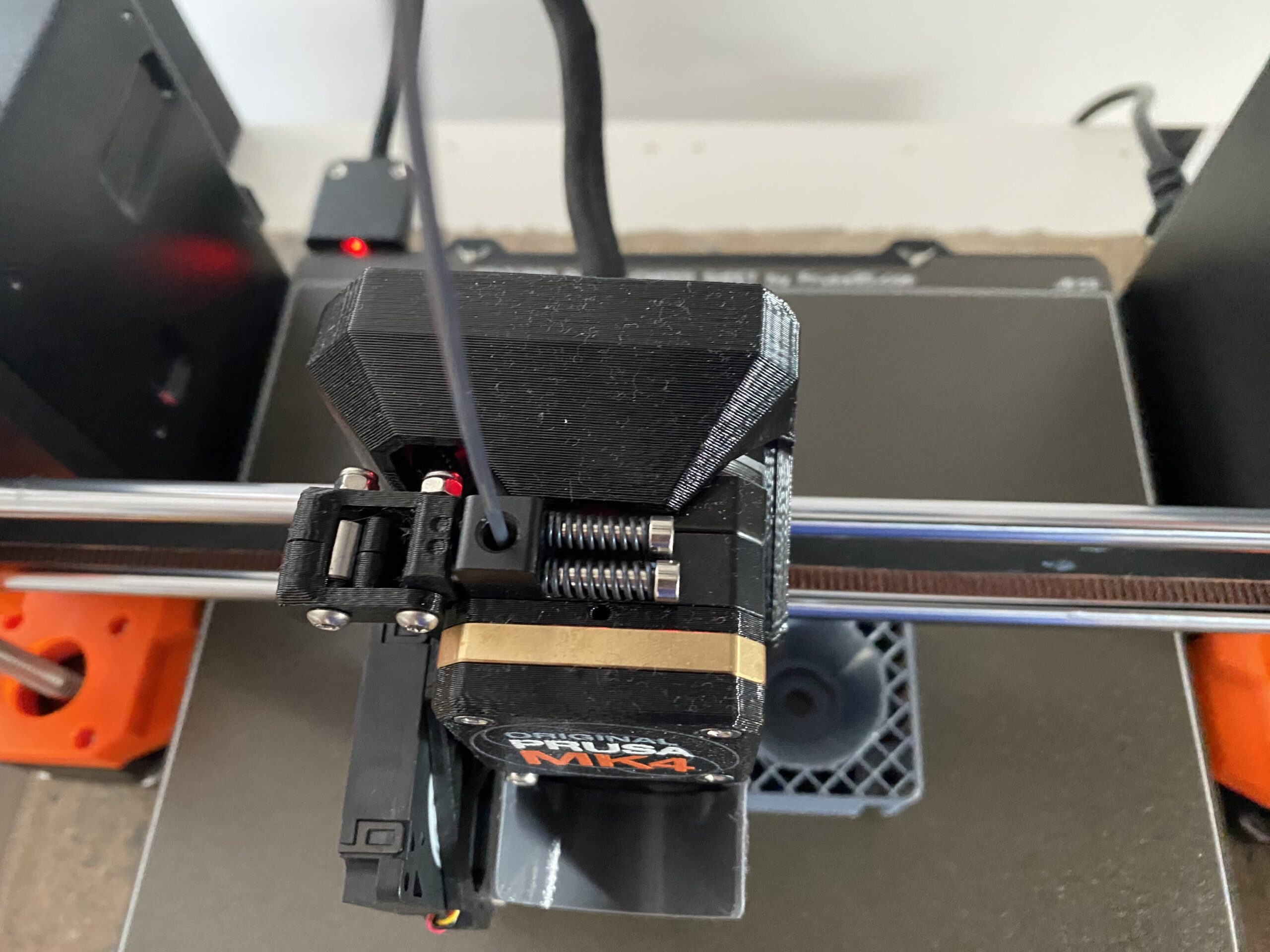

Is it normal for the nextruder to twist filament as it feeds? Mine is twisting the filament counter-clockwise, causing it to rub against the frame while printing.
It's not a huge deal, but if this isn't normal I'm going to try to find out whats wrong. The only problem I've really noticed is that I can hear the filament scratching against the frame from the next room, and it makes me think the spool has tangled or something.

Adjust one of the tensioning screws. Not much, maybe half a turn. Your tensioning lever is putting uneven pressure on the filament, you need to correct that to avoid the issue.

Thanks, that makes sense. And making the adjustment worked, although it took a few tries. It seems rather precise. I have more tension on the screws that what the assembly instructions suggest (no extruder clicking though!), so maybe that is a contributing factor.

Since you didn't have a problem before changing filament, you might want to make sure the new filament isn't the problem before messing with the tension. But if it is the tension, I'll try to explain the process, hopefully not getting it backwards.
The general idea is to find out which way the filament needs to turn to untwist itself, and then tighten or loosen the appropriate screw to have the extruder twist it more in that same direction. Follow these steps:
  1. Unload the filament, but hold the end, not allowing it to un-twist
  2. Pull the end of the filament towards your nose, so that it forms a straight line from in front of your face to the spool
  3. Loosen your grip on the end and note whether the filament unwinds in a clockwise or counter-clockwise direction
  4. If clockwise, the screw further from you needs to be tightened (or the closer screw loosened)
  5. If counter-clockwise, the reverse of #4.
To understand steps 4/5, imagine placing the end of the filament back in the extruder, and consider which screw must be tightened to impart the same clockwise or counter-clockwise twist you identified in step 3. The filament will twist in the direction of the tighter screw.

Thanks. Now I know I was tightening the wrong screw, hahah! Also I had to tighten quite a bit, so I think the plastic parts were wonky. I already had my idler lever and the hatch replaced with my own prints as the factory ones were uneven and overextruded. But I didn't swap the one that holds the screws. Now I did and nothing twists even with the screws almost level. The idler lever also keeps itself in the middle of the hatch now instead of trying to tilt itself to one side. I guess that's the main reason for the twisting, it must have crooked itself when I was fiddling with filament change.

I put it on a side topic, but I'll put it here as well: I had problems twisting the filament. Tightening and loosening the bolts did not have an effect. Finally, I printed parts idler-lever-A-R2.stl, idler-lever-B-R2.stl, idler-nut-R2.stl and 2x idler-swivel-R2.stl. Print settings: layer 0.15mm QUALITY, infill 20% grid. PETG material. After replacing these new parts, the filament stopped twisting. Do not forget to calibrate the gearbox after assembling new parts!

I also had this problem fairly severely with my self assembled kit MK4. In my case the solution was replacing idler-lever-A & B, the idler nut and idler swivel. On removing the old parts I did notice that the set screw seemed a bit loose so maybe that was the cause of the problem rather than the printed parts. However my printed parts are prettier that the one that came with the kit.

I haven't yet done a large PETG print to fully test it quite yet, but printing the above parts myself at .15 structural and then very carefully aligning them during installation has eliminated evidence of twisting on small parts for me.  I do have need for a 6-8hr print task for a jig needed at work, so once I have time to model that I'll have a longer print test to try.
With the original parts I was getting early evidence of twisting even on small parts, and I could visually see that the alignment of the idler parts wasn't perfect, either from factory printing or assembly, or possibly both.  The new parts look much better, and assembled in perfect alignment.
