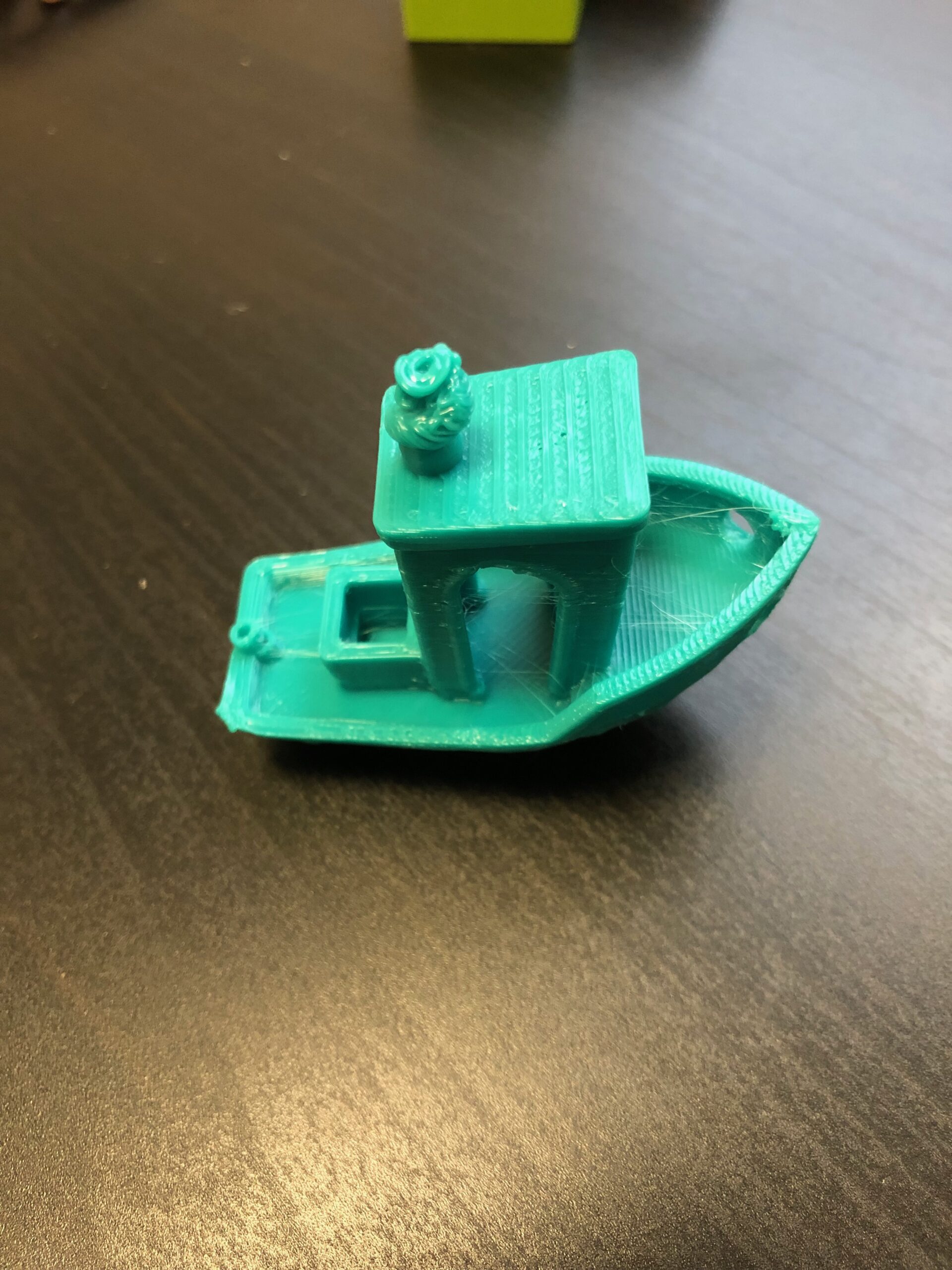

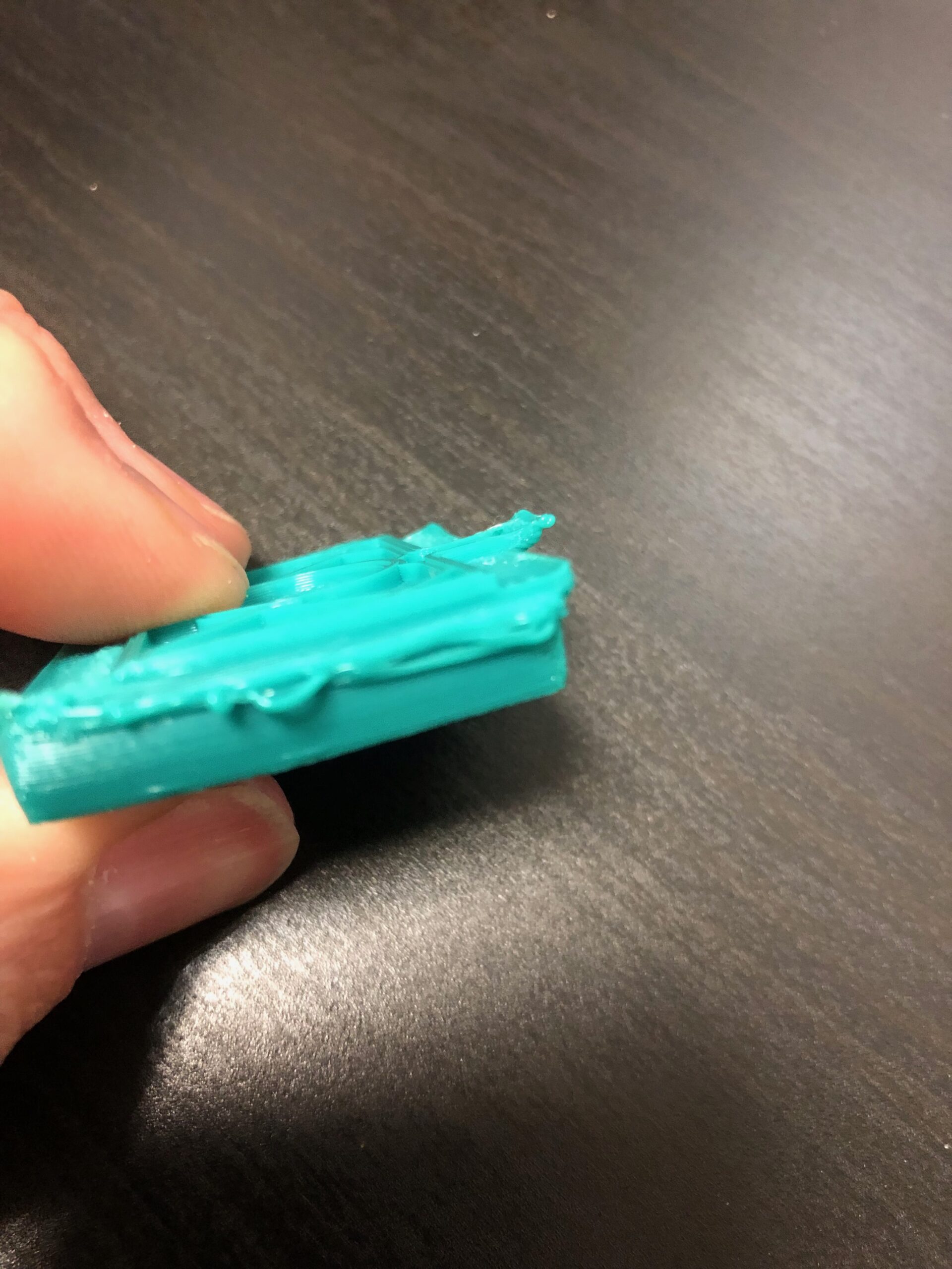

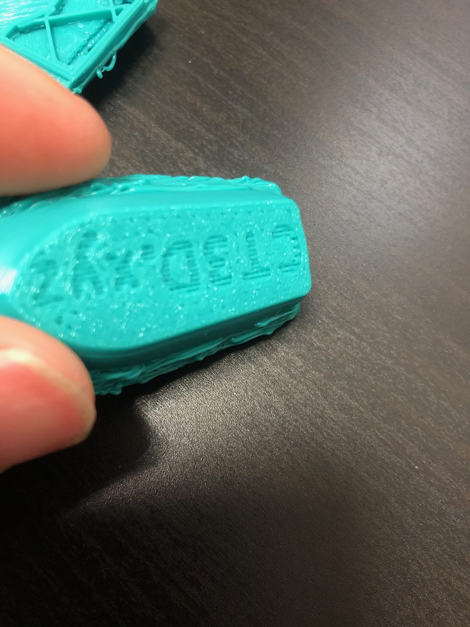

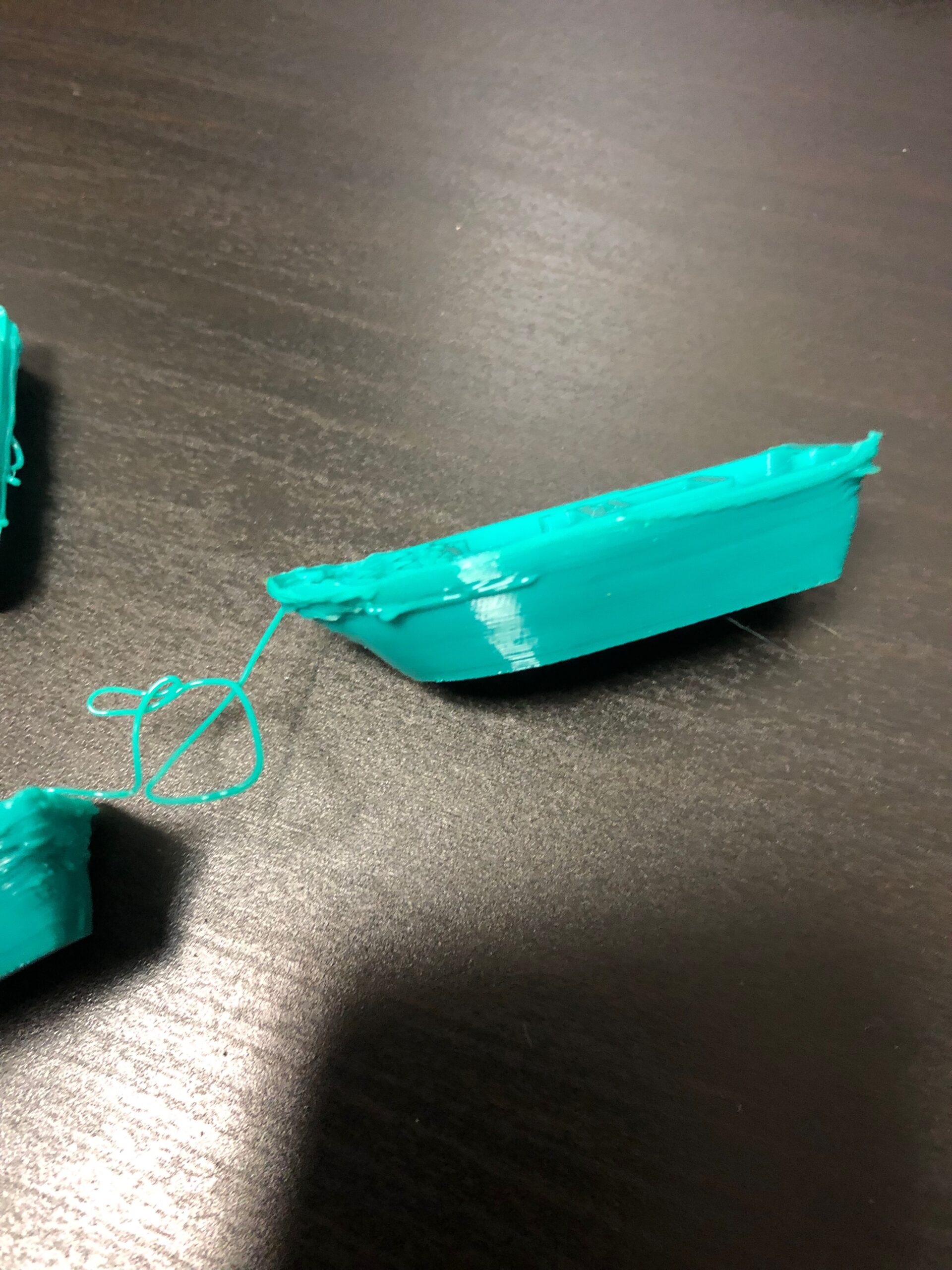

Hi everyone - i just got my new MK4 ad was hoping to get an easy start - but thats not the case.
I think there is some sort of extrusion problem which im unable to locate.
I first updated the firmware to 5.01 - but downgraded to 4.7 to check if it was related to a firmware issue.
I checked the belt tension (as i had several layer shifts) and after setting the belt tension to the right value i got no more layer shifts.
But: I get a terrible print result... 🙁
I changed to a 0.6 nozzle (thats the nozzle i will use for my production)
Any ideas what to do next?
Thanks a lot for your help!
Cheers - Peter
Thats how my prints look like:

Hi everyone - got some help from the chat support.
Seems like most of the problems were related to the input shaper. One belt was not aligned perfectly - and we also fixed that.
Switching off IS solved nearly all of the problems.
Hope this helps others as well - not sure whee IS is going - would safe me 20-30% of printing time - but so far the results in my case are not good... Quality decreases a lot - on the surfaces and at the edges!
