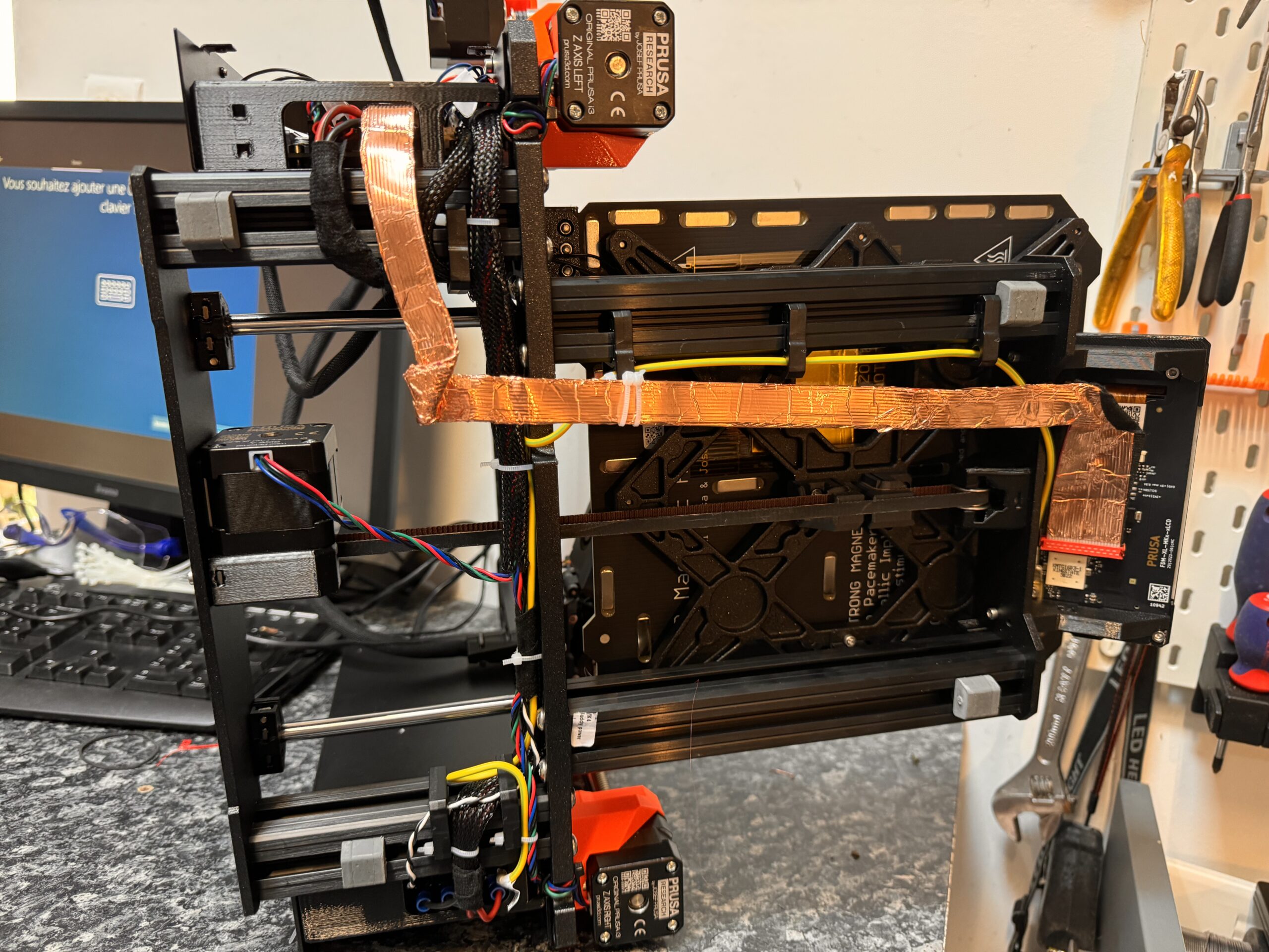

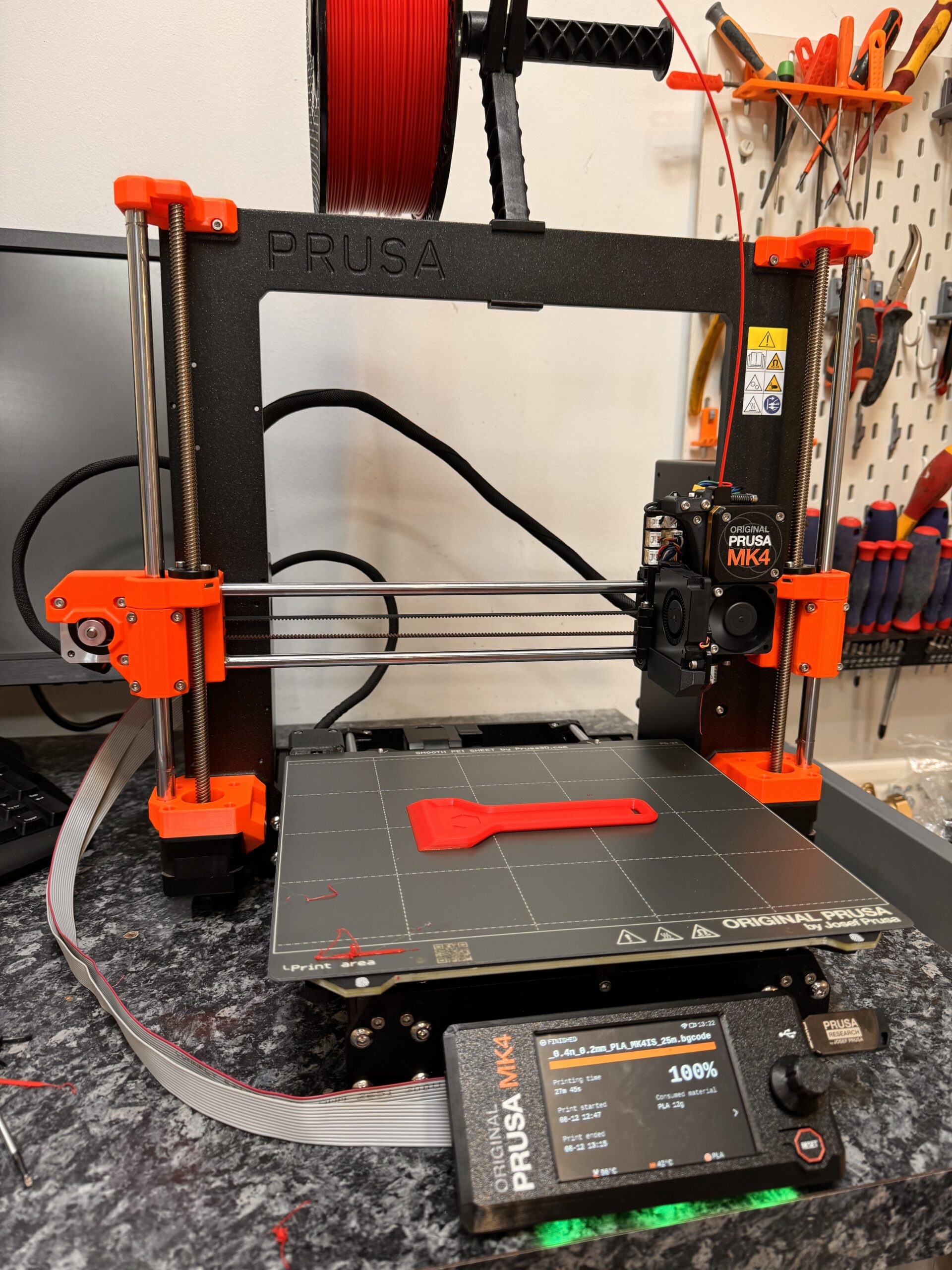

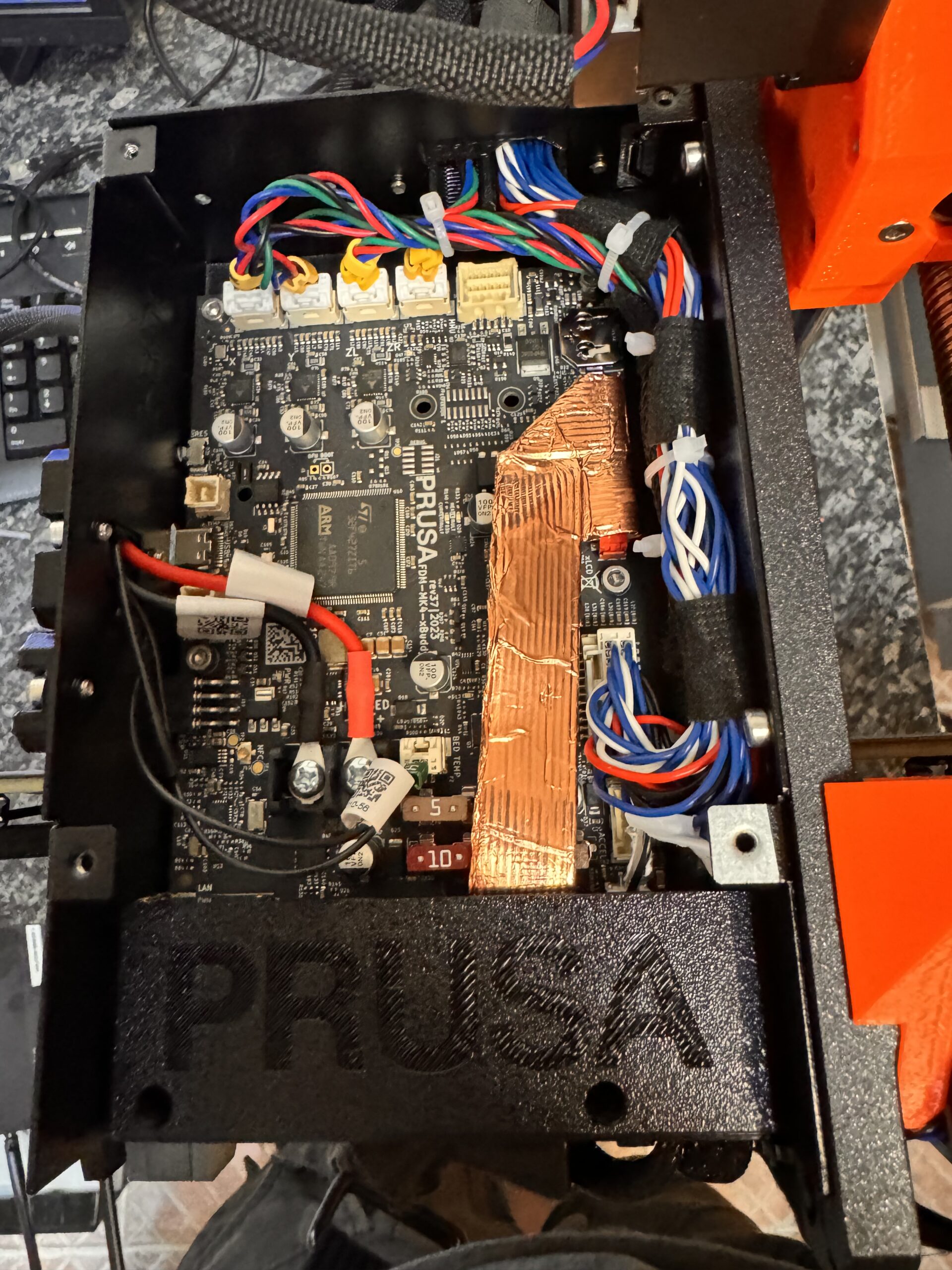

Hi, to check if the issue is stil related to EMC, I completely remove the ribbon cable and attached it from the exterior of the printer without touching any other cable... and it works now... I have order copper tape to properly shield this cable. erwan

Hallelujah, there is finally someone to share on the solution of copper tape. Or, at least, who speeks about it in this forum. (Thank You Lucas Quigna 😊 ).
For information, my MK4 (assembled july 2023) has now around 80 days of real printing time and no more screen issues, since I applied the copper shielding on the display board ribbon cable (even after placing it in a prusa enclosure in february 2024).
As told in my previous message (28/10/2023), in matter of EMC suspicion, such a solution needs to be validate by repetition. In that case, Lucas Quigna, Your feedback in concerne of using copper tape will be relevant and I would be happy to share it with You
Posted : 12/08/2024 8:15 pm

With the ribbon cable removed from the proposed routing path, the printer is working continuously since 2 days without a single issue.
Support has proposed to send a new screen, but I will first try to shield the ribbon with copper tape... at least like this I will know if it is the real solution

Lucas Quigna
(@lucas-quigna)
RE: Mk4 screen goes blank after some time
Here is how I shield the ribbon cable with copper tape (amazon)
