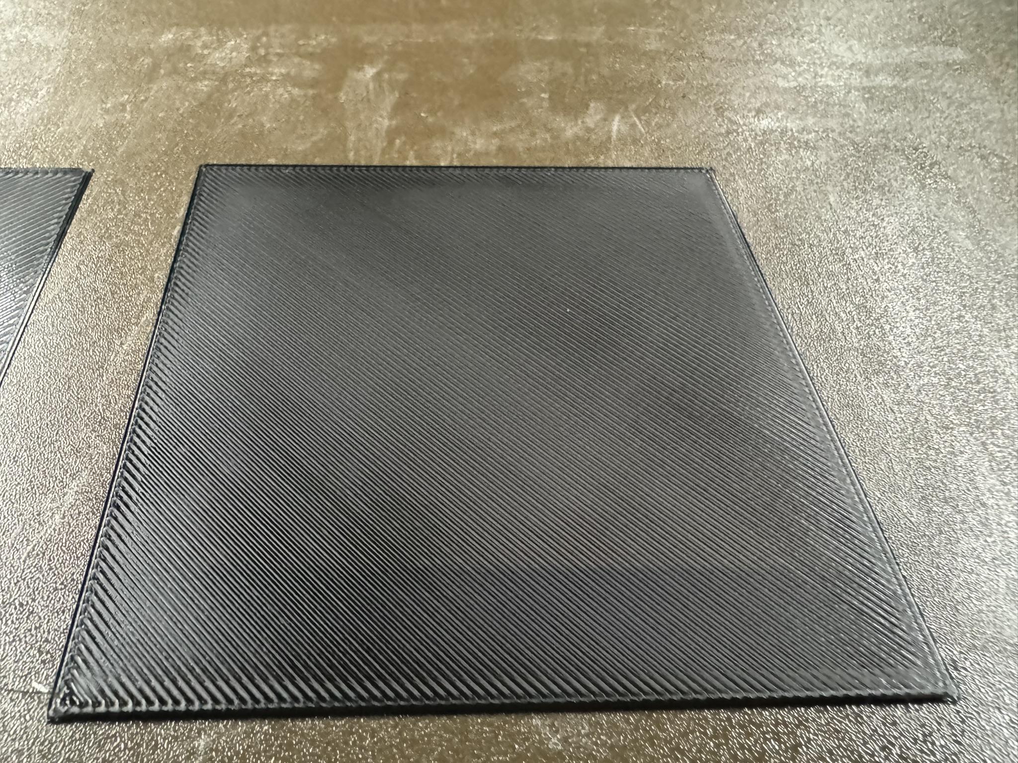

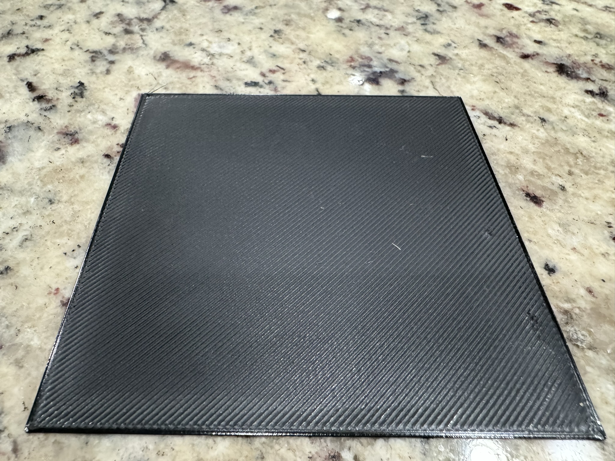

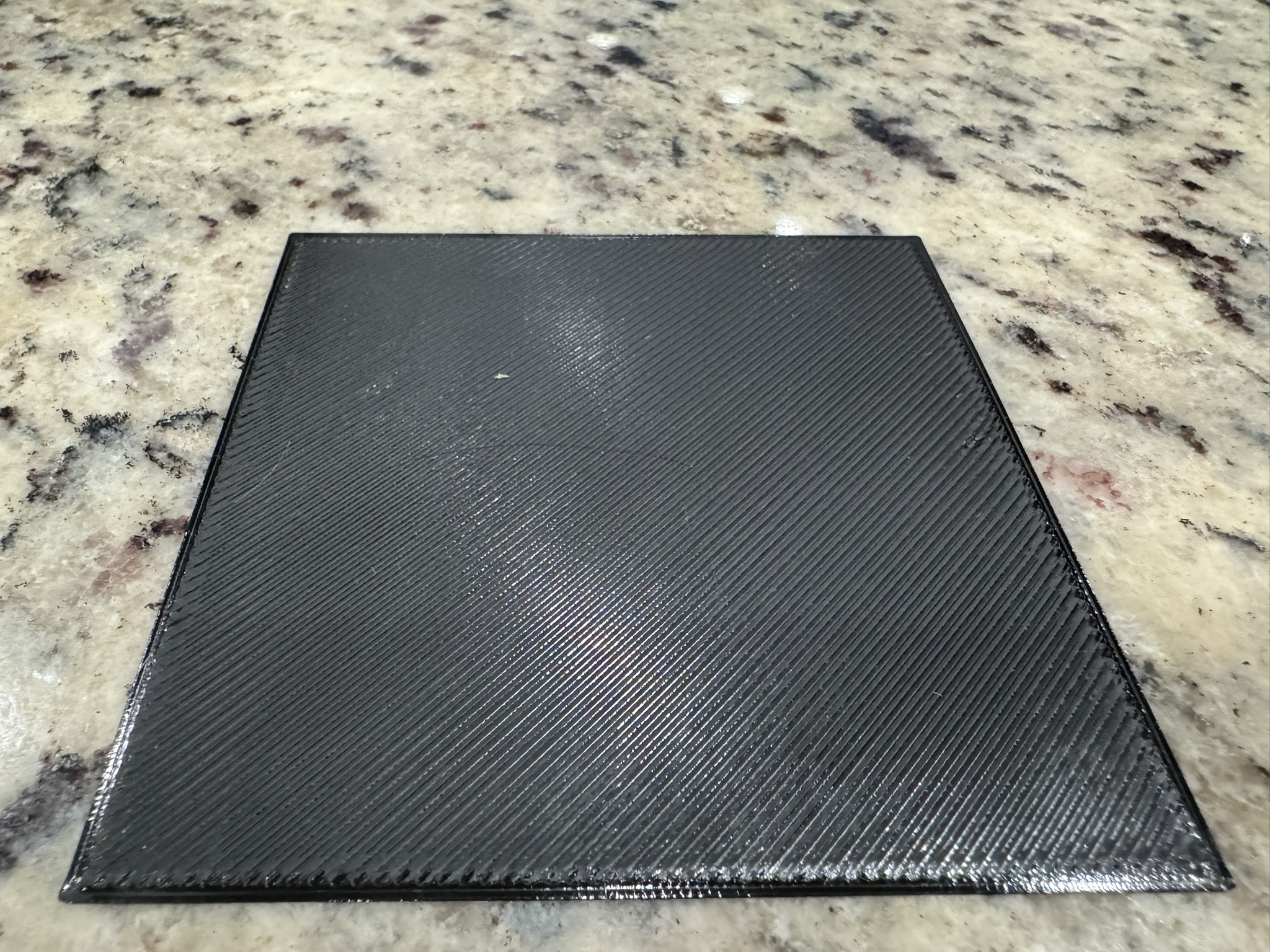

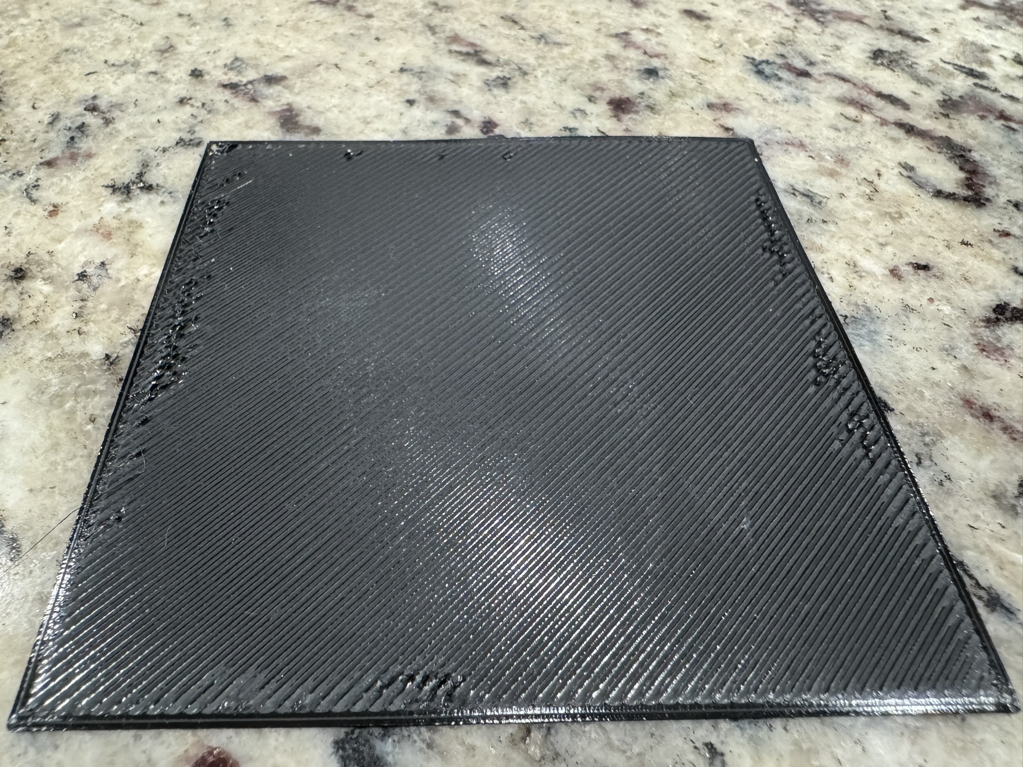

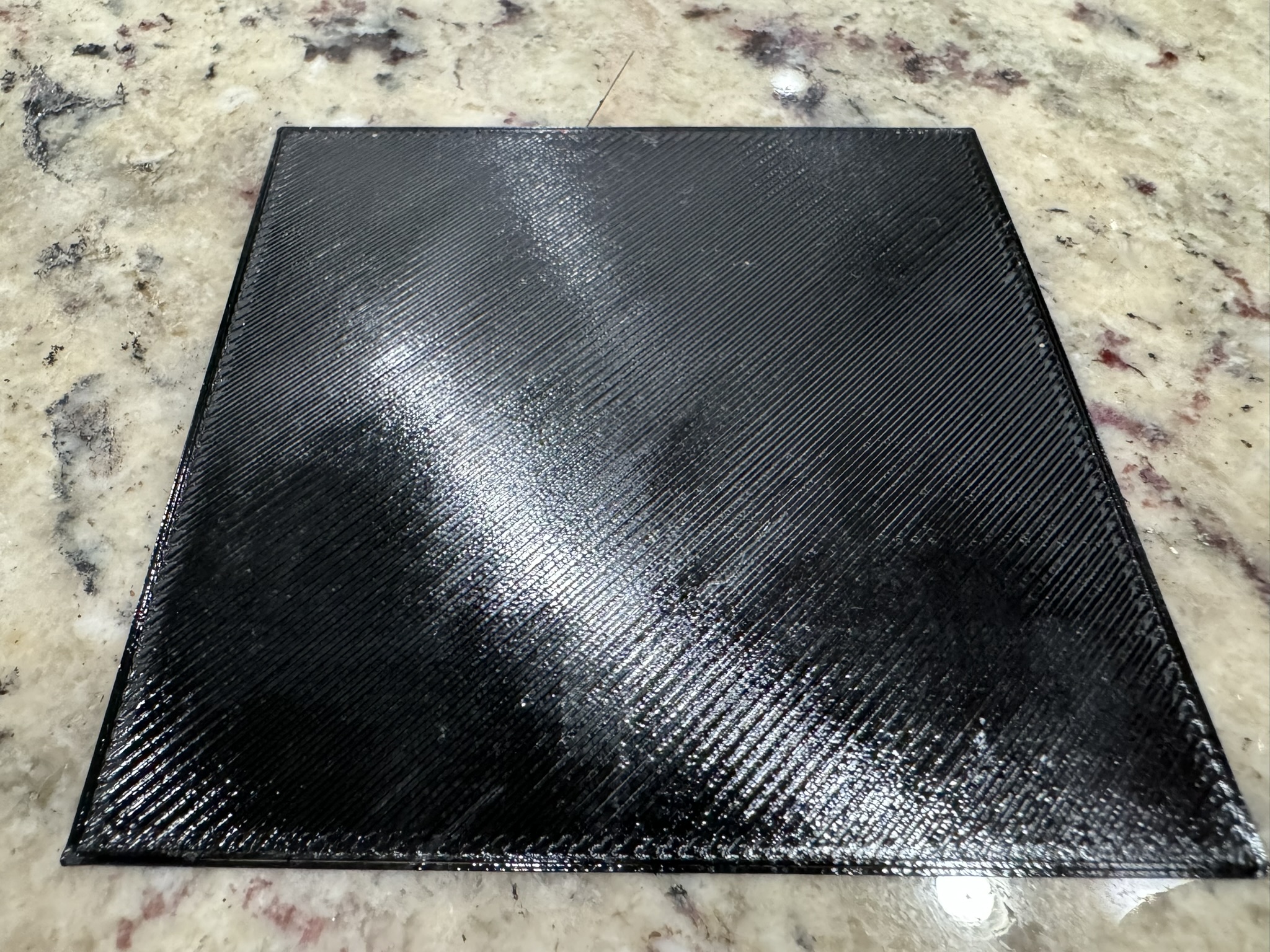

xilni
(@xilni)
RE: Mk4 can't print PETG on textured sheet

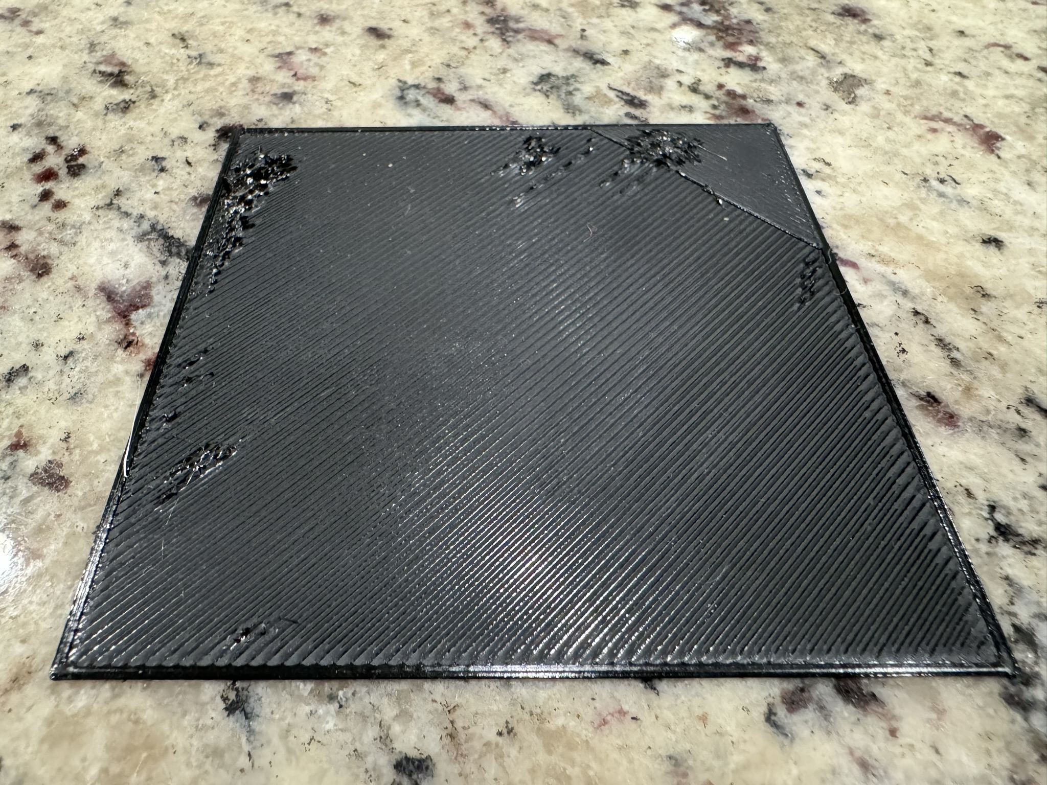

So I admit I was a little hasty with my last comment, my test print wasn't big enough to be a proper sample so here goes my attempt at -0.050, -0.100 and -0.150.
All tests with PETG and the textured sheet on the Prusa XL and a 0.6mm nozzle.
My test print includes a single layer 10x10 cm square and another two layer square, also 10x10 cm right next to it.
-0.050 mm, single layer: Lifting on sides very evident
-0.050 mm, two layers: Even worse lifting but especially on the second layer. Decided to stop the print once I saw how the second layer was going.
-0.100 mm, single layer: Much better but still have slight lifting.
-0.100 mm, two layers: Almost perfect but the lifting from the first layer is causing bulging on this second layer. I actually wonder if these bulges would have messed up a third layer passing over those spots?
-0.150 mm, single layer: Oddly shiny. Looks a bit thin but otherwise perfect. Tore a little bit along one of the filament paths while I was handling it.
-0.150 mm, two layers: Still shiny but otherwise really good.
Conclusion is that -0.150 mm might be perfectly acceptable, -0.125 mm might be the sweet spot? I'll keep testing.
Posted : 24/10/2023 5:05 am

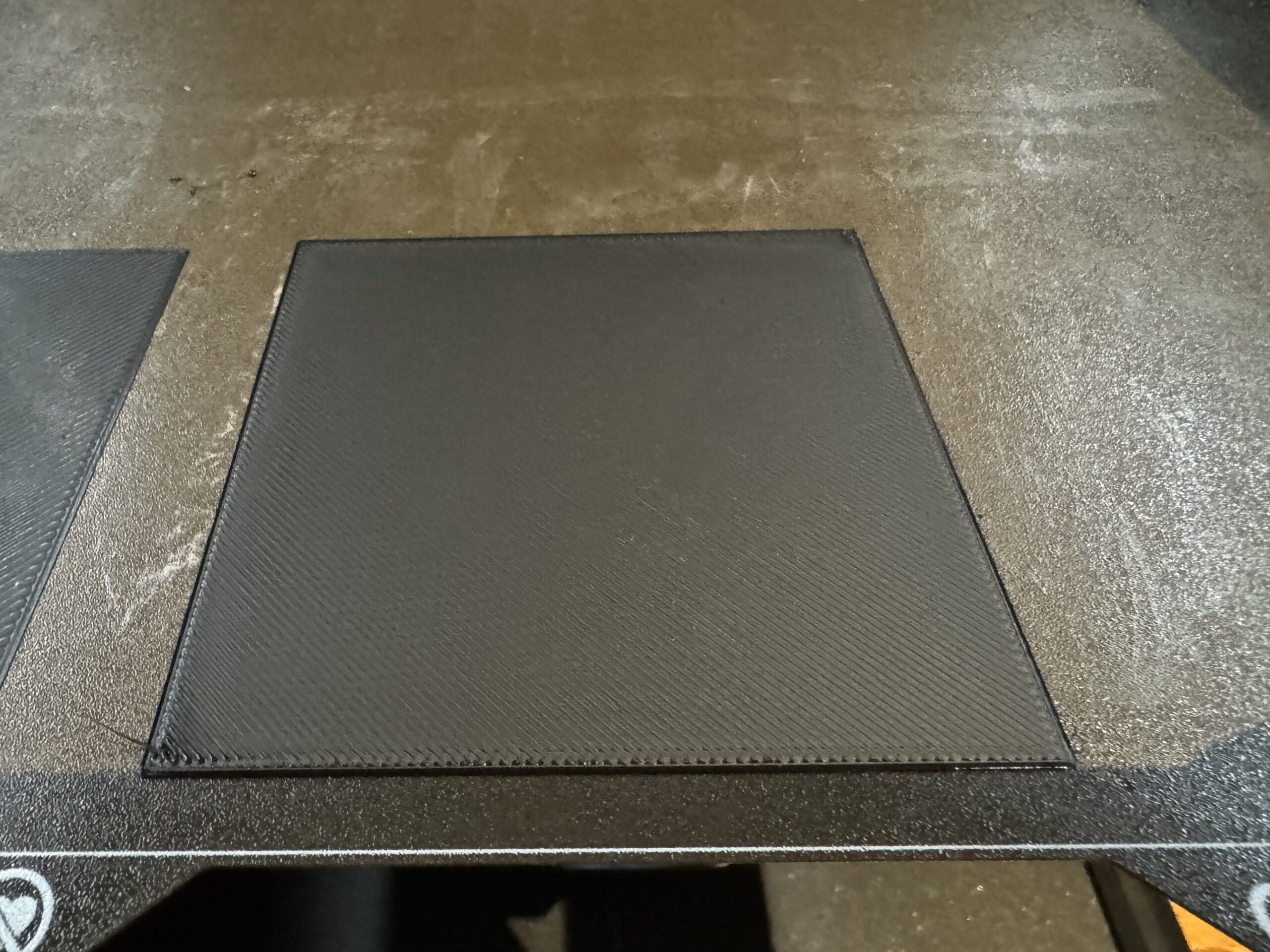

xilni
(@xilni)

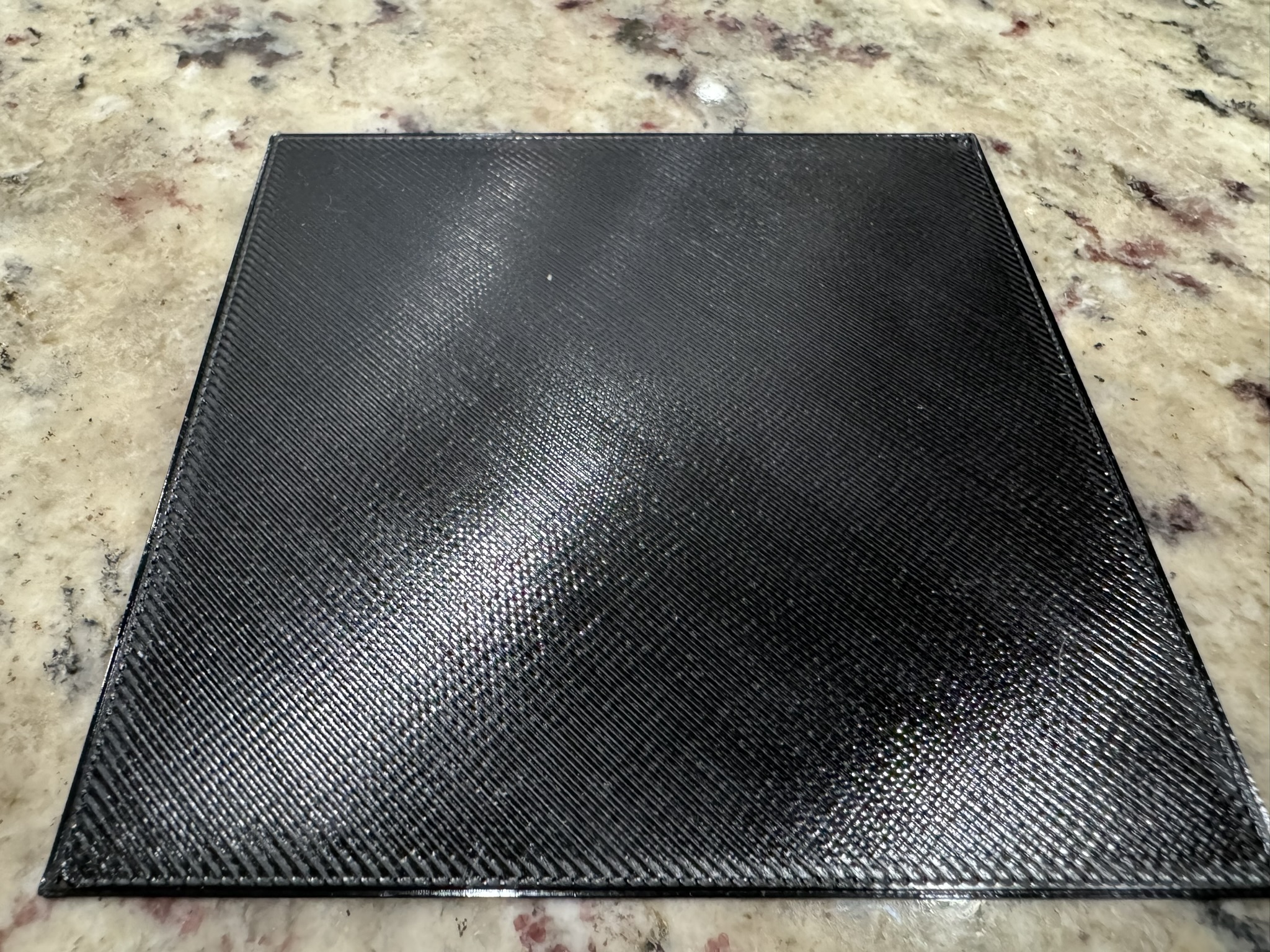

I'm happy I pushed past my initial laziness and opted to try -0.125 mm because oh wow does it work for my specific setup.
Here are the single and two layer test prints respectively.
Looks perfect. Not sure how or even if I should test the extrusion multiplier but I'm very happy with this already.
Posted : 24/10/2023 6:09 am

xilni
(@xilni)
It was number 4, either a dirty nozzle or I used the wrong file.
Attempt number 2 with a guaranteed clean nozzle and double checking the right file:
Posted : 24/10/2023 7:45 am
