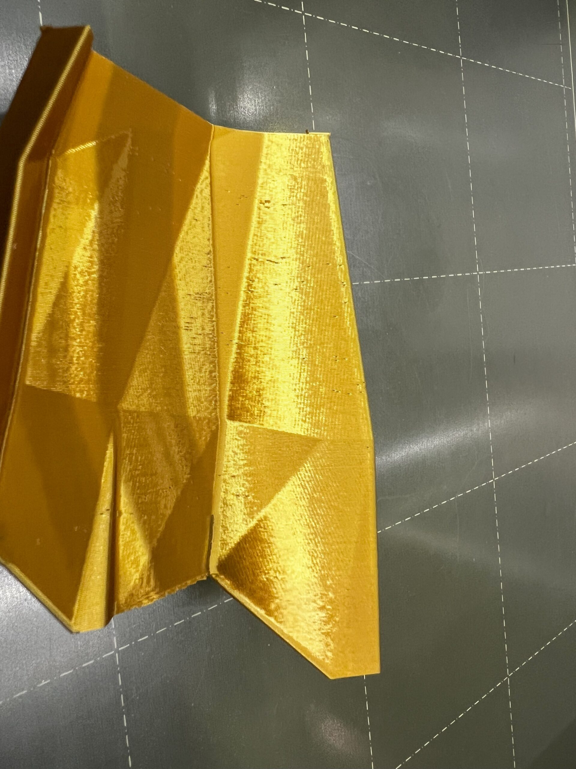

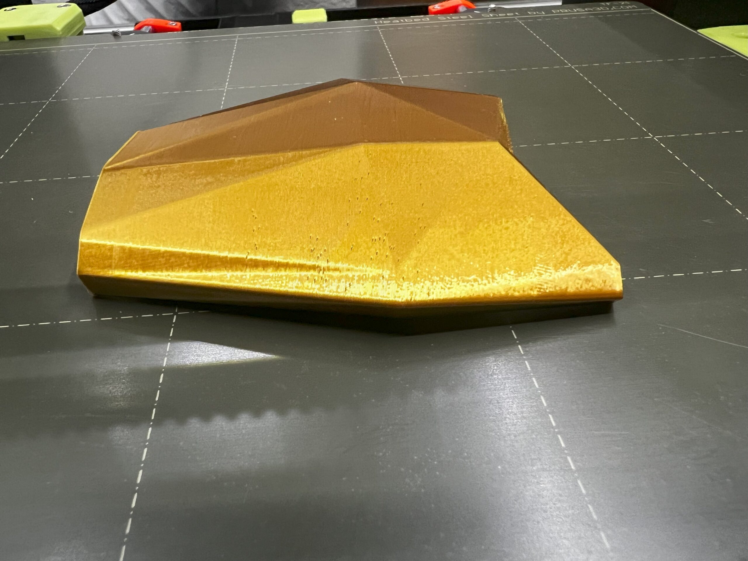

I am fed up with this issue, so I'm writing here. Anything printing at 20-55mm/s is showing excessive heavy VFA, worse than MK3S+. I cannot print at +55mm/s because it then shows a different artefact - uneven walls, orange peel. Every single printer has this orange peel on the walls at +40mm/s speeds. Yet I cannot avoid it by printing slower, because then I get VFA. On a "no VFA motors" printer, advertised in multiple places as such.
At first, as seen in a few posts of mine, I thought it's visible only on silk or under harsh light. I was WRONG. It's visible always. I just didn't print anything at the right angle, apparently. I did a few low poly prints recently and they all show VFA. This is ridiculous and NOT what was advertised.
This is what they advertise:
These are the prints I'm getting:

I've rebuilt it multiple times, swapped the Y belt, Y motor, Y bearings, Y pulley, new PETG parts, then new ASA parts, it's still consistently producing horrible VFA. No difference. Heavier than my MK3S+. Definitely heavier than what they advertise. They say "no VFA" and "eliminate VFA", yet the printer produces heavy VFA and the customer support themselves try to gaslight me saying these printers are actually not "no VFA" and they just say this to differentiate between MK3 and MK4. They literally confirmed in an email that they knowingly use misleading language and photos to market the printer as "no VFA" when it's actually having strong VFA by design.
"Oh, we say that but we actually mean something completely different and these promotional photos were taken in a very specific light, that's why you can barely see any artefacts on them. Why would you think those typical artefacts are gone on our printer when we literally use "no VFA" as a selling point? What gave you this idea?".
Also they constantly twist words, using "anti-VFA" (this phrasing doesn't exist in any marketing) to refer to the motors and using that as a leverage that "we didn't mean zero VFA, we meant a bit less" when the motors are clearly labeled "no VFA" and the marketing says they "eliminate VFA", not reduce. Also, my printer shows more VFA than MK3 so even this is a lie.
I am furious. This should be grounds for a lawsuit, this is false advertising. I want results from the photos Prusa itself shows as an ad for the printer and CS is telling me right in the face that this is not how the printer prints and that my prints are actually how it's supposed to look?! Then why are other people showing me their prints without VFA? What is going on here?

The VFA appear here:

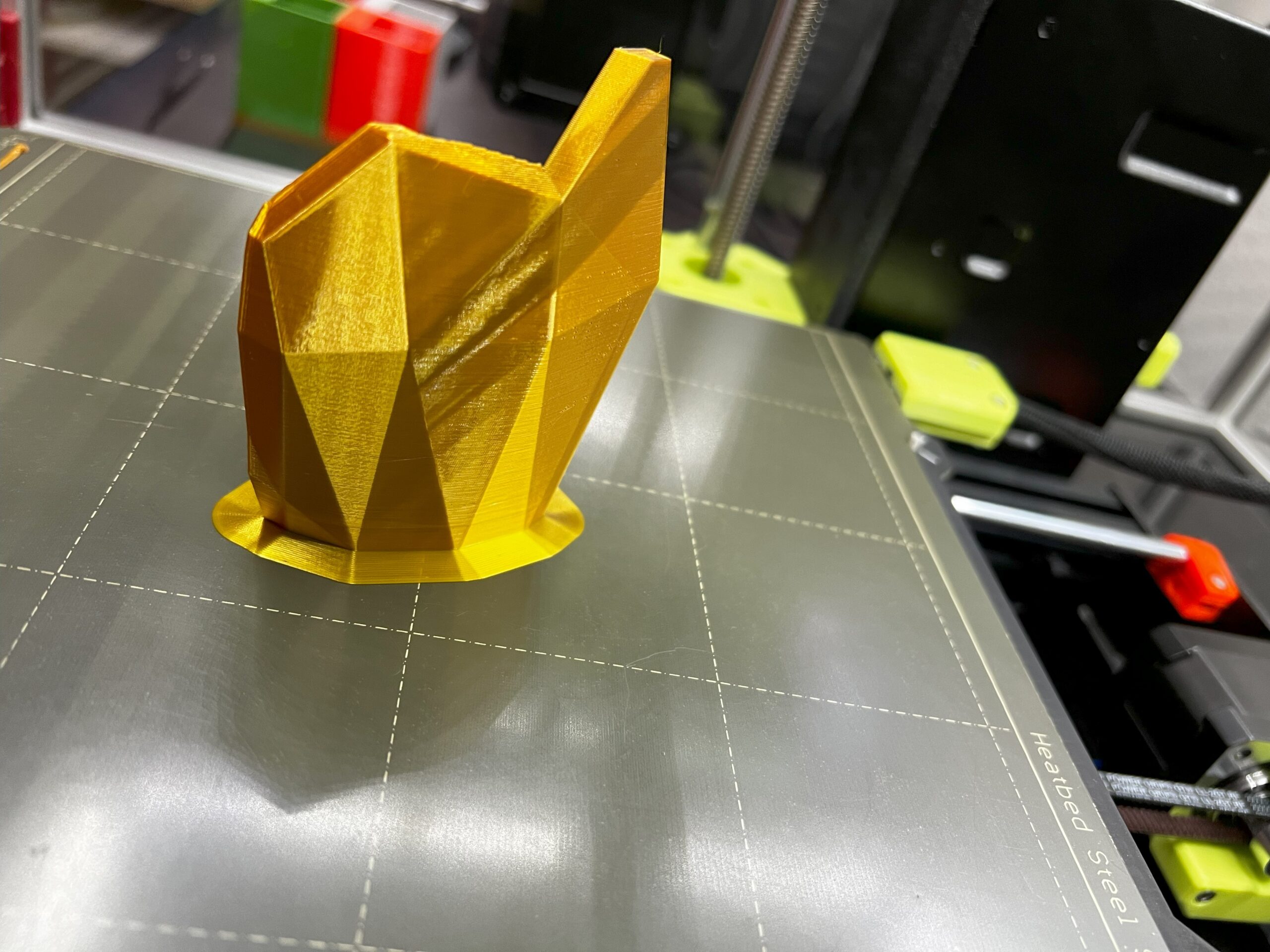

What I did? I had 2 Y motors on hand from a more recent batch, from a different resolved warranty claim. The first motor I had from the kit was super VFA prone - it's the one from those previously posted photos. I've tried one of those newer motors - very similar VFA, hard to tell the difference. I've tried the last one - and this one reduced VFA a fair amount. Next I've shimmed the motor mount to make the motor shaft even with the frame (the thermal pad twists this assembly), this is to make the belt centered on the pulley. And lastly, I've slightly overtightened my Y belt to around 102. To be clear - those belt changes did NOTHING to improve the previous motor's VFA. They did do something only with this one less VFA prone motor.
Just to mention, while I managed to reduce it to a state where I'm happy, I did spend the last few days looking at prices of the Trident LDO kit in various shops... I was very close to selling this printer and moving on. So yeah...
Here's how my print looks like now:

I spoke too soon. The issue is still there, with the new Y motor even worse than before. It just happens at a different angle now so I missed it on my test print.
Tldr, this went back to CS, but as a motor issue and to a different person. The VFA changing strength and placement with a Y motor change makes me think two things:
1. If changing the Y motor is the only thing that affected VFA - it is the source of the issue. I will pursue this.
2. All my Y motors are having more resistance when spinning the shaft manually with the motor unplugged than the X motors. They are also vibrating more. The original one was worse in this regard than both of my X motors and produced VFA. The newer Y motors are the worst, they feel like an entirely different motor. They're also identical to each other, which means it's kind of unlikely to be a single dud. They will verify this and I might send the motors back for inspection. Depends on their decision.
The fight continues.

I've put one of my X motors in place of Y (so now the printer has two X motors) and routed the cable weirdly just to reach the plug. Both of my X motors are pretty smooth, way better than any of the Y motors.
This is one of my test prints, printed with the first Y motor (the one from the kit), the print changes speed each 1cm to show how it affects VFA:
And this is the print I did today with two X motors. Results speak for themselves:
