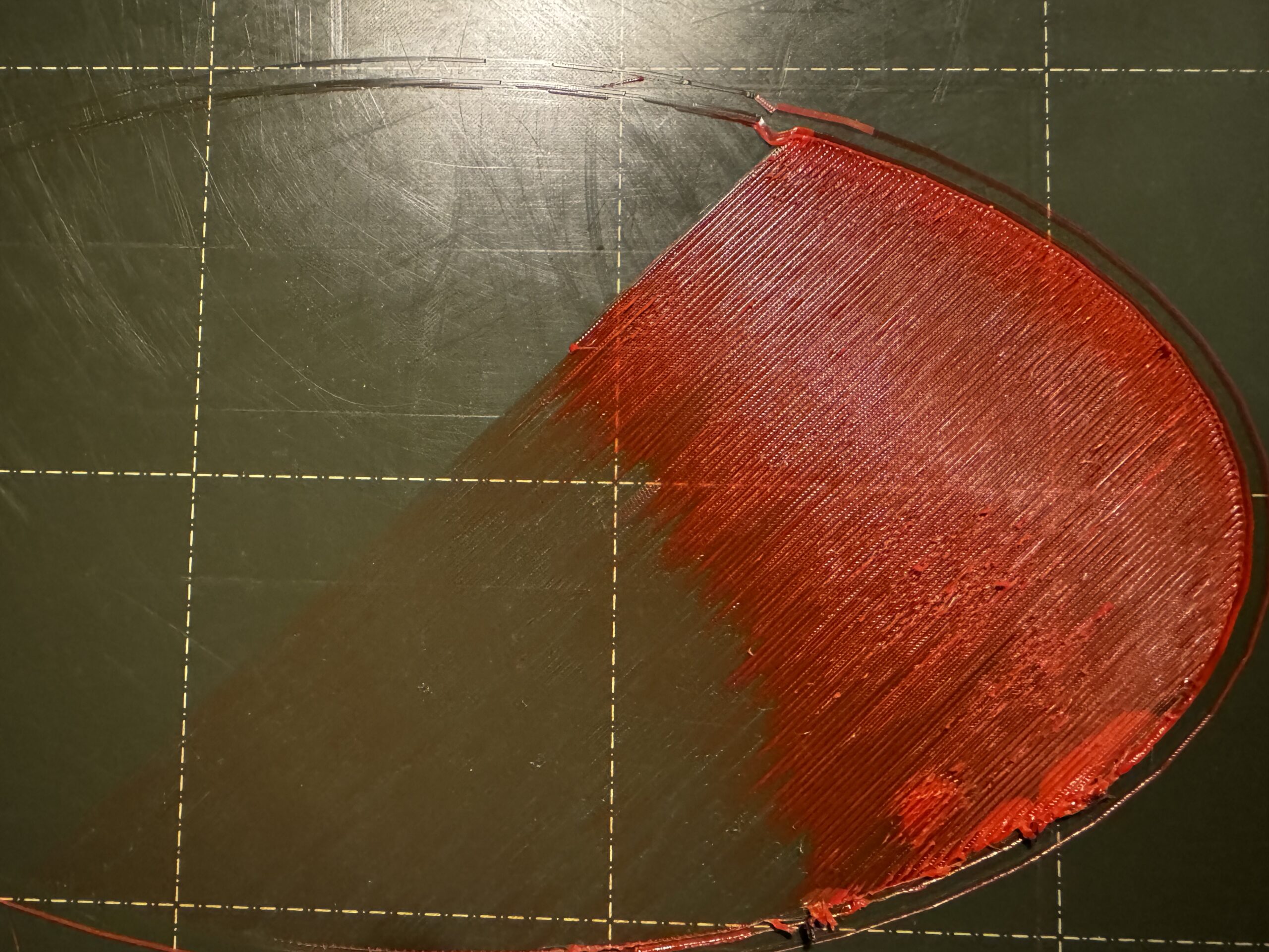

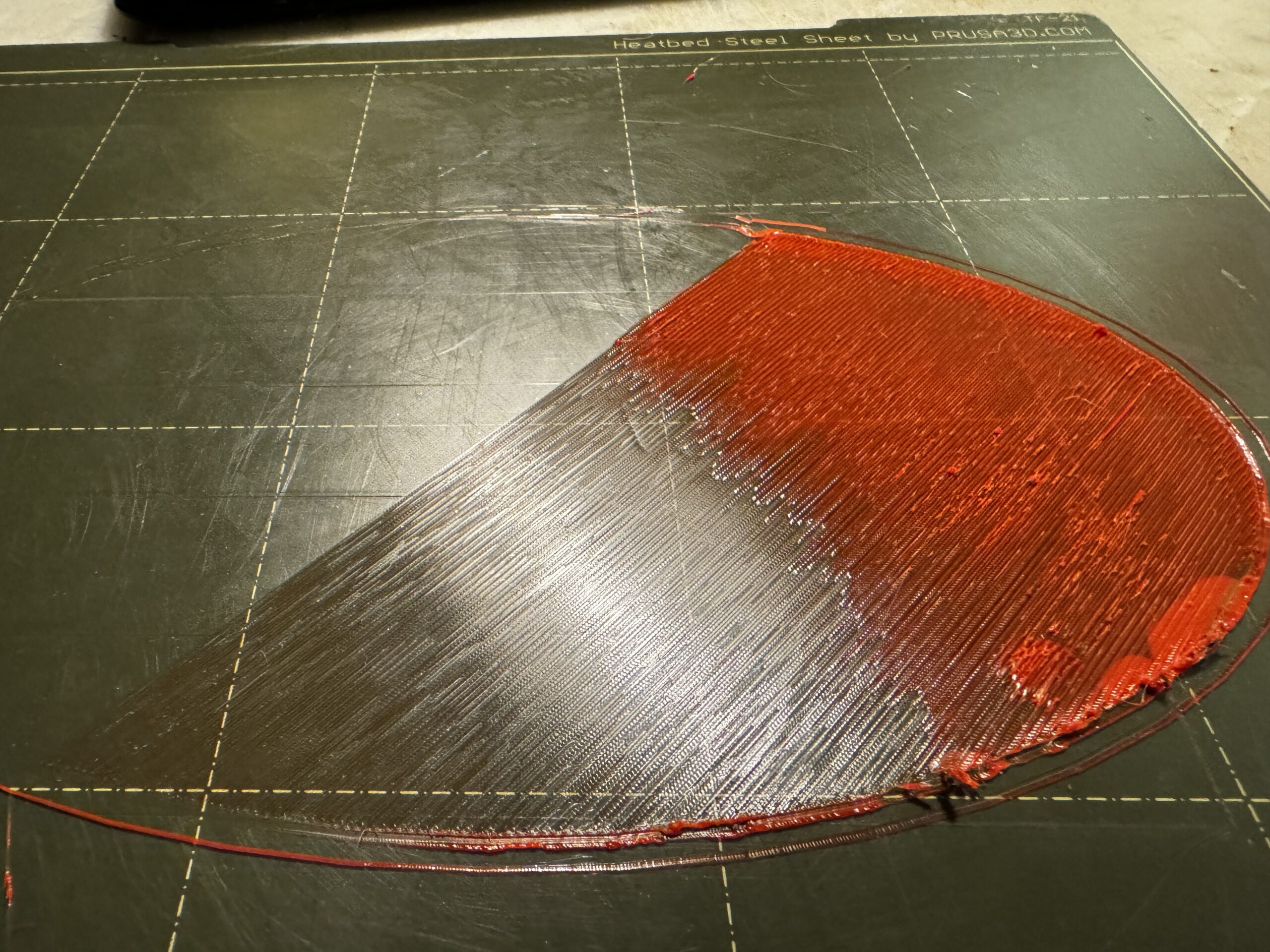

It seems that the x rods are not horizontal any more, after carrying my Prusa MK3s + by the upper beam for repairs (I’m not sure that this is the cause). How to solve it?
RE: Z problem after hot end repair
send the extruder to the top of the frame so that it stalls both sides against the z axis end pieces
It seems that the x rods are not horizontal any more, after carrying my Prusa MK3s + by the upper beam for repairs (I’m not sure that this is the cause). How to solve it? utumishi updates
Lifting by the upper beam might have misaligned the X rods. Check if the bearings are seated correctly and the rods are parallel. Loosen and re-tighten the X-axis motor and idler mounts. Recalibrate to ensure proper alignment.
