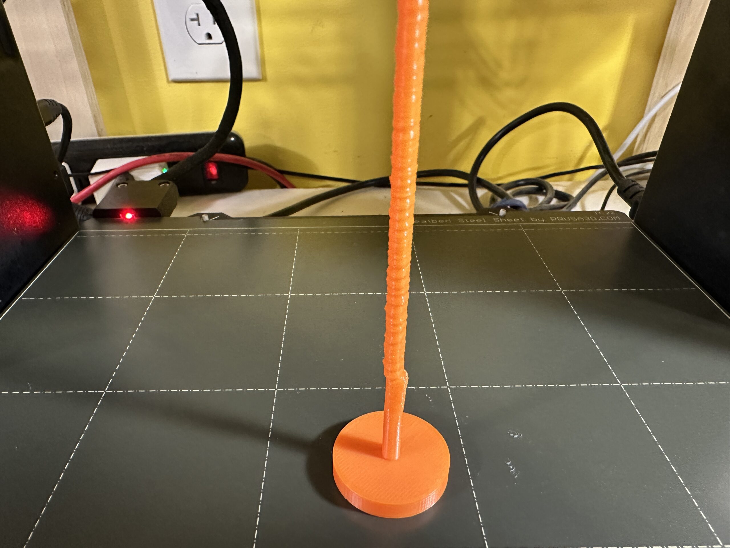

I had this happen twice, once when I printed a tall cylinder, approximately 130 mm tall by a bit more than 4mm in diameter. It has a base about 28mm in diameter and 5 mm thick. It prints properly, then reaches a point where, for the rest of the height, it has "wobbles" in it and it looks more like a threaded screw than a straight cylinder.

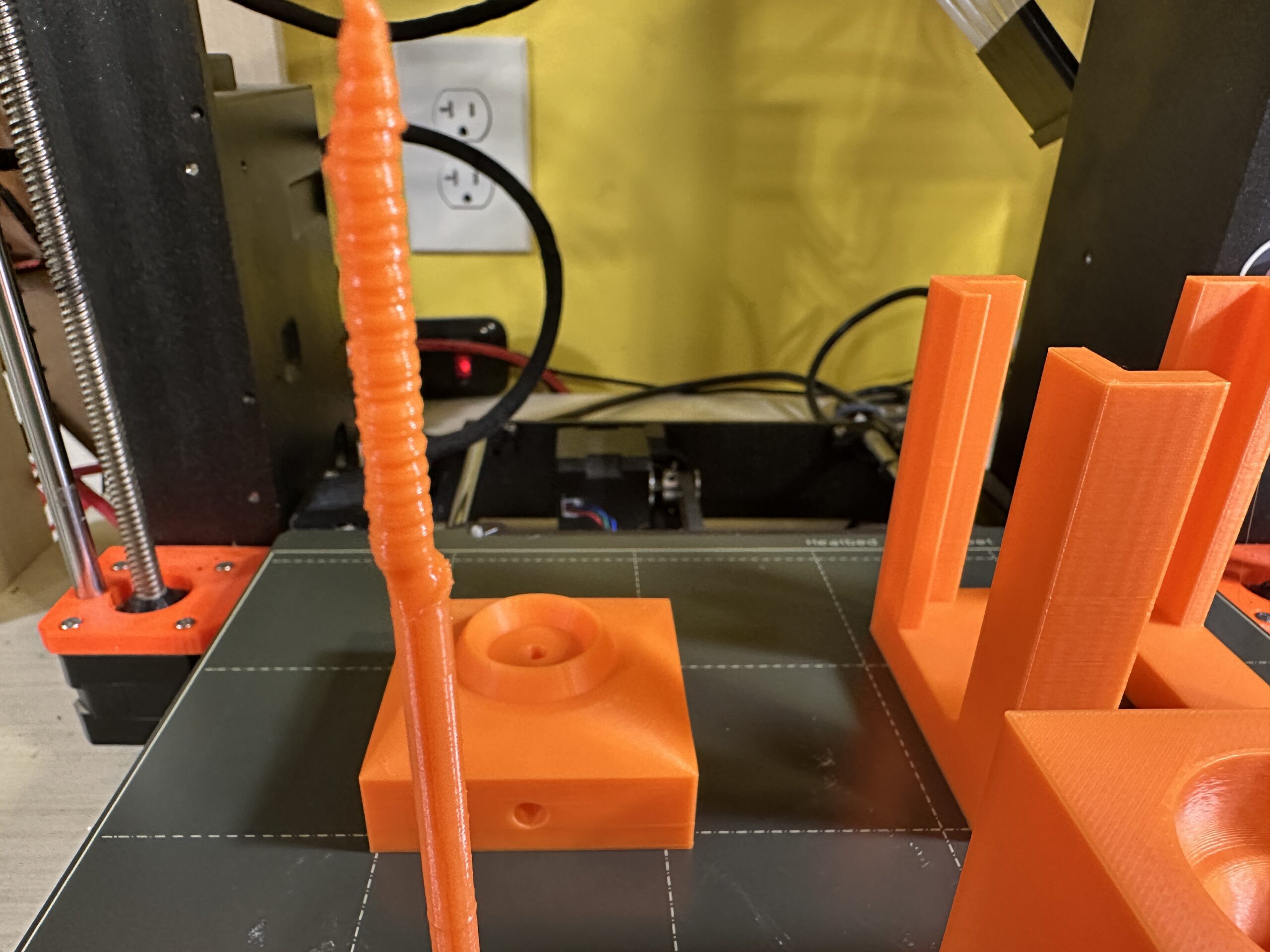

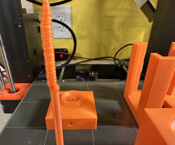

This is the first time I tried printing it, with other objects being done in the same print. Note that when it goes bad, it shifts to the left, then gets weird. It appeared to me that the break where it gets bad is a bit above the tallest other object being printed.

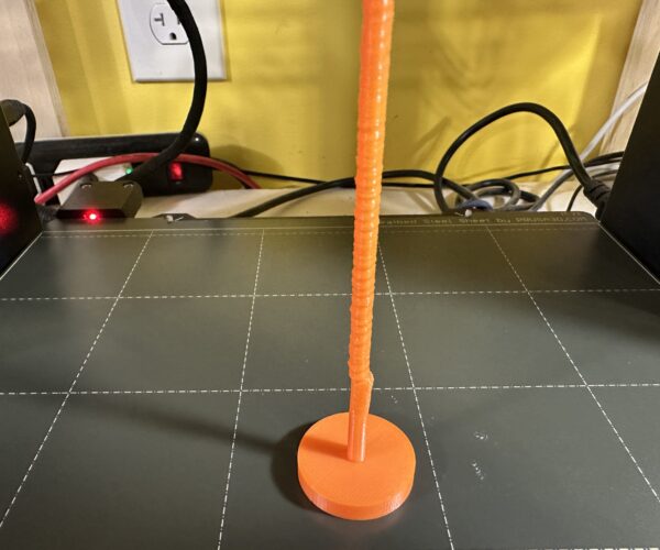

And here is where I tried to reprint it by itself. It went bad rather quickly and it also shifted to the left here:
I was not in the room for the first print and was busy during the 2nd one, so I didn't get to see just what was happening as it went bad. I also realized I have my timelapse set for layers, so it's not going to be helpful for this. Also, I did check to make sure the bed and print head could move easily along each axis. It's not long at all, in print hours, since I lubed it all.

The layers are so small that there is not enough time for them to cool and firm-up before the next layer is added. That's why the print is good while there are other parts being printed and taking time.
Set a minimum return time in: Filaments > Cooling > Cooling thresholds > Slow down if layer print time is below:
The best value will depend on the filament in use; experiment, 15 seconds is often enough.

Tango its purely cooling. The previous layer doesnt have time to cool before it deposits the next. Thats why when you print it with other objects it only 'goes bad' when its above the level they stop at.
Doing as FoxRun says and printing several in one go all at the same height will give it time to cool between layers. Also will work better if you space them out a bit on the build plate. You could also slow travel speeds down to give more time.
The filament cooling settings also have a 'slow down if layer time is below' setting. That can be adjusted in these cases but multiples at one usually works better.

I'm curious - I get why this issue wouldn't appear until above the height of the tallest of the other objects I'm printing, but why didn't this start even lower, like 1-3 layers above the disk handle for this when I printed it alone? I'm asking because I'll be doing similar parts for other molds in the future and often it'll help to be able to test the sizing with a mated part the rod would go through. Knowing that I can print a short test version of this, with the rod only, say, 10-15 mm high would save time in the future.
RE: Straight, tall, thin cylinder has "wobbles" in it when printed
That’s a reasonable question, I don’t have a definitive answer but if I had to speculate I’d say that when it’s lower the air the fan is pushing through to cool the layers is being deflected back upwards from the bed giving you increased cooling. When it’s gets up higher that effect stops and you get the hotter layers.
It does appear to get progressively worse until it gets to a certain point and then it’s just consistently bad.

I had to do more test printing on this and that included a frame for the mold I'm making and reprinting the rod. Since the rod was taller than everything else, I printed 2 rods. That worked fine - they both printed okay. Since OctoPrint reported a 34 second time per layer for just one rod, I figured an extra one would give it enough time to cool down. The only glitch was when it got to the top and the rod was tapered to a point, since the cross section got smaller and smaller and the delays weren't long enough.
