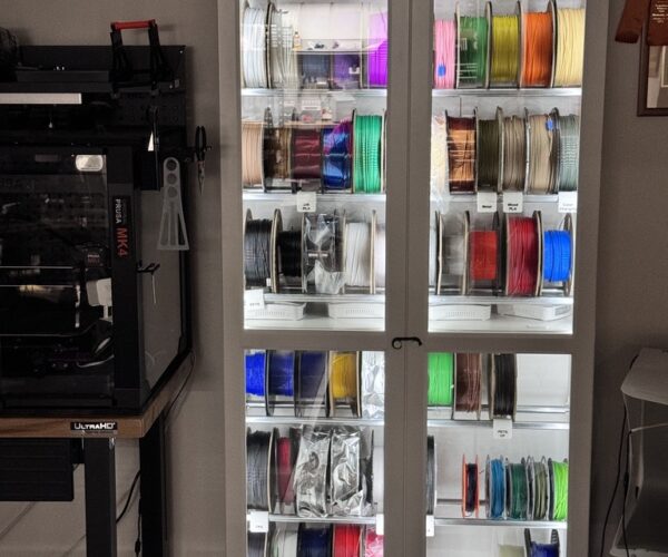

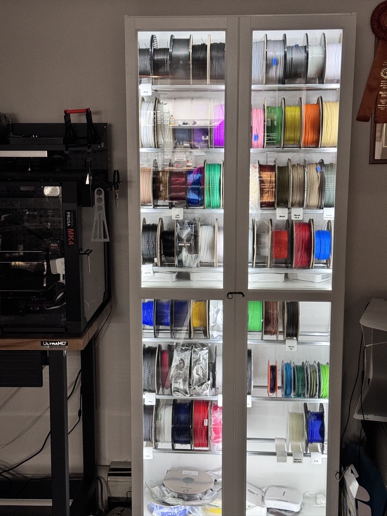

RE: What kind of vacuum bags do you use for filament storage?
This was inspired by a post I saw a while ago somewhere on Reddit (and which of course I can't find anymore). I've been using it now for 6 months, and it worked out better than I expected.
The base is an IKEA Billy cabinet (31 1/2" x 11 3/4" x 79 1/2") with Oxberg doors.
I added Hrumque's mounting system https://www.printables.com/model/476631 , which gives me 7 rows of 10 to 11 spools.
I used weather stripping https://www.amazon.com/dp/B077LJT1F8 along the sides of the cabinet to try to keep humidity out. I designed and printed a small clip to go over the door handles to keep the door tight.
I had six mini dehumidifiers https://a.co/d/8bknDIq left over from my previous plastic storage totes, so I use those to suck up moisture (I actually found they need to be recharged much less frequently than with the totes).
For looks, I added LED strips around the glass panel on the inside of the door and power them with a smart plug.
Posted : 14/05/2024 11:14 am
This might be a good idea - with a major variation - for me. I just recently put in a vent system because I'm having problems with my CNC - whenever I use the laser, it sets off the smoke alarm. My workshop is on the 2nd floor in our barn, which has a barn roof, so there's a crawl space/attic area to the side of my shop, where I put the vent fans. While in there working, I realized that I could easily fit in a few storage cabinets within the crawl space. (I'd have to get insulation to put around the sides.) So I could do something like this in the new wall cabinets I'm considering. I'm still working out how it'd work out. I like glass doors so you don't have to open doors until you know where the filament you want is, but I have peg boards on the walls and those are a major part of my tool storage/tool management system, so space taken up by a glass door is not useable for pegboard. (Maybe a 2 layer door - swing out the peg board and there's glass behind it?)
Posted : 14/05/2024 3:04 pm
