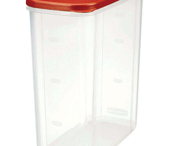

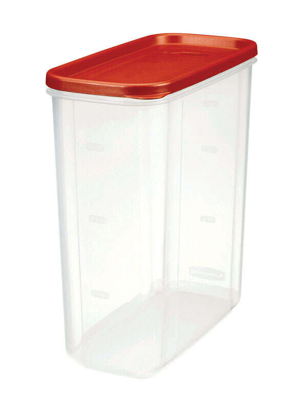

6192892
https://www.acehardware.com/departments/home-and-decor/kitchen-utensils-and-gadgets/food-storage/6192892
Rubbermaid 21 cups Clear/Red Food Storage Container 1 pk Item #6192892| Mfr #1776473
Reusable for all of eternity.  Toss in a few desiccant packs, also reusable, and call it a day.  Works great.
Don’t trust forum advice.
Posted : 21/08/2022 8:11 pm
Eric E
(@eric-e)
RE: Vacuum sealing your unused filament
Use this and be happy
Posted : 21/08/2022 8:53 pm
gkas
 gkas
(@gkas)
Posted by: @eric-e
6192892
Drawing a vacuum on that would totally crush it. I use a chamber vac, and have crushed coffee cans (opened) and large, heavy spice containers.
