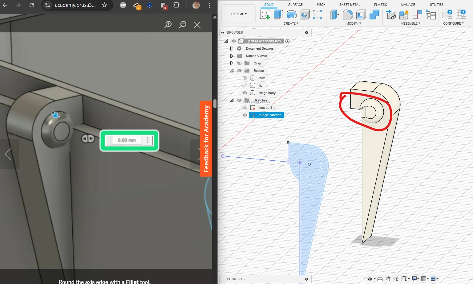

I am attempting to follow the first project in the course - "Small box with hinged lid" (paywalled, I pressume) - but am entirely unable to re-create Step 3, and wondering if I am missing something obvious or if there is an error in the course?
Here's my Fusion project, if it helps.

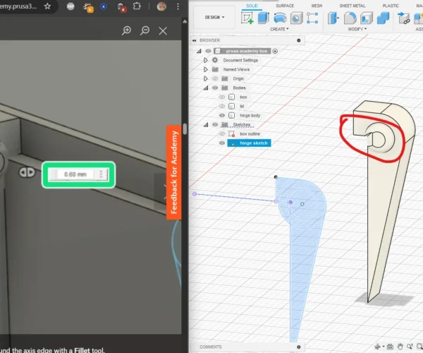

So, in step 3 we extrude the hinge (center circle) from the sketch onto the hinge body, letting it protrude 0.6mm, and round off the edges using the fillet tool. Notice how my hinge nubb ends up with a gap?

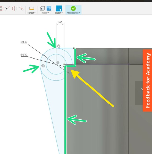

This gap occurs because the box body intersects the hinge. However, this is according to design (yellow arrow is mine):
In fact, the guide clearly shows that the circle is supposed to be extruded with this notch (yellow arrows mine):
... I followed the course step by step, using the same dimensions. How come their hinge nub ends up nicely rounded but mine looks like ass? 😀
What am I missing?
Best Answer by ulfben:
I think I solved it. The crucial step is ensuring the box is not visible before performing the extrusion. This is mentioned in the instruction so I'm not sure how I missed it / fucked it up. 😛
With the box hidden the pin is extruded without merging to the box, and the fillet then works as expected.
The pin is very much supposed to intersect the body of the box, as the next step is using that intersected area to cut out clearance for the upper hinge counterpart.
