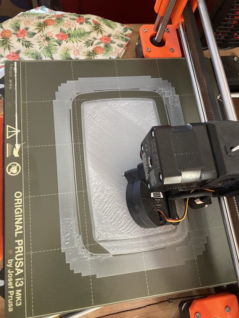

Strange first layer
Print bed
Could anybody help me explain what happens here and how to remedy this?
Thanks

RE: Strange first layer
You're too close to the build plate, re-adjust your live Z.
Posted : 19/12/2020 8:43 am
muddymaker
(@muddymaker)
Try reducing the numerical value on your machine by 0.100 and do another test print. For example, if your current live z is 0.650, then you need to adjust that number by lowering it to 0.550 by turning the dial on your machine clockwise. Once you are spot on, you'll see a consistent first layer that has no wave effect and all stuck together nicely.
Just remember turning the dial Anticlockwise lowers your x axis closer to the build plate and clockwise the opposite.
Good luck
