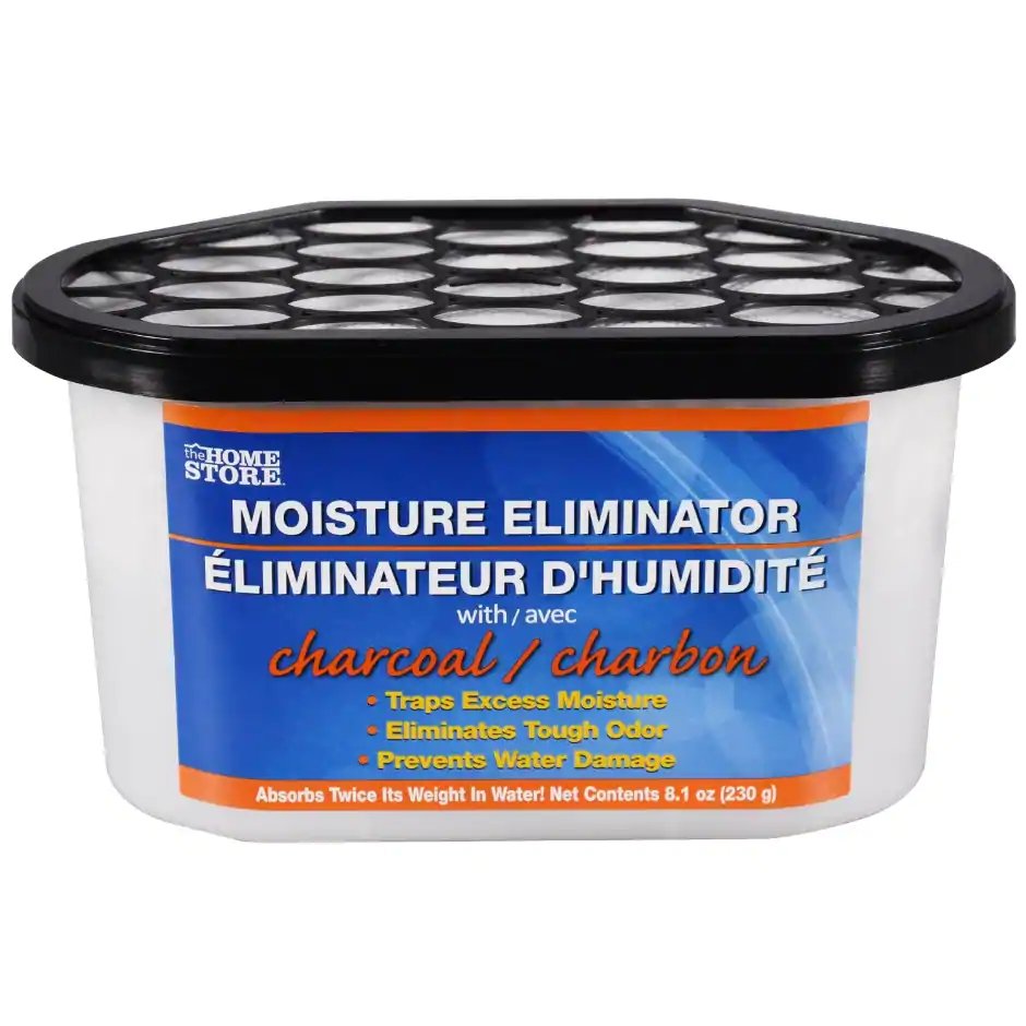

While shopping at a local Dollar store.
Seeing the Moisture Eliminators, 8.1 oz. Containers and it reminded me that my filament is worth more.
Picking up a couple more containers of the Home Store Moisture Eliminator as seen in the image below.
This inexpensive wonderful product has keep my Filament safe and moisture free for nearly 4 years now.
Started with re-using the little desiccant packages first, then seen these 8oz containers that work much better.
Just wanted so tell every one how I have 4 year old filament that still prints like brand new Filament.
I keep my filament stored in a large storage container with a single Moisture Eliminator to keep my filament dry..

Thinking about it see no reason why you cannot use a couple Moisture Eliminators in a cabinet to keep filament dry.
