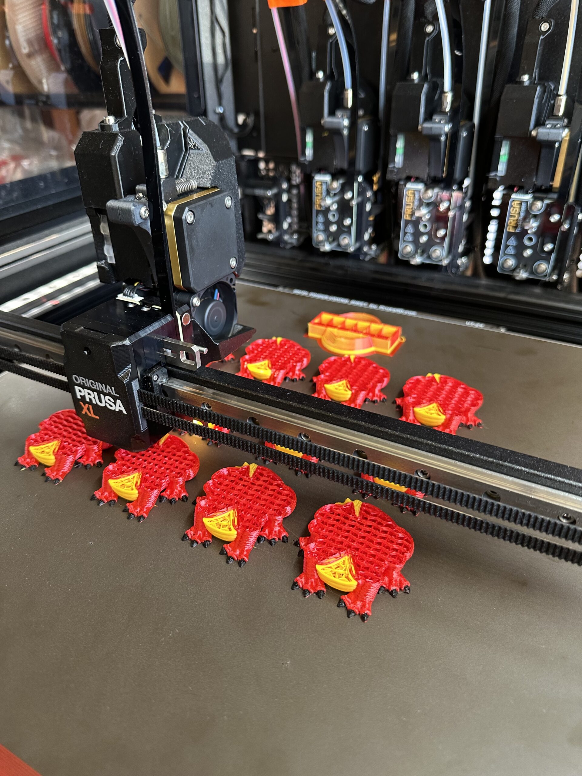

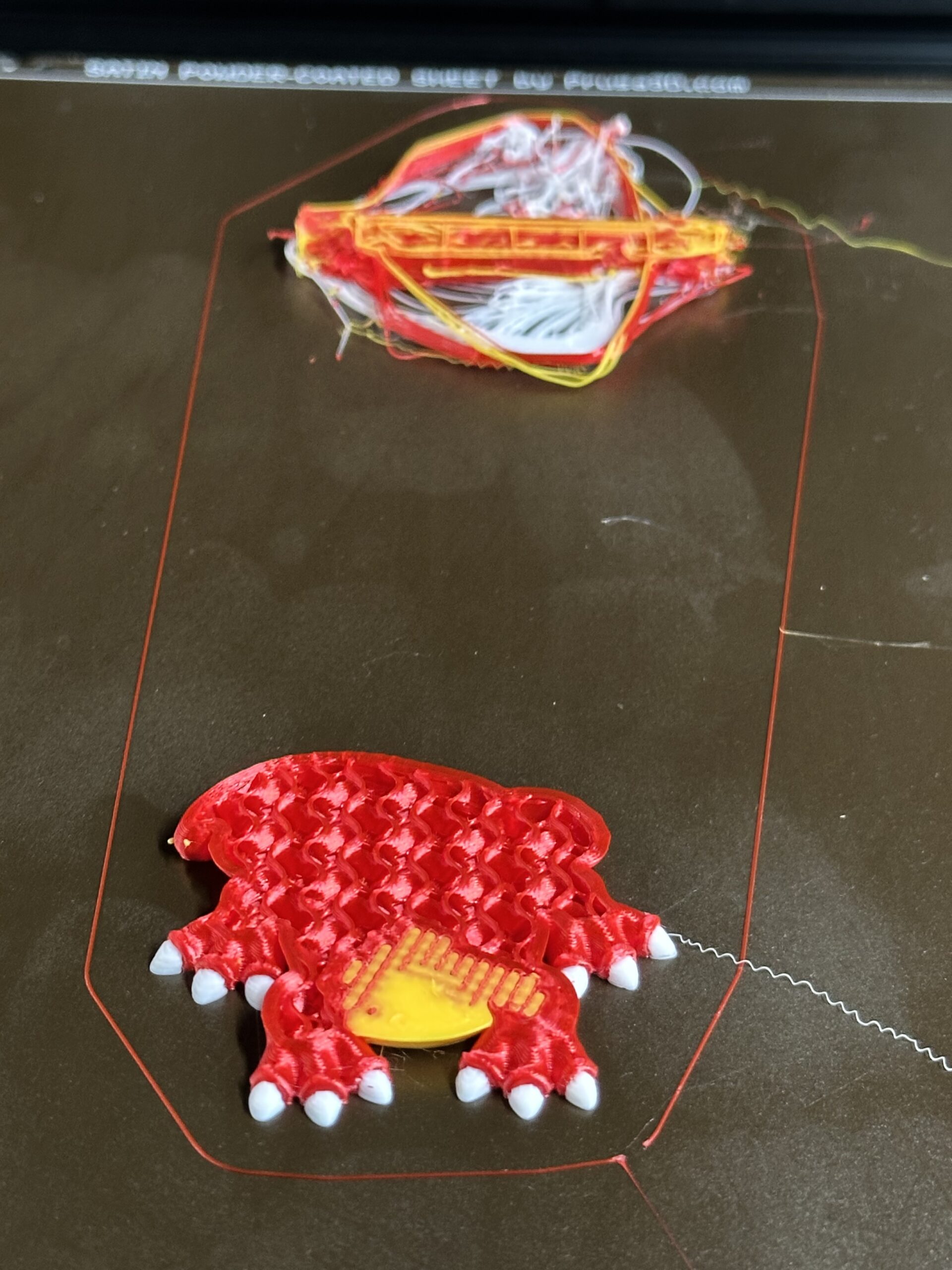

I and others (reports seen on FB Prusa XL user groups) seem to be having an issue with the latest version printing wipe towers. The failed wipe tower (5 times tried) was sliced with PrusaSlicer 2.9.4 - Mac version. The successful printing one sliced with Orca Slicer for Mac. I have not sliced with the Windows version of PrusaSlicer, but will after the completion of this print.

Not sure it's a firmware issue. I've been printing multi-color stuff on my XL for the last couple of weeks non-stop, no issues with the wipe tower.  Sliced with PS 2.9.4 on Mac.
