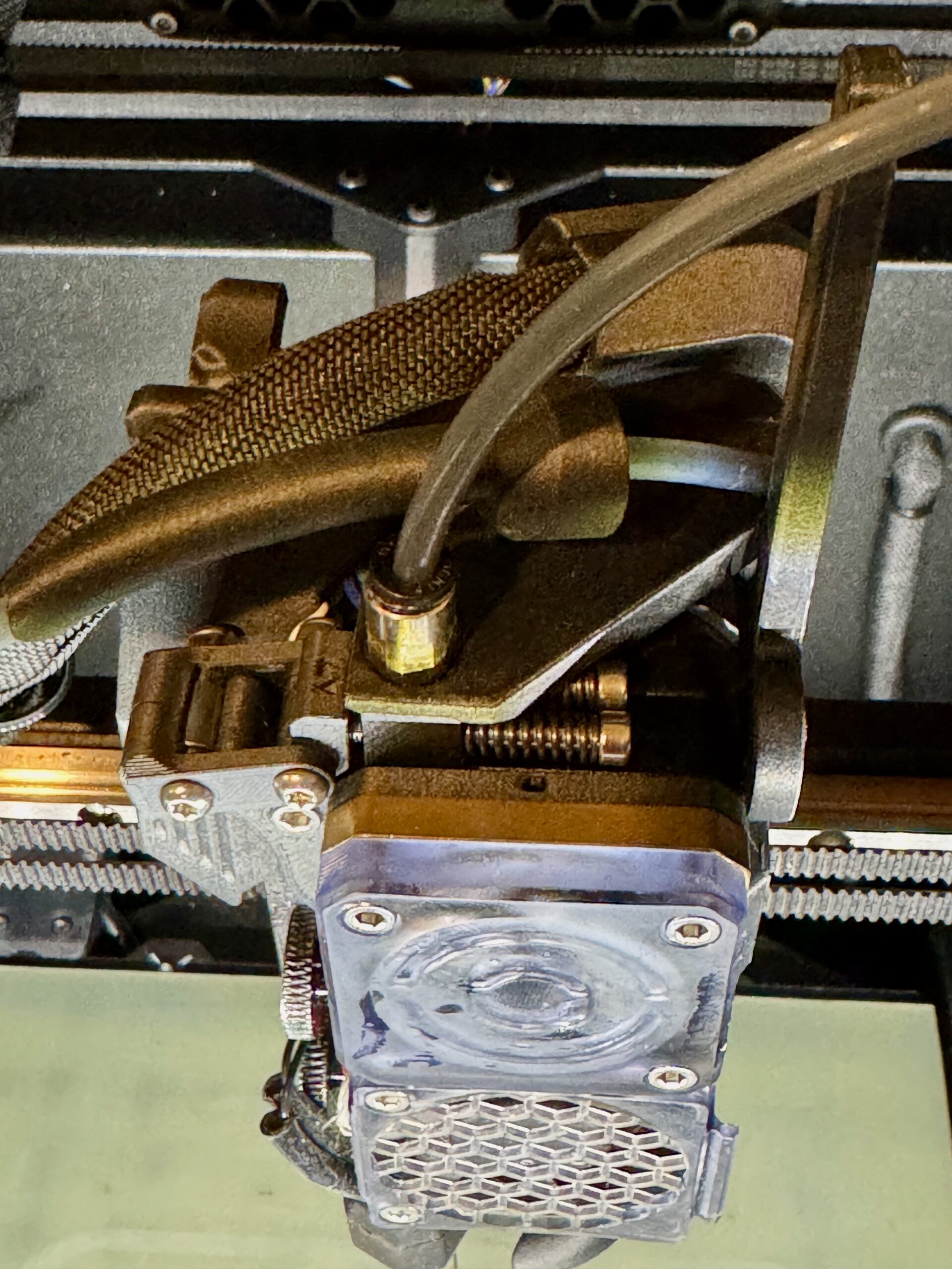

Of all the filaments I own, this one seems to be the most challenging... not to print, but to load. It's extremely stiff and brittle and I ended it snapping it several times trying to get it past the Bowden bend and into the Nextruder. Once I got it past the filament sensor I could not get it past the extruder gear into the nozzle. This is because I'm using a bogie mod that is optimized for flex materials. So I finally managed to get it to feed in by snaking a separate Bowden tube from my dry box going underneath the top (see pic below). There is a one pulley Bogie mod on Printables made for specifically for this and ASA/ABS-CF but turns out I didn't need it.

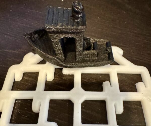

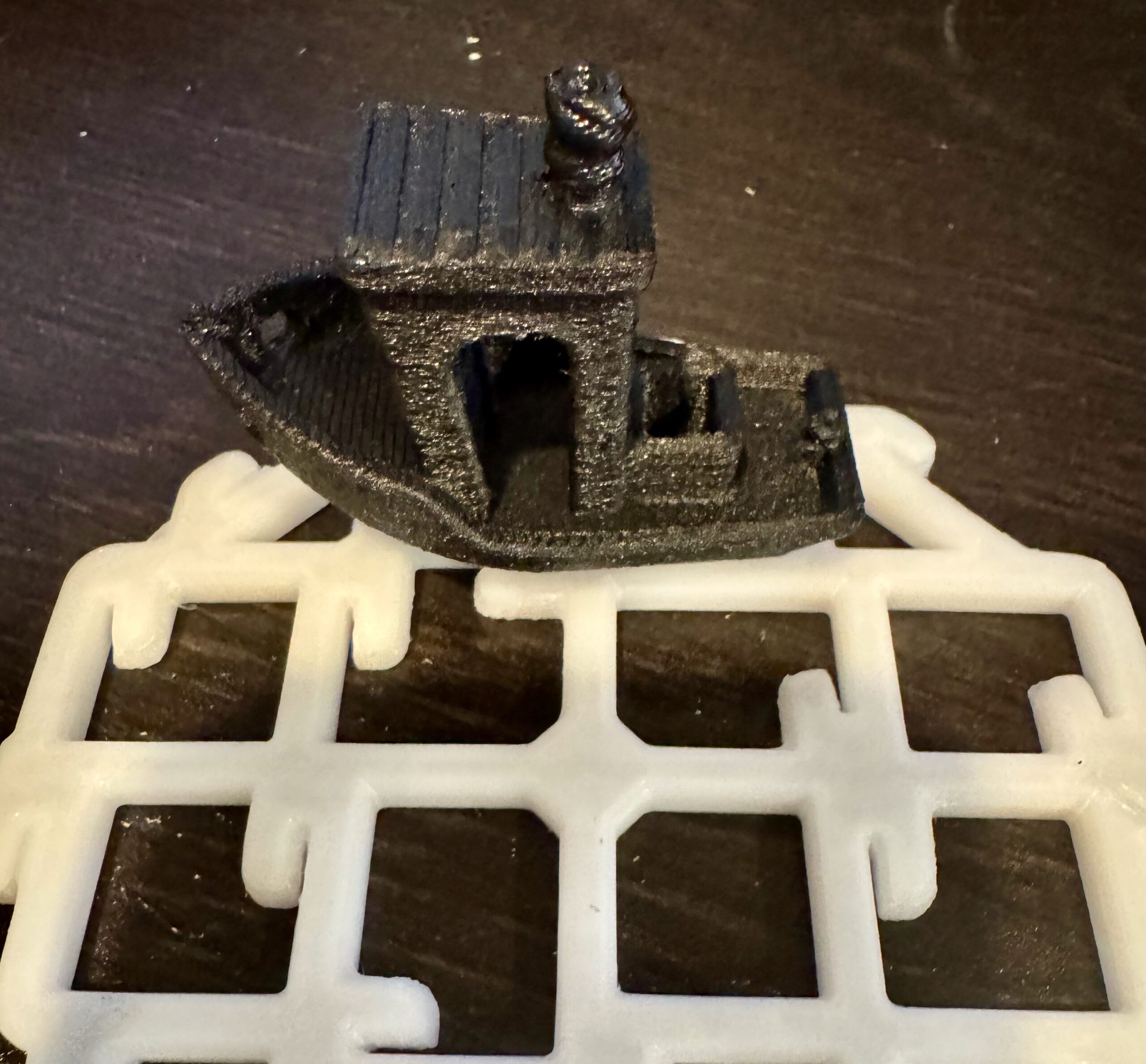

Forgot to mention, I dried the filament for 12hrs at 85C. I printed from from a drybox at < 10% RH but then after 8 hrs I had to pop it back into the dryer.
I printed an obligatory Benchy. It's not the best benchy in that it was after 8 hrs of testing and the filament had to go back in the dryer before I printed it. Also 290° is probably too low for this filament but that's as high as the C1 can reach.
For fun, it's sitting on top of a Califlower printing in POM (acetal Delrin) which is by far the most difficult filament I've ever printed. I'll do a separate write-up on that one.
