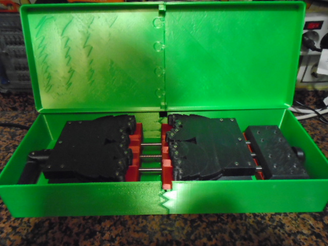

Attached for interest is a photo of my the Fractral vice (vise) ex Printables download, using carbon impregnated PLA. I personally rate this material for
extra strength and print consistency.
The vice (vise) works well, and it even lifts the adjustable wrench (spanner).  Well done the original 3D designer using the early steel vice principles and adapting for 3D printing.
Warning, there are many pieces to print in this project, and even by filling the printer bed to capacity it took many hours to accomplish making the parts.
I used an 8 mm x 1 mm metal screw rod and nut with internal bearings/ sliders, all  as per the original Printables instructions.
Also built a purpose size box and lid see attached photo , but needed to print in 4 pieces (2 parts for the lid, 2 parts for the box) due to the lack of  printer bed capacity, and by applying the trusted wood male/female tenon and the jig saw principles to join the parts together.
Hope of interest.
