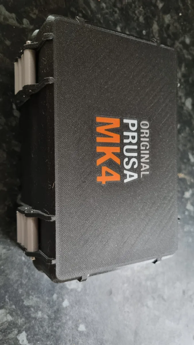

This is a print I made (not my design), two layers of colour.

Posted by: @jp-guitars
https://media.printables.com/media/comment_images/76/98998e-aeac-45b2-8fdb-fb61481a6364/thumbs/inside/1600x1200/jpg/20231203_114443.webp
Just 2 layers? Great! Answers my concerns completely!
