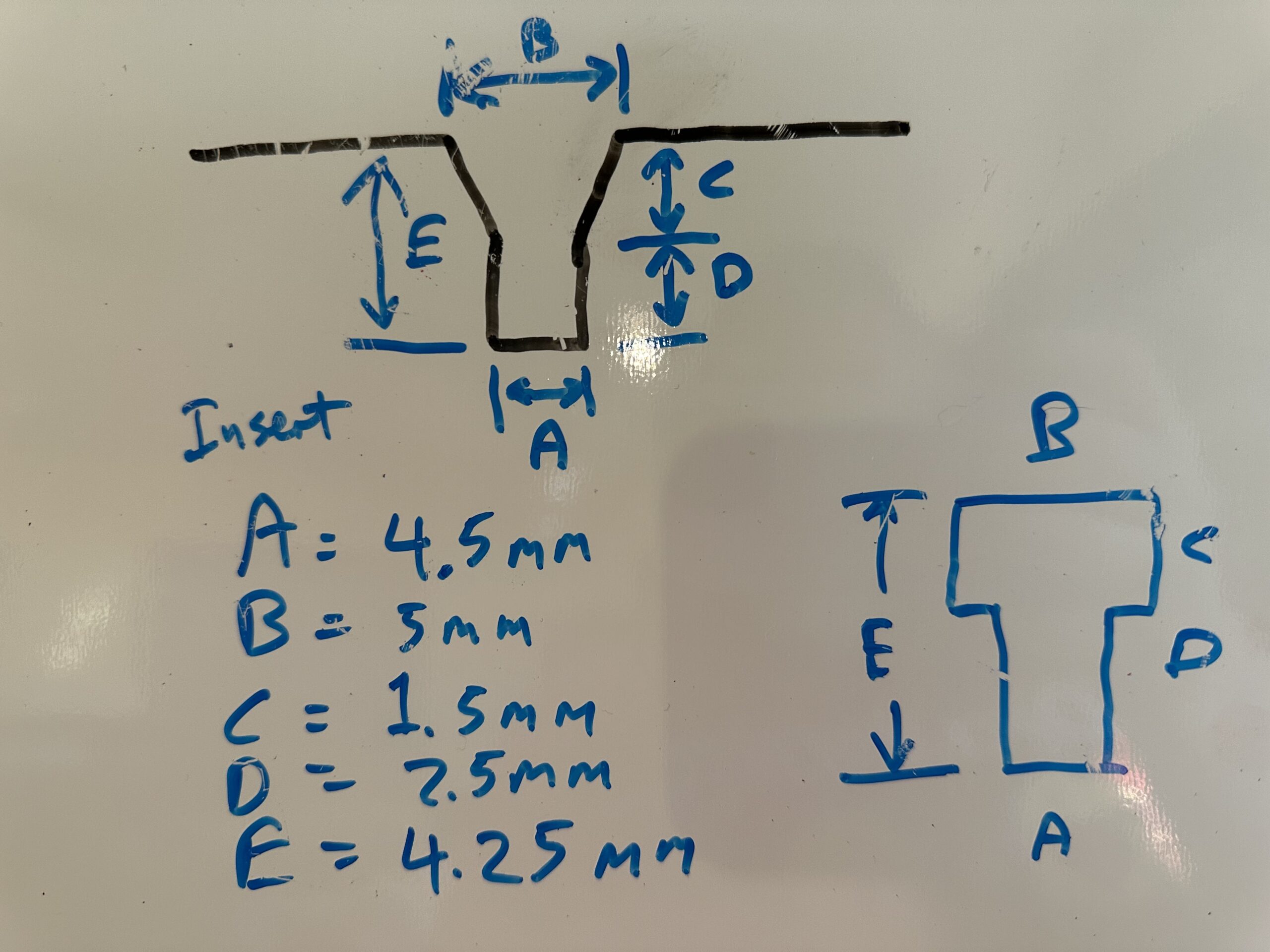

Makign holes for M4 Heat Set Inserts
I need to put in some heat set inserts for a project (which will be duplicated several times). I just want to make sure I'm using a good size in my modelling for the inserts. As best I can tell, it looks like M4 inserts are standardized, not just on the inside for diameter and threading, but on the outside, too. First, I've noticed some people seem to be putting inserts into one side of a piece and the screw goes into the same end. This seems to me to be a weaker way to do this and I would think this way, in the sketch below, is a better way: Have the screw go in from the OPPOSITE side of where the insert goes. Am I right about this and, if not, are there any issues to watch out for if I do it this way?
Second, I'm wondering about the size of the insert and the hole I make for it:
This is a rough sketch and I really should have marked the hole sizes with a prime on them to avoid confusing each one with the measurement of the insert itself. I also realize my sizes for the hole may be off. (The sketch on the side is for my reference and comparison, so you can ignore that.)
I haven't been able to find any page that says, "This is the size you need for a hole for an M4 heat insert." So are my measurements for the hole on target or close? Or what measurements should I be using for the hole for an insert?
Posted : 19/12/2023 10:14 pm

Part of the heat set inserts has no texture on it, ideally the hole for the insert should be the right size for that part so you can fit it in the correct position then heat it.

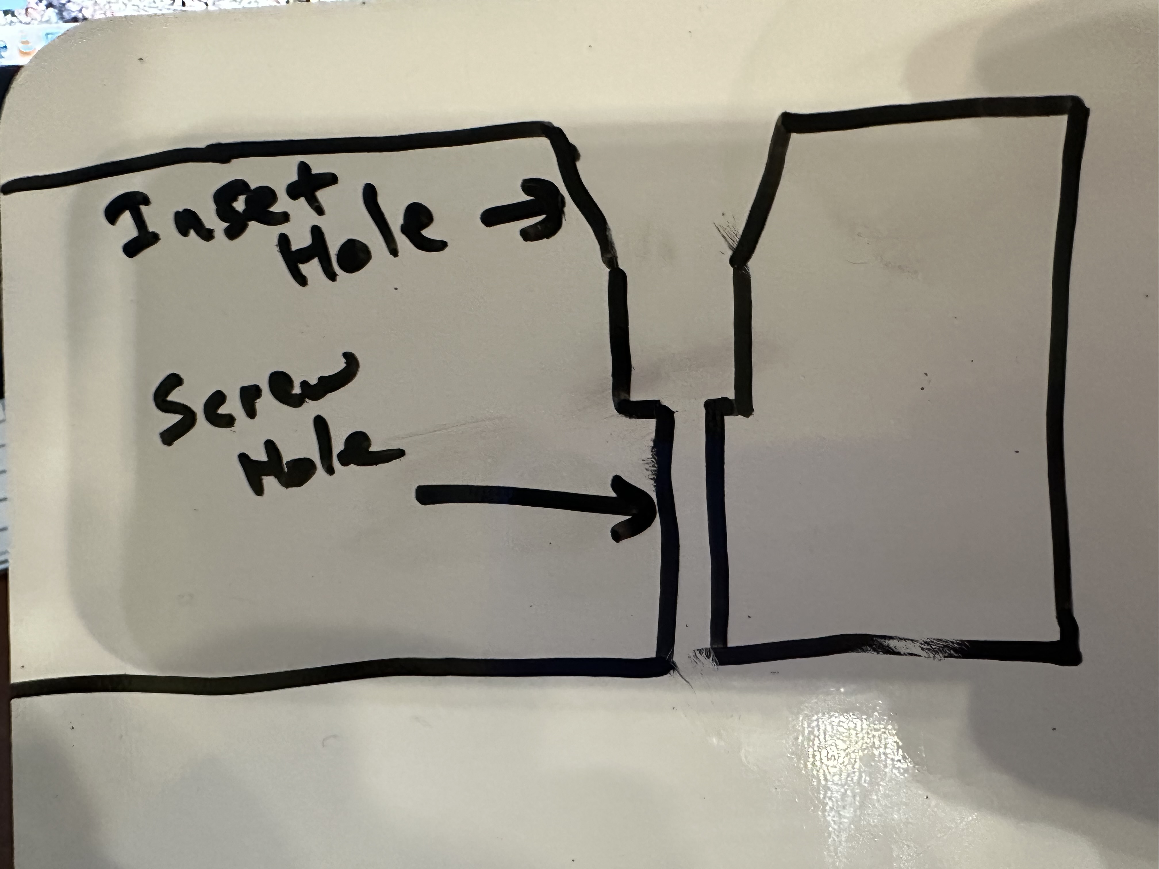

Regarding what side, it should not make much difference. If you need the full thickness of the holding object you will have either gone under sized, used too few or have insufficient perimeters, as they should not be taking huge loads. And if you put it in from the back there is a chance molten plastic could block the thread, although that has not happened to me.

I have sometimes done as you suggest, put the insert in from the opposite side to maximize resistance to pull-out, when the part geometry has allowed (or required) it.  For a given thread size, you can find inserts with multiple outside diameters (and of course lengths), so you need to design for what you intend to use.  One of the popular insert assortments on Amazon uses smaller than typical OD, and since I have those inserts that's what I normally size holes for.  On models I have posted to Printables, I usually include a link to the inserts intended, and/or advice to drill the holes out slightly for use of bigger inserts.  As long as enough perimeters and top/bottom layers are used, it shouldn't pose a problem and it's generally easier to drill out a hole that's slightly too small, than order the larger OD inserts and wait.
IMO you are overthinking your hole geometry. Just shoot for a cylinder the OD of the pilot portion of the insert, a little deeper than the depth of the insert, with a slight chamfer on the outside rim.  Done.  If the screw length will protrude past the threaded insert, make the hole deeper as needed.
So there is no standard size, then. M4 tells me about the inner diameter and the thread size and space, but does NOT tell me about the size of the insert, so the insert exterior dimensions are not standardized. Am I right about that?
I'm not sure what you mean by "pilot portion."
This is the kind of thing I'm finding confusing. It sounds like you're saying to use the same diameter for my hole the OD of the insert. Is that correct? But everything I find gives vague information, like "a little deeper than." What is "a little deeper" in terms of numbers I can use in my modelling program?
You say I'm overthinking, but I'm just trying to get an idea of what size hole to make in the model I create to use this. I get, now that there is no standard size, but I have no clue how big to make the hole compared to the size of the insert. For instance, should I be trying to make the hole the same diameter as the insert? From what you say, I think that's the case.

No there is no standard on the inserts.  I've not used M4 heat set inserts but I've used loads of different M3 ones.  Every manufacturer will have their own profile (cross section), usually multiple different ones for different tasks.  For M3 I have had outside diameters ranging from 4mm to 5.6mm.
Quality ones from a good manufacturer will also have data available on the profile required for the holes too and not just dimensional specs of the insert.  That greatly aids in design as it takes guesswork and trial and error out of it.  Even with such data its best practice to print a small test part as our printers and filament do vary in tolerance so we might need to tweak the manufacturers ideal for our process, especially as they spec for injection moulded parts.
Many of the insert profiles start with a small straight shoulder section to aid insertion and then swell out to the grooved diameter.  Some then also have a small lip.  Cheaper ones sourced from the usual places are often just cylindrical with grooves starting immediately (often with a small band around the middle).
So I took Netpackrat's comment on just make the diameter of the hole to be the same as the start shoulder for simplicity.  Do not do the hole the same diameter as the insert.  There will be little to no interlock.  After all the idea is to melt the plastic out from the hole walls so it flows into the grooves to give a good mechanical join.
That's also where the 'little extra' at the bottom comes into play.  There are no firm rules, as you insert it the plastic will have a tendency to be pushed ahead of the insert and so not flow into the grooves but end up below the insert.  That's a problem more seen on the cheap ones as the grooves start immediately.  Some makes it upwards into the grooves, but not all.  Of course that also depends on how tight a tolerance the hole has.  The tighter the hole the more likely it wont make it past the leading edge and back up the hole.  Insertion technique and speed also plays a role there too.  Insert slowly and more plastic can make it into the grooves, insert fast and you will get more below the insert.  It is all based of the physics of plastic flow, just like our extruders.  So temperature, plastic type, insert geometry etc all interact.

That's why doing it through hole with the screw pulling the insert into the part is not usually done.  Its easy to get a build up of plastic that blocks your holes.  Too much and the plastic also backs up into the threads making the insert useless. The plastic has to go somewhere.  If you are doing that then why even both with an insert ?  Just model a hexagonal hole for a normal nut, or a square one for a square nut and press fit in.
The most recent part I designed using the insert installed from the side opposite the screw, there was not sufficient distance between the hole and the edge of the part to allow for a normal nut.  The part could not be made any larger because the whole assembly had to fit inside a cavity also of fixed size, and the hole location was likewise set by the purchased component that mounted there.  It's possible that a square nut could have worked, but I didn't have any M5 square nuts, and I did have M5 inserts.  Also, since I went to the trouble of making an insert press, I want to use it.  🤣
How did you make sure the screw hole was kept clear of plastic when you put the insert in?
With the part I described, I had a little trouble with this.  Fortunately the plastic didn't get into the threads, but there was some build up at the bottom of the insert which would have prevented insertion of the screw.  I carefully used a drill bit to clean the plastic out of the hole so the screw could thread into the insert.  One thing I could have done different would be to use a shorter insert, since a shallower insertion depth would have meant less plastic built up ahead of the insert.  But I was trying to maximize thread engagement, so I went with the longer inserts.
