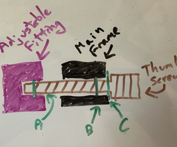

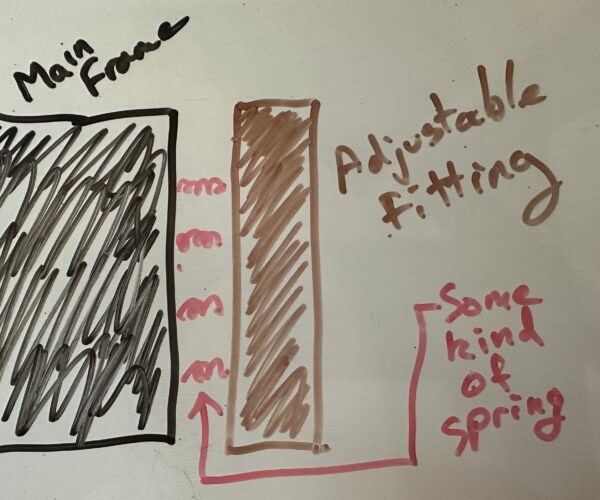

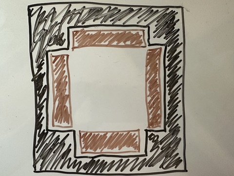

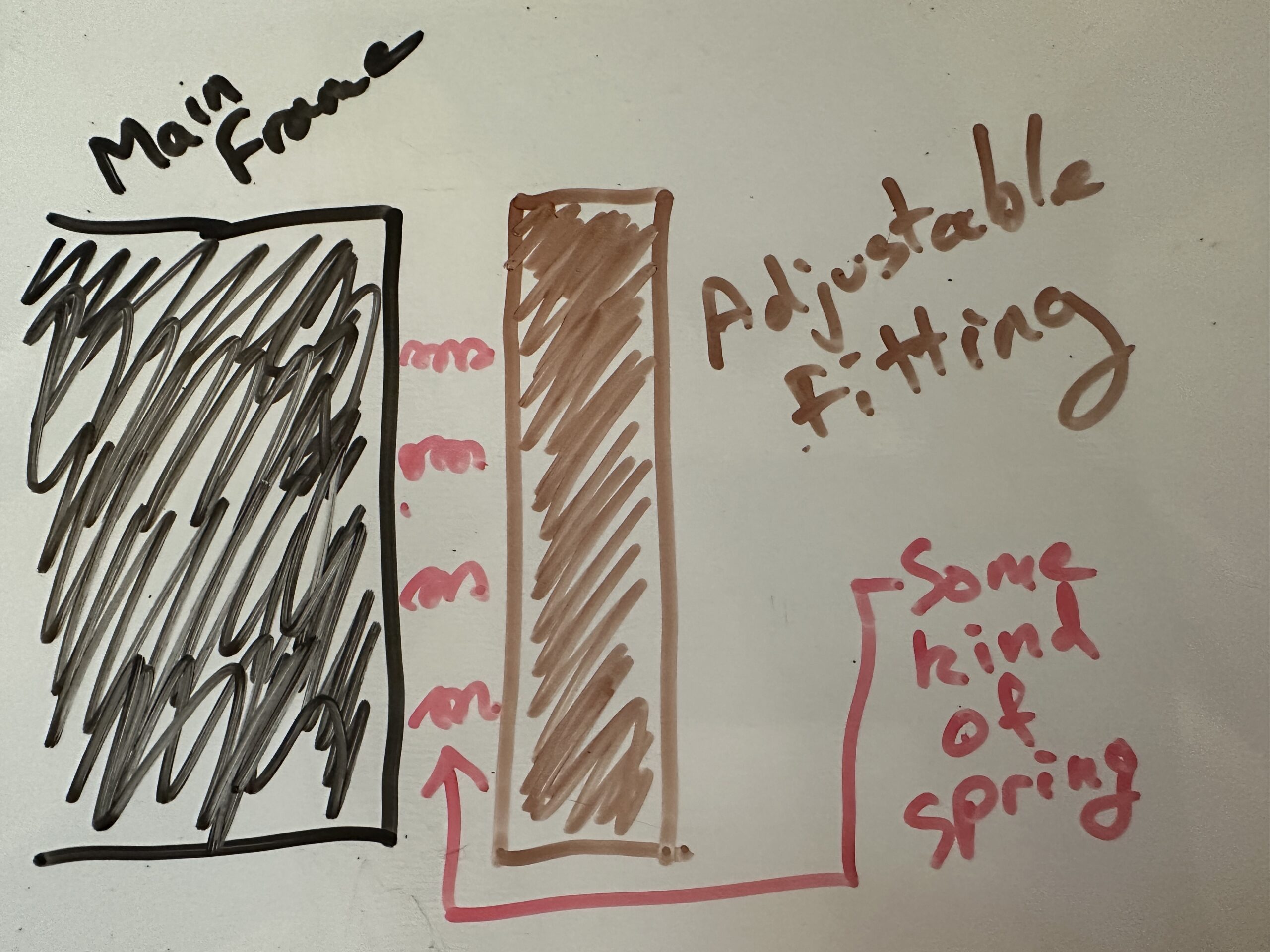

I have a square frame and will be fitting flat items in it. The frame is in black, the adjustable fittings are brown:
There would be 4 adjustable sides on the inside of the frame. I need one adjustable fitting on each side because the part that goes in the middle needs to be able to be kept in the center. I want to find some way to use some kind of spring action or adjustable like this:
I've thought of using springs, but I need strong springs, since there will be moderate force applied to the tile held in the center of the frame. (Moderate as by hand while working on items held in place in the center - not force like a hammer or mechanical.) I'm also not sure, if I add holes to fit springs into, how to keep the springs from easily popping out.

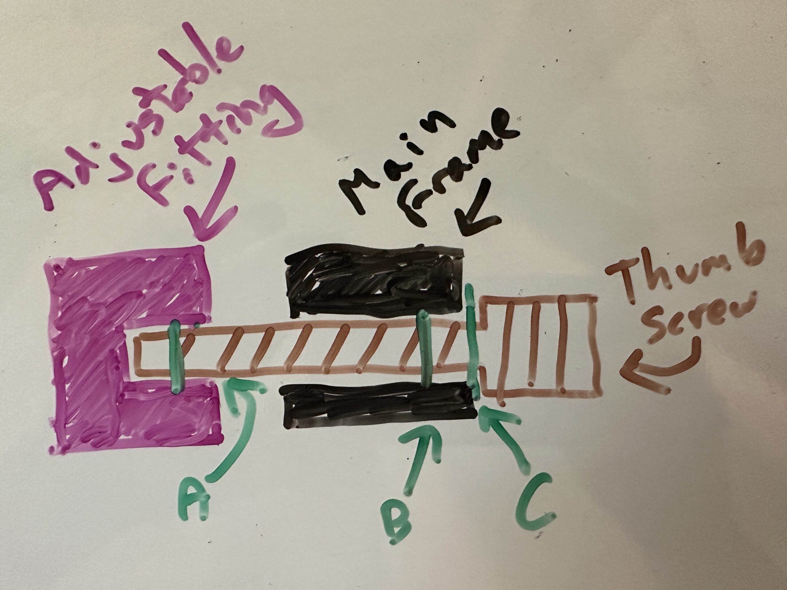

I'd be up to using a thumbscrew that starts on the outside of the frame, where a knurled top fits, then goes through the frame and attaches to the adjuster, like this:
I'd put in slots to fit nuts at A and B, then use a washer at C. This way tightening or loosening the thumb screw would move the adjustable fittings. The problem is I have a friend who teaches sculpture and other art classes who could use a number of these for classes. I know "idiot proof" is a myth, but I can see his students unscrewing the thumbscrews without thinking and losing them, or loosening the screw to the point where it comes out of the nut in the fitting and then having trouble lining things up and getting the screw and the fitting back in place. Still, this may be the best solution.
The end goal is to make it so, as the printed plastic frame wears down, the adjustable fittings can be tightened to provide the tight fit the frame did when new. The fittings won't ever have to move more than 1mm.
I'm wondering if there is some kind of special nut I could put in place that would not have threads on it and hold the thumbscrew in place. I don't think that'll work, though. I've also tried to imagine a way to set up the fittings so once they're in place, they'll be fitting in  place and have a limited range of movement so they can't be taken out of place. I've looked at a number of ideas, but I think this is something I'm just not sure how to fit the parts together. I basically want the adjustable fittings to easily stay in place so they, or any screw or springs used to allow for adjustment, won't easily come out of this when it's in use.

What about printing the spring as part of the inner part? A simple angled strip could be enough, or multiple. Depends how much force you need. Or a V shape. PETG is surprisingly springy.
I can even imagine a print-in-place mechanism, where the two parts are in separable, while the is the spring between them.
Also, try to search for compliant mechanisms. Those are single piece, locally make only small moves, but the whole thing can do so much. Maybe, you could find some inspiration in those.

The main frame B, print holes then insert steel helicoils,
I use this trick all the time. But the "helicoil" kit to suit the thread for the screw requited maybe 3mm 4 mm 5 mm.
I repair so many things in metal and 3D printing, so many years ago I bought the "helicoil" kit that covers the ranges of 3 mm dia up to 16 mm dia.
3 4 5 6 8 10 12 16. mm diameters.
The kits should include individual size Tapping drill, the tap, placing tool, helicoils and the drive knock out.
In your application I would the screw in  "grub screws" IE Allen screws without the head.
Normally for example a 4 mm dia screw, I will print the tapped hole to 5.8 mm dia, same size as the tapping drill dia, this allows the helicoil
tap to cut to the correct dimension.
For tensioning, suggest you find an old remote control or anything like a air freshener requiring AA batteries that have the coiled spring battery retainers.

I'm not clear what the advantage of helicoils is over having a slot at B and slipping a nut in there.

A quick FAG PACKET SKETCH
Use of "Helicoils"
My point being, it is best not to constantly rely on the strength of 3D printing threads
if they are constantly screwed in and out.
Hope this helps clarify the confusion you have.

For the OP's problem:  You might simplify the process with one fixed and one moving right-angled jaw - so:  <0> which would be self centreing and instead of springs line the jaws with TPE cushions.

It sounds like making one corner so it moves in and out and let it adjust to hold what's in the center in place, but that would hold it off center the way i can imagine it.
Mentally rotate your vice 45°...
It depends on the consistency of sizing of the workpieces,  if they vary you might need two moveable jaws and two hand-screws to centre it in the X direction while it should self-centre in Y.  If the size is fixed one screw should be enough.

I was doing that - it seemed to me like you were suggesting one corner be static and the other to be adjustable - I couldn't picture that as a way to keep it centered. But doing two corners - yes, that centers it. This breaks the idea I had in my head completely, BUT allows me to do something better, since adjusting 2 corners is MUCH easier than trying to center by adjusting 4 sides!
One thing this does is make using springs to hold it in place problematic. (Or maybe it just makes that flaw more apparent as I imagine 2 "clamps" instead of 4.)
I would LOVE to work out some spring mechanism that, as I adjust one side, moves the other in automatically.
Moving the adjustment to the corners is a great improvement on the idea. It'll take a total redesign of what I'm working on, but it's well worth it because the result is much better!
