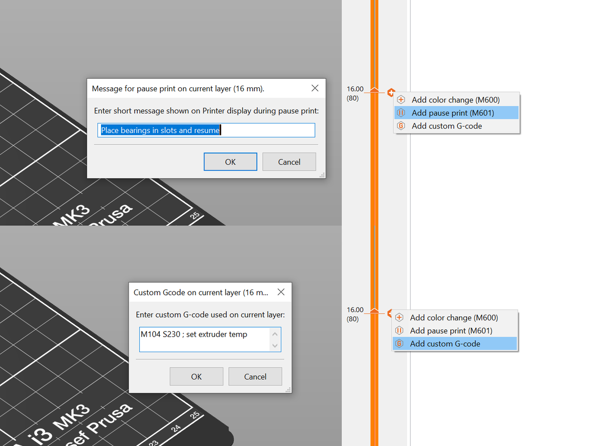

My project is printing a temperature tower. It is set up in already stacked blocks of A through H and each block is supposed to be printed at a different temp. How do I make block A print at a certain temp, block B a little cooler, block C a little cooler yet and so on in Prusa Slicer? Thanks for any help!

In PrusaSlicer 2.2.0 you can do it this way:
For now, you need to adjust the "Printer Settings -> Custom G-Code -> After layer change G-Code" (only visible in expert mode) to:
;[layer_z]
{if layer_z == 01.6}M109 R260 ;temp change{endif}
{if layer_z == 09.6}M109 R257 ;temp change{endif}
{if layer_z == 17.6}M109 R255 ;temp change{endif}
{if layer_z == 25.6}M109 R252 ;temp change{endif}
{if layer_z == 33.6}M109 R249 ;temp change{endif}
{if layer_z == 41.6}M109 R246 ;temp change{endif}
{if layer_z == 49.6}M109 R243 ;temp change{endif}
{if layer_z == 57.6}M109 R240 ;temp change{endif}
Adjust the "layer_z" numbers to the layer height on which you want to apply the new temperature and change the "R" value to your set temperature in °C.
