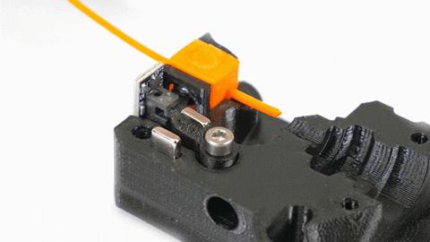

ok so my  autoload on my prisa mk3 i3 is not l0ading the filament at all

check the filament sensor assembly is working
the filament sensor lever may be stuck, or the adapter printer (Orange part in this picture),may have a worn hole
or the sensor board may be loose or misplaced
