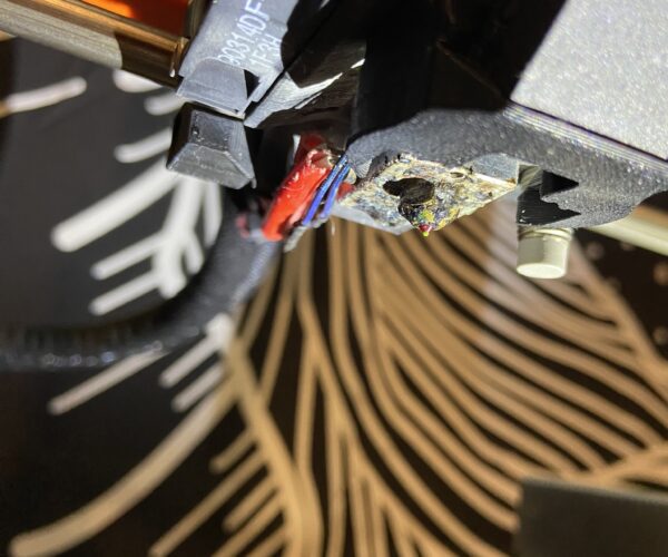

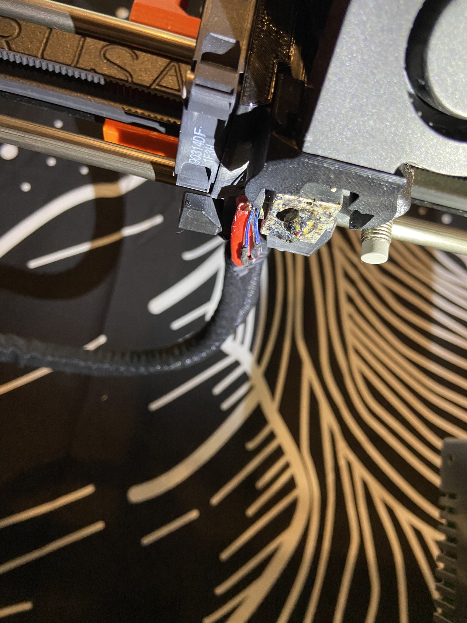

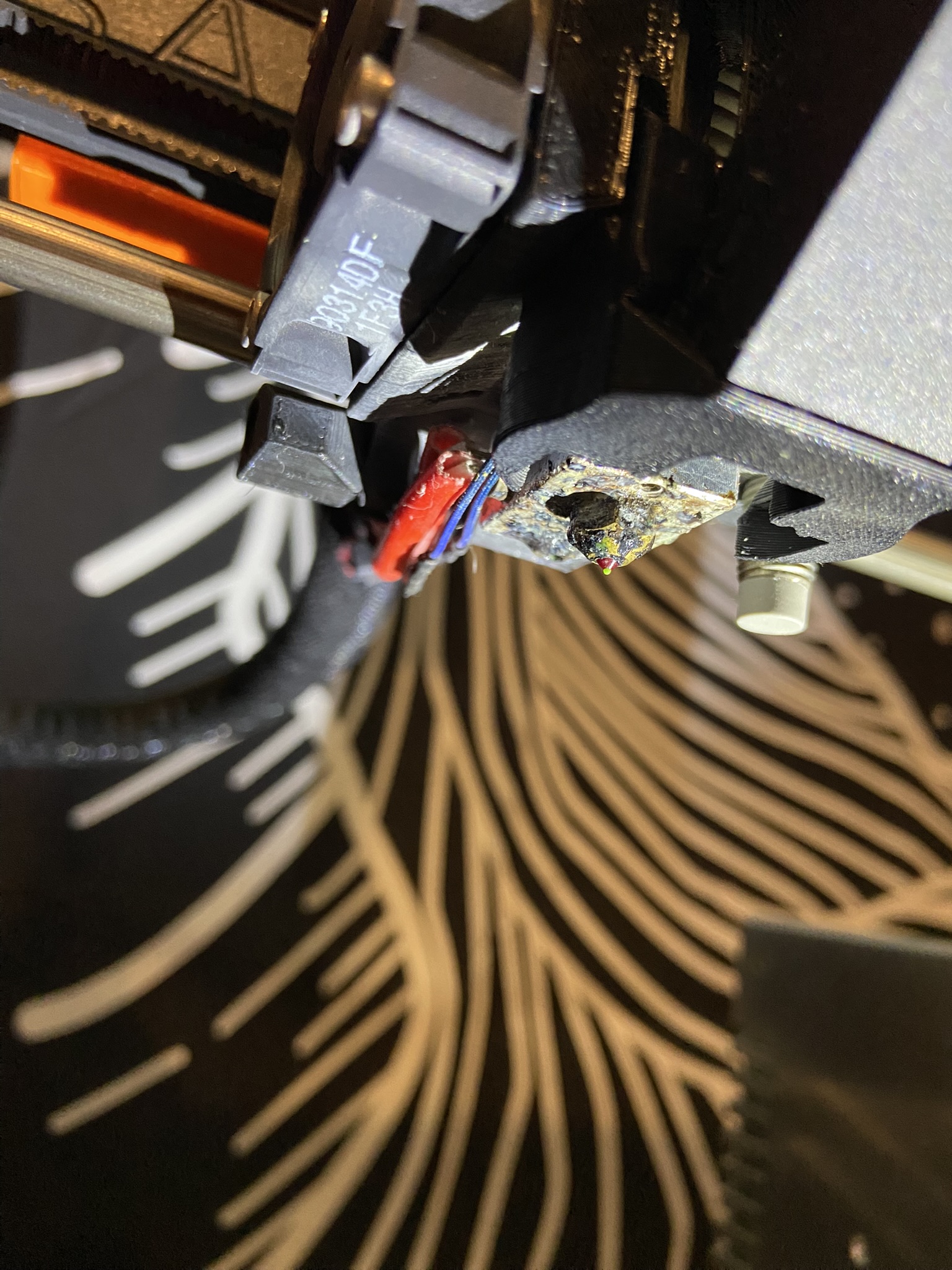

I forgot to post a pic of the nozzle after cleaning it for anyone to give me feedback on its condition. Here are a couple of pics of the nozzle.
I preheated the nozzle and cleaned it with a brass brush as carefully as I could and not touch the probe next to it. I tried my best not to brush anything but the nozzle.
Forgive me on the quality... was taking the pic with an iPhone and getting too close was not in focus.

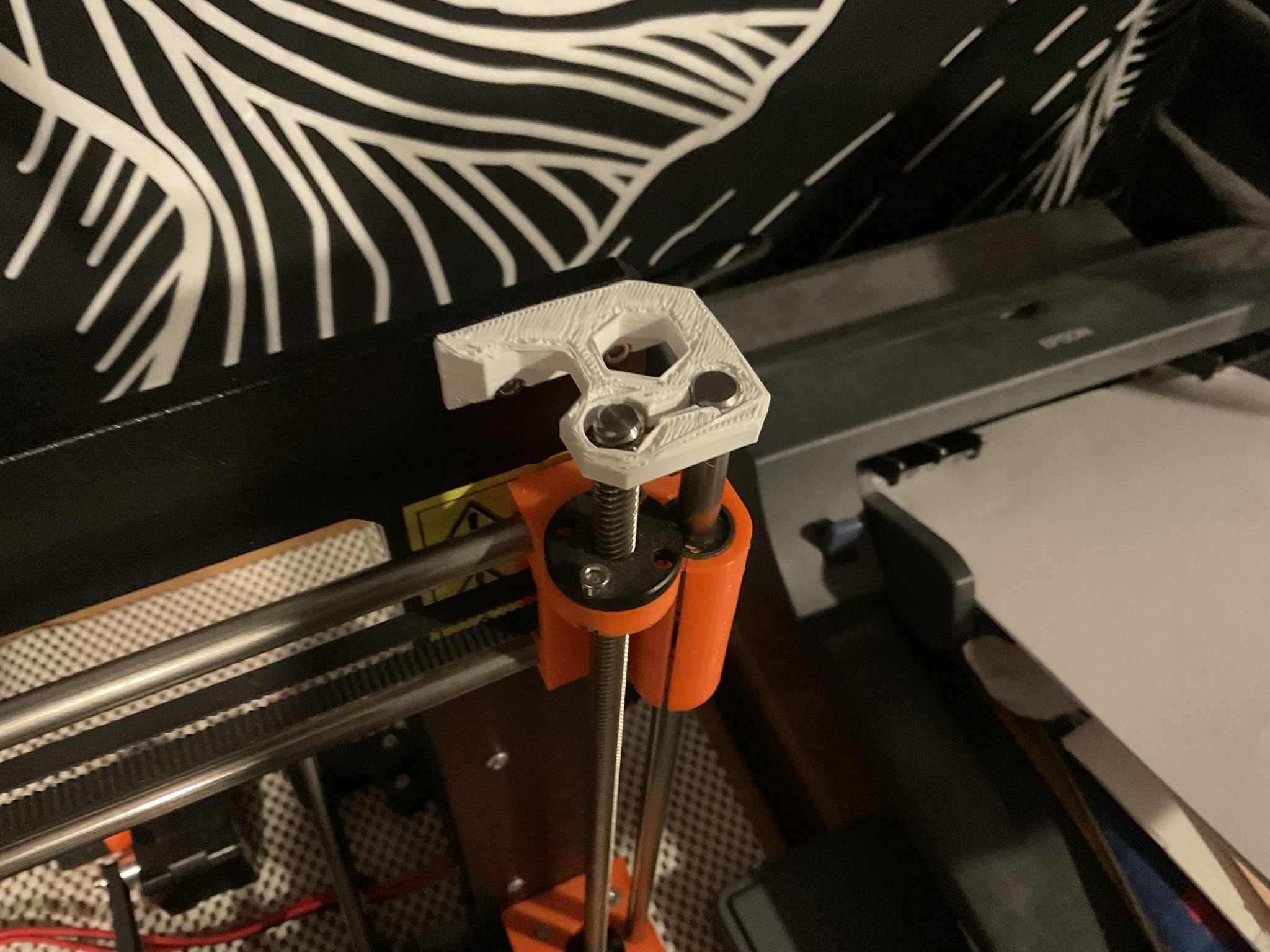

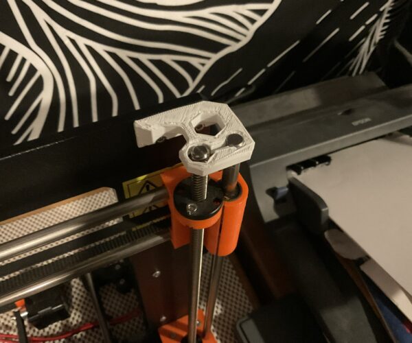

I printed the broken right upper Z bracket in hopes to keep it stable and working.
After some trial and error I learned that using some purple glue on the bed kept everything in place to print more succesfully.

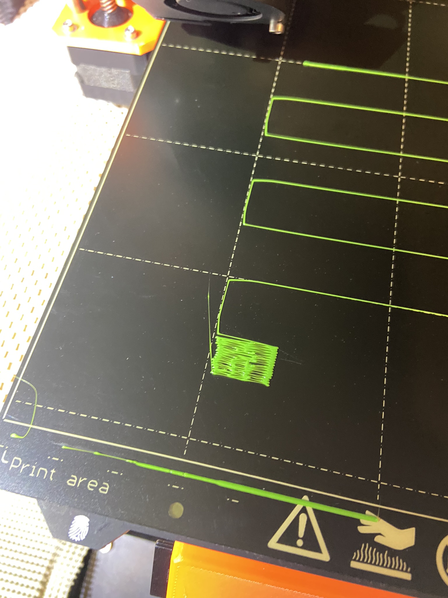

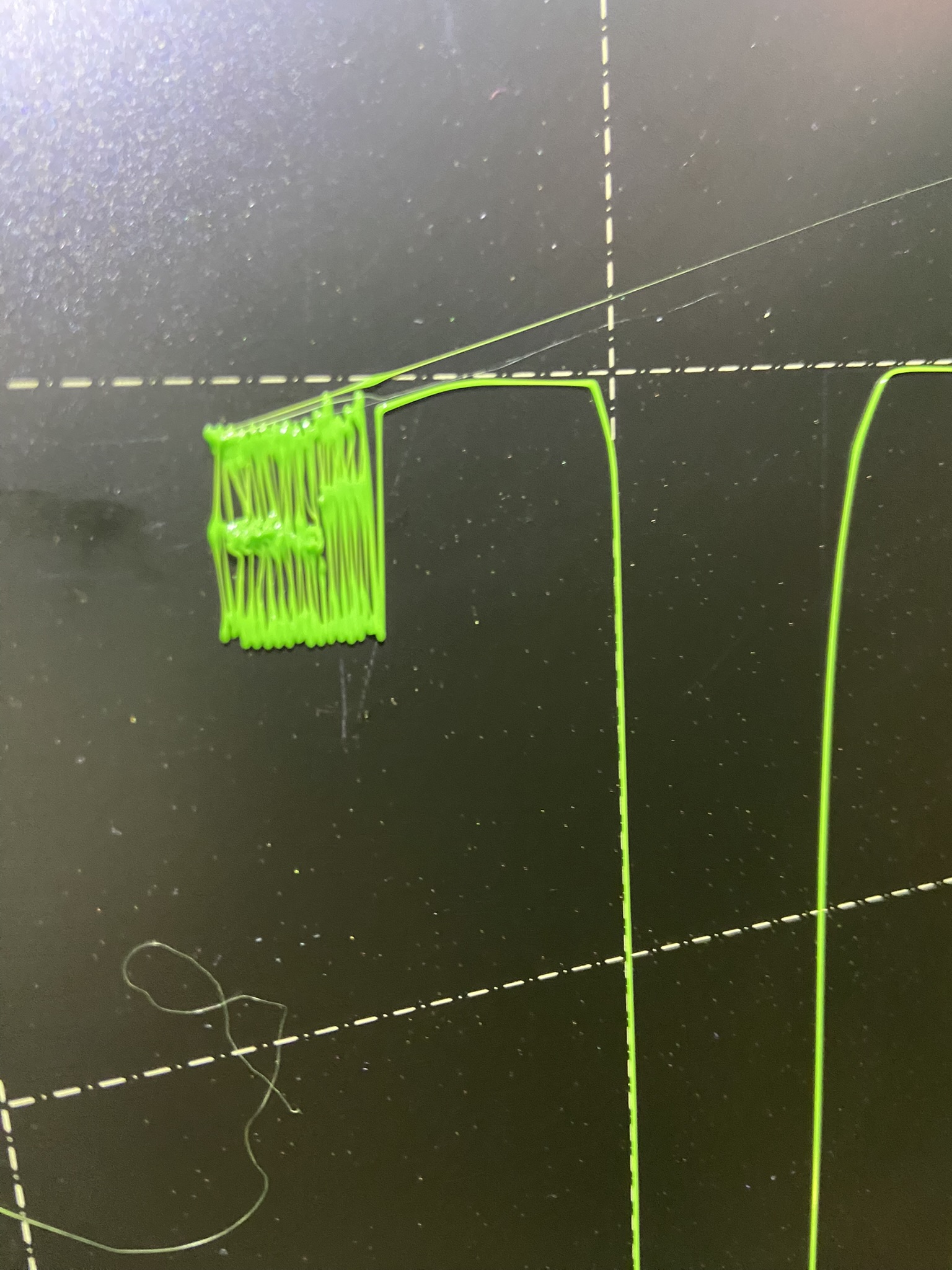

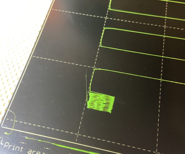

I noticed though that the very first layer or two comes out really rough, almost like guitar strings, instead of being close together and flat. I figured that might be part of the Z calibration.
When I tried to recalibrat the printer after creating the Z bracket and installing it I couldn't get the Z calibration correct or correct from what I've seen online. The inicial print line comes down nice and flat and wide, but when it does the zig zag patter it's not quite right at the top end of the print when it make the wide corners, and when it does the square patter at the end it isn't a flat square. I tried adjusting the Z axis and nothing changes with settings anywhere from 0.00 to -0.280. It all comes out the same.

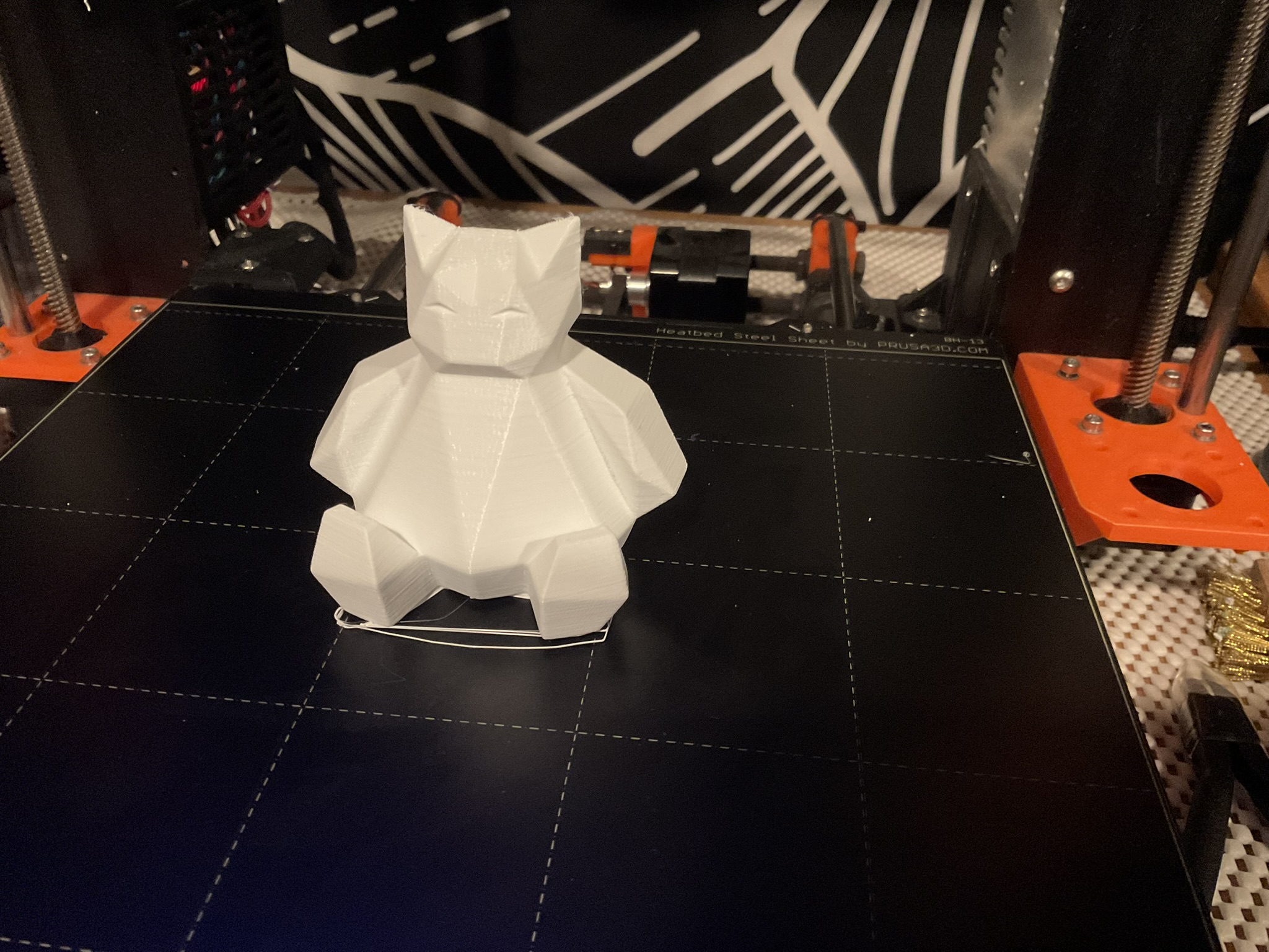

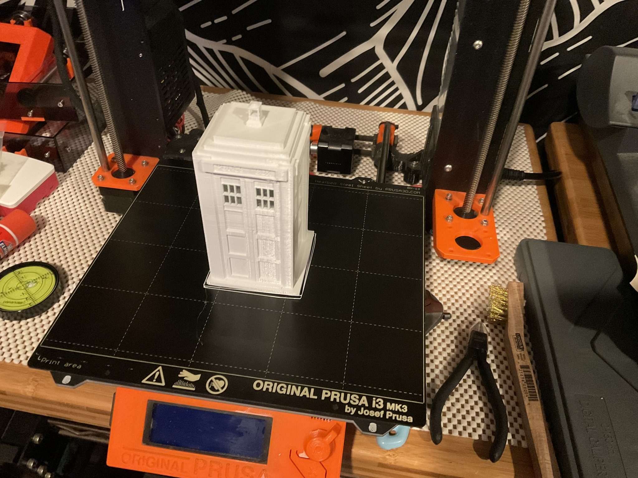

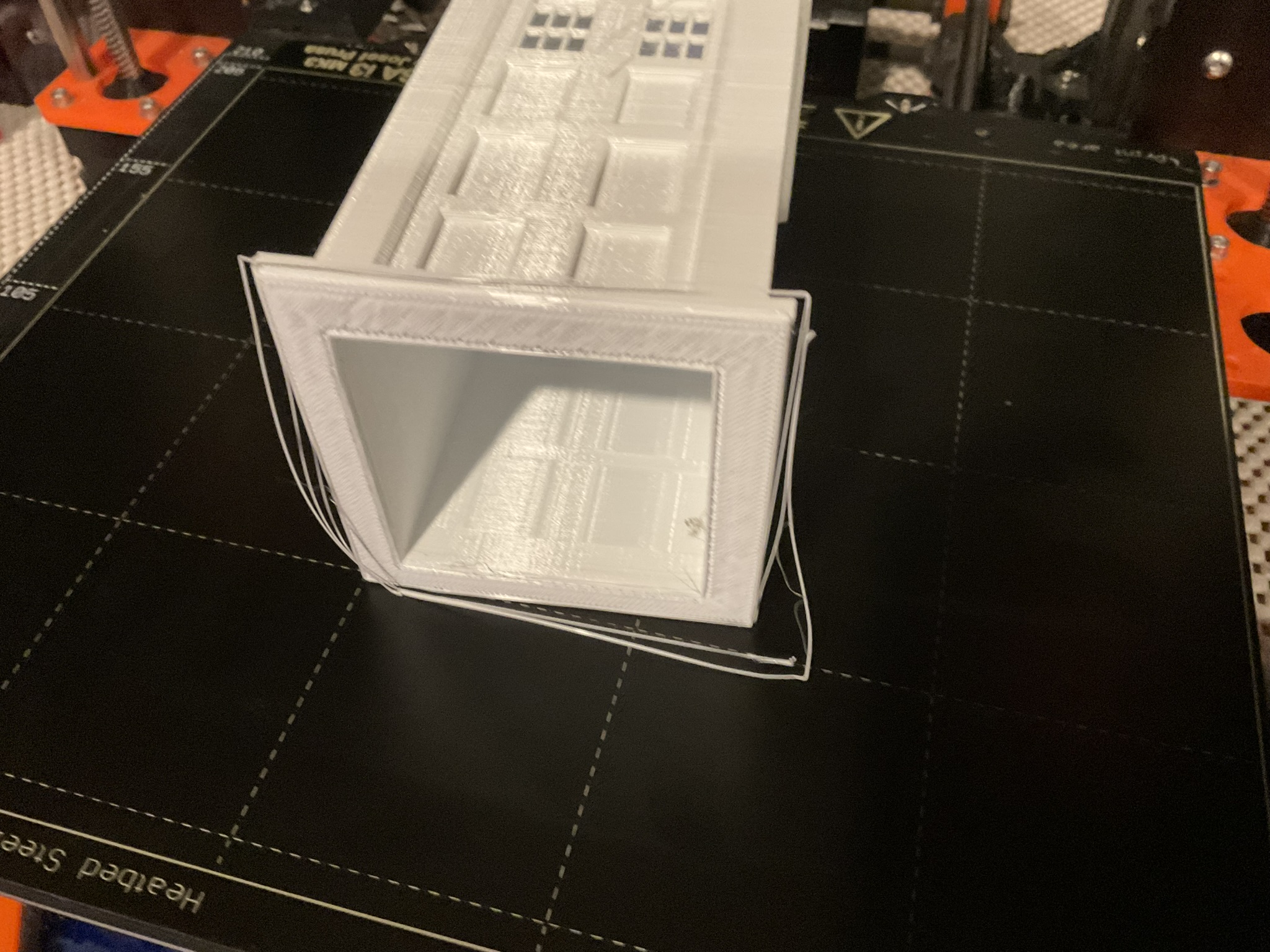

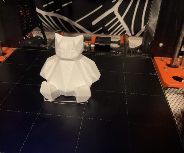

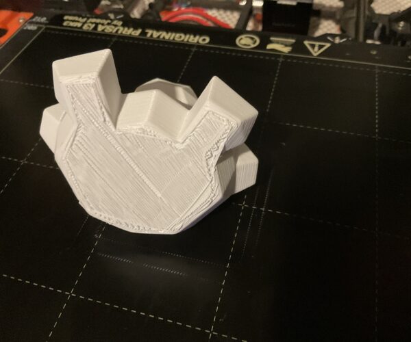

Even with the Z calibration issue, on a whim, I tried a simple print to see what would happen and it kind of turned out nice. You can see/feel the really fine layer lines but as it kept printing the last layer or finish was nice and not like the guitar sting like bottom.
I tried a little bit of a bigger object and it too came out pretty nice except for the very bottom 2 or so layers...

The nozzle is still too high, not only is the square not placed correctly, but also in the corners of the meander, the fiber does not hold and is pulled behind the nozzle. Do not be afraid to go even lower in fine-tuning the Z height, the corners where the meander changes direction must be nailed on the board and nicely perpendicular. Use white PLA for debugging, mistakes are easier to see. And the mat must be absolutely clean and degreased, without any glue. It is also a good idea to check the nozzle height in different places on the board. It is done similarly to the leveling of the mat for printers without MBL. Move the nozzle to the back left corner and measure its height by inserting paper or something into the gap between the nozzle and the pad. Then move the nozzle to the other corners and the height should be about the same. MBL is able to handle small deviations, unfortunately not large ones. And when I look at the photos in which condition you got the printer, I have great doubts about the verticality and correct assembly, because the damaged part at the end of the threaded rod indicates not very careful handling. The threaded rod MK2 construction suffered from very poor alignment of the base and frame, both in the X and Y directions. Download the MK2 assembly guide and visually go through all the assembly steps, especially the warnings for possible errors. Also, be careful when using other sheets (textured) Live Z will change, because the sheets are different thicknesses.
May I add: When you do not want (or are not yet able) to do a complete Z-calibration, you may go to settings in the menu.
There you find Z-axis adjustment. Change the height there and do the first calibration again.
Looking at the pictures, you have to go about 0,2 mm lower. (but check this in steps, you do not want the nozzle scratching the bed).

Get your self a bottle of alcohol/IPA
Get your self a bottle of alcohol/IPA. Heat up the to about 80-90 Celsius, to clean it even better.
The printing might improve if you buy silicone socket(s) for the heatblock. That is not expensive, but helps a lot to keep the temperature stable (On the 12 Volt machine a cold draft, specially from the fan starting up at layer 4, might be enough to give a dip in the temp).
