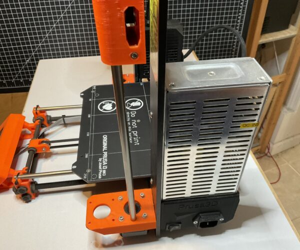

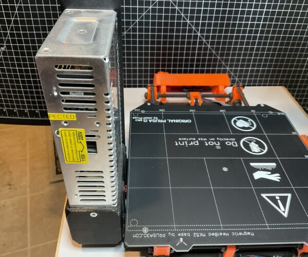

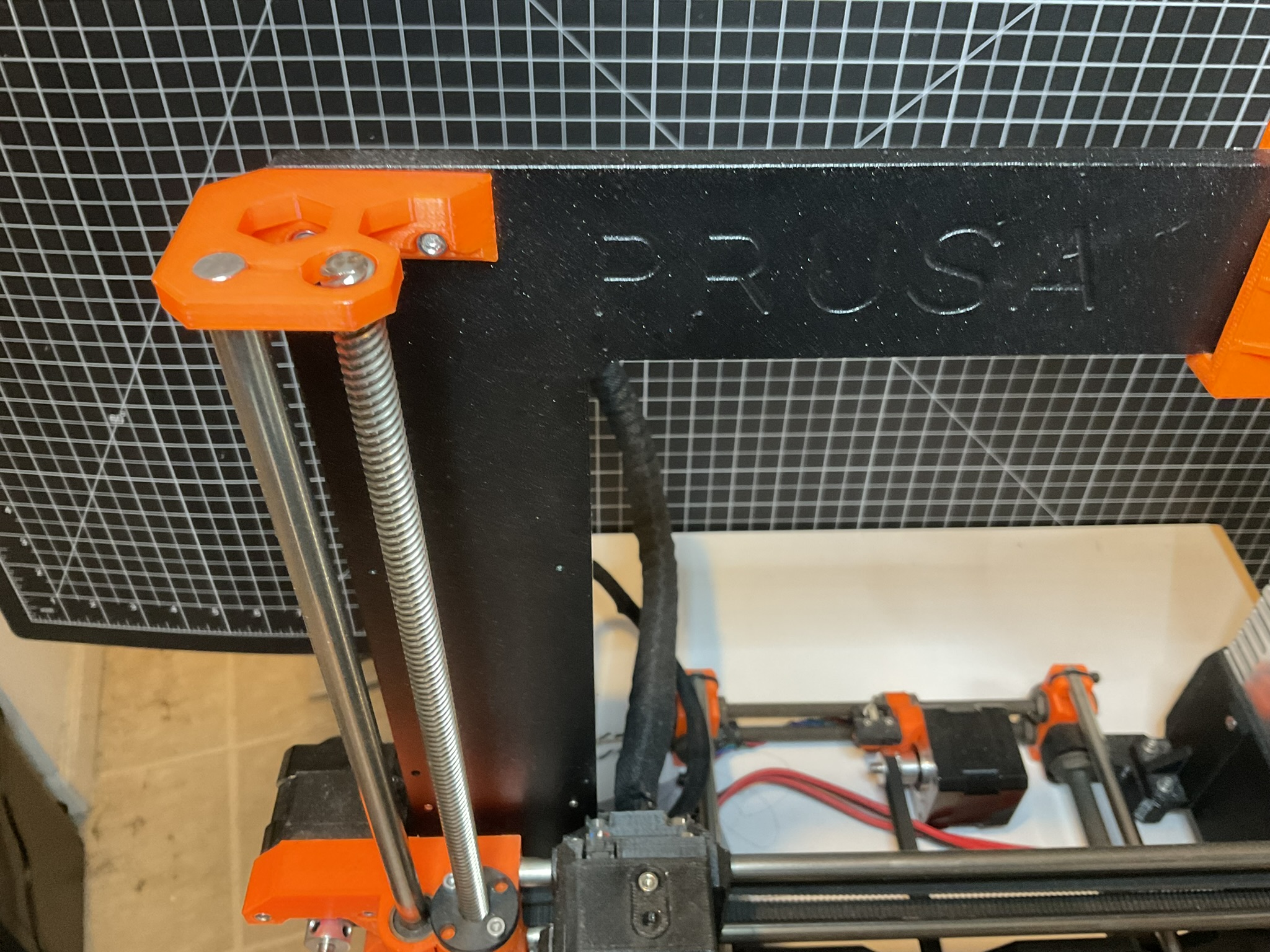

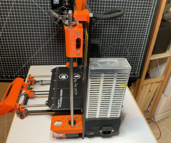

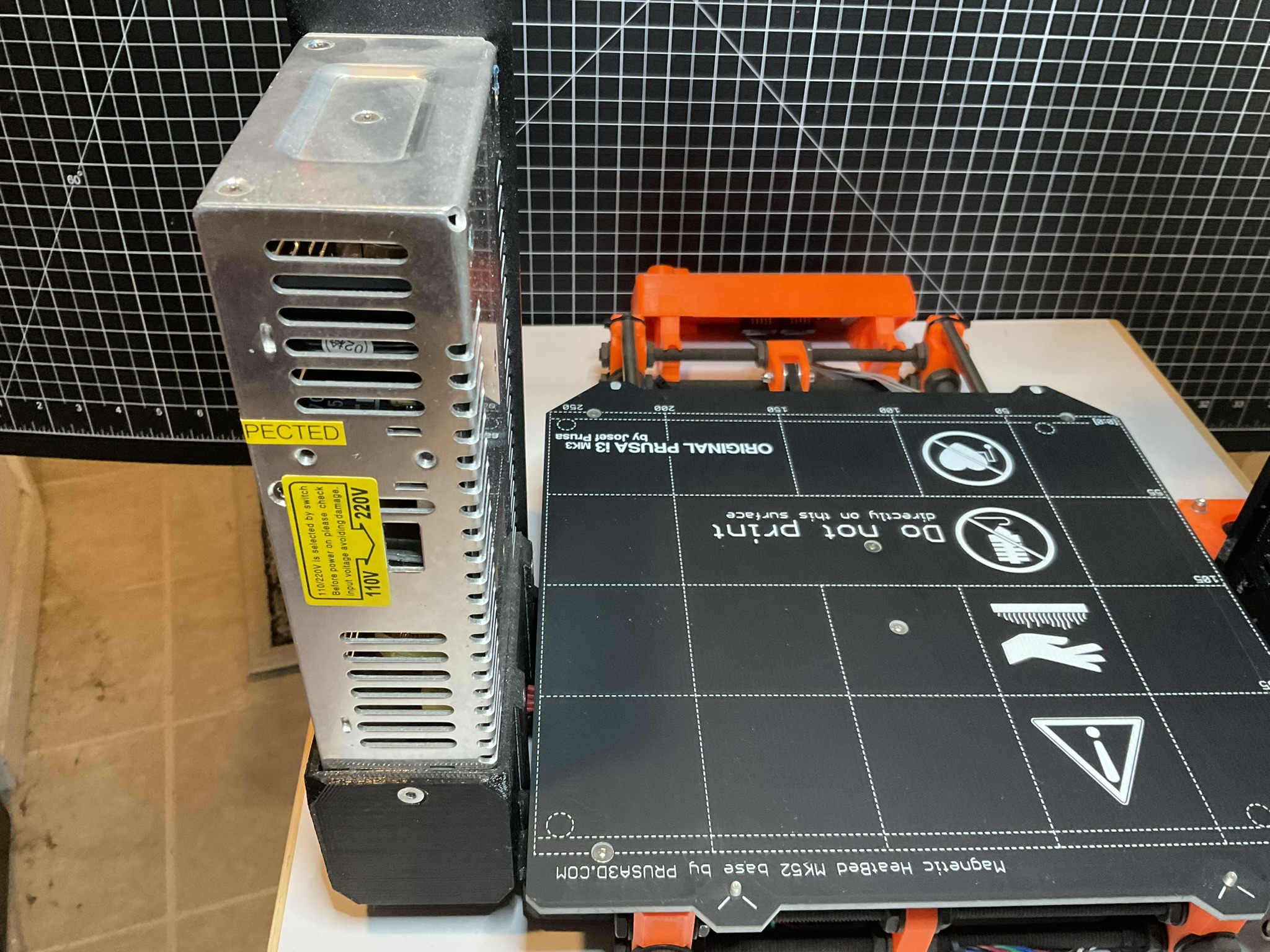

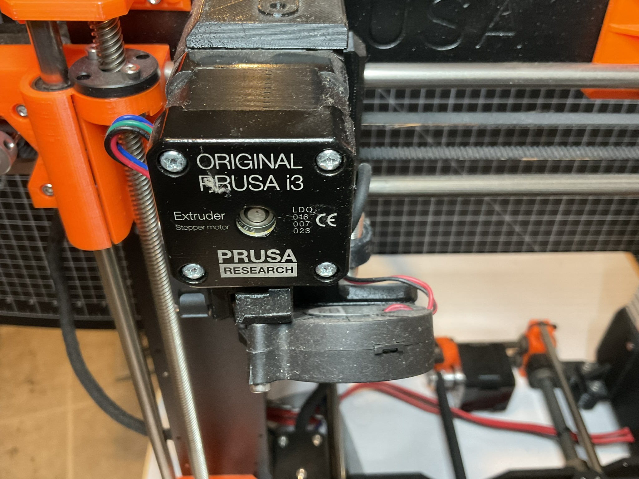

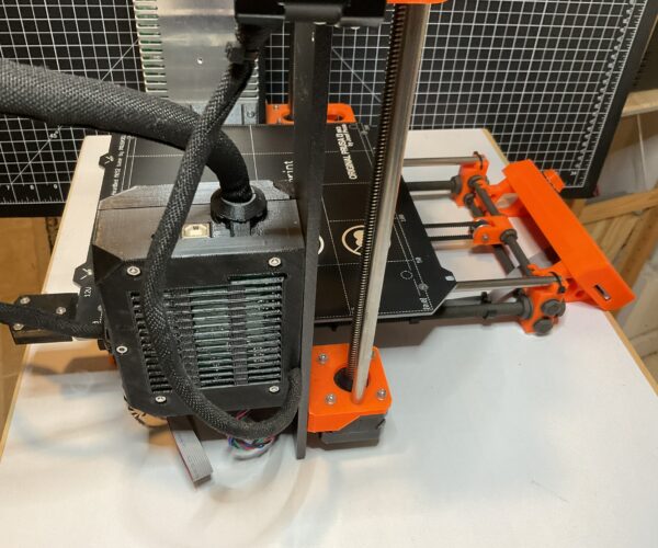

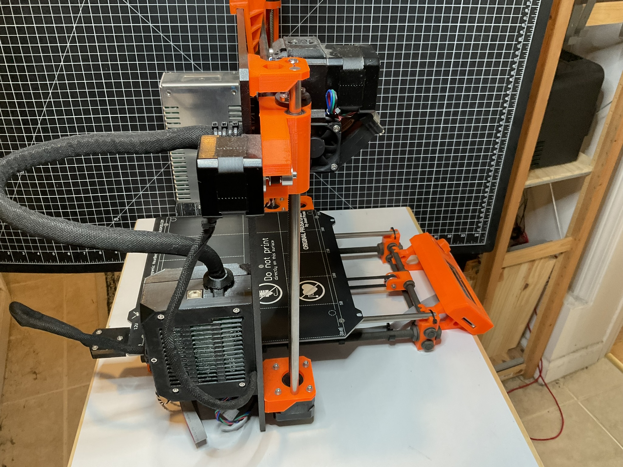

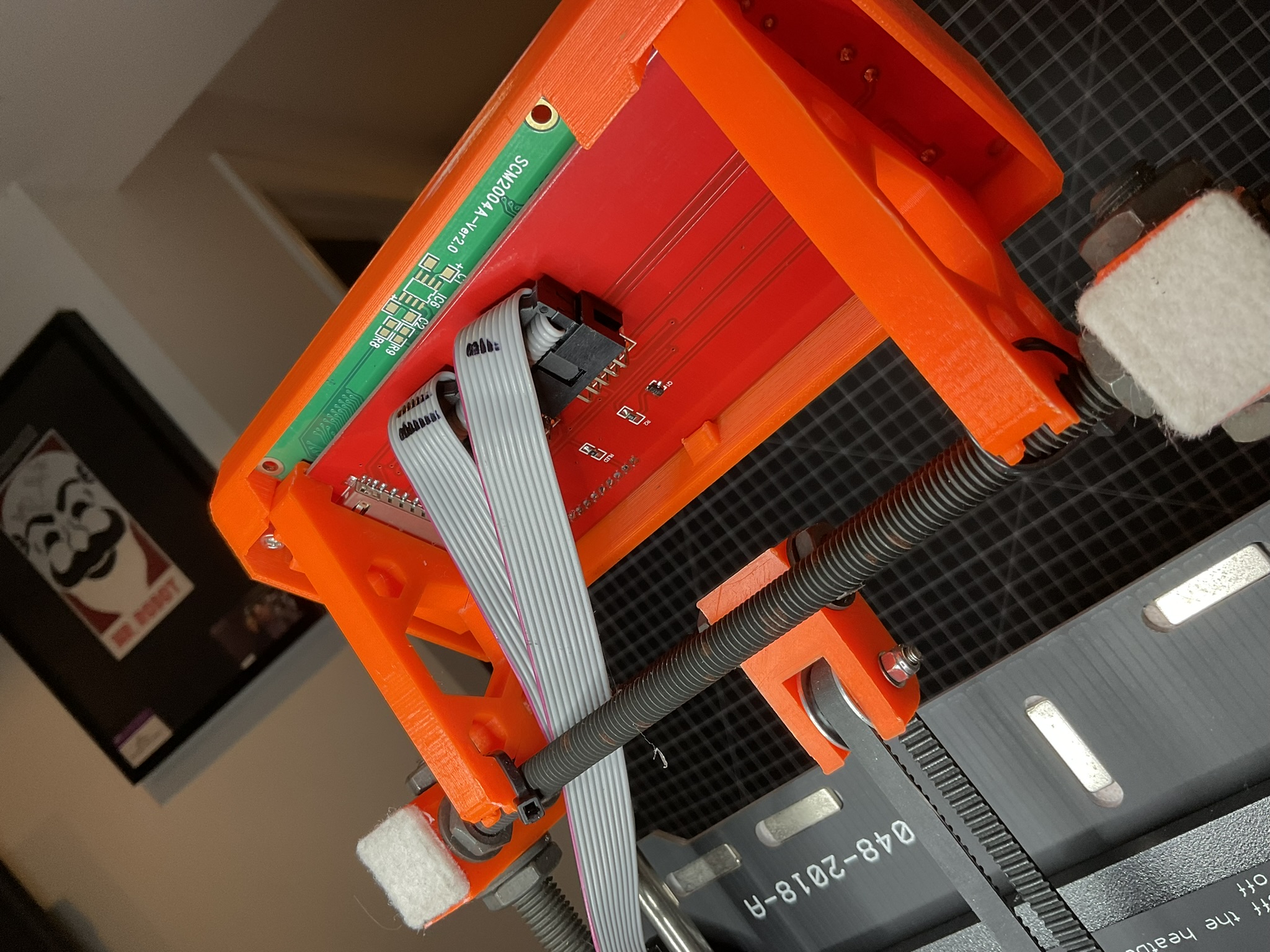

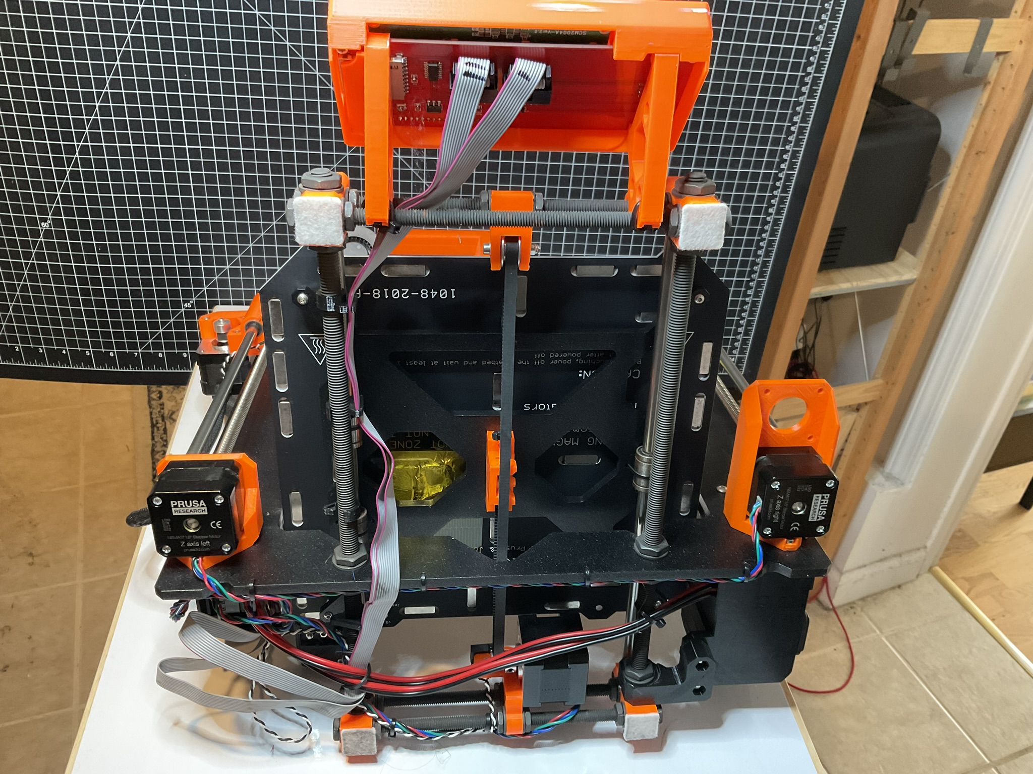

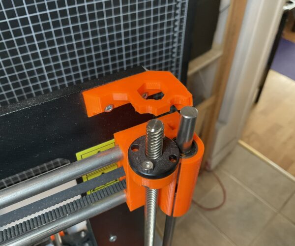

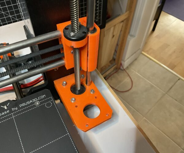

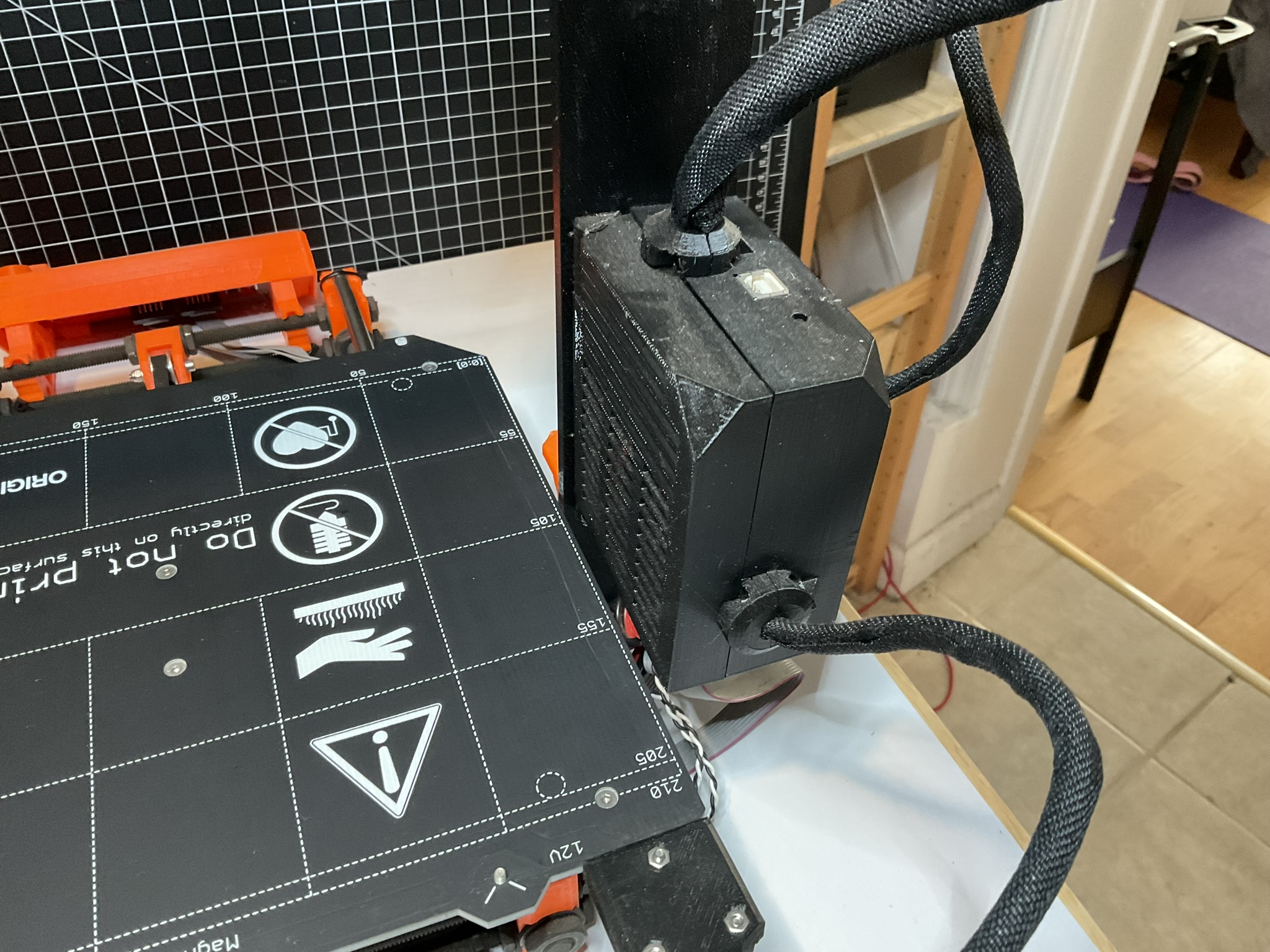

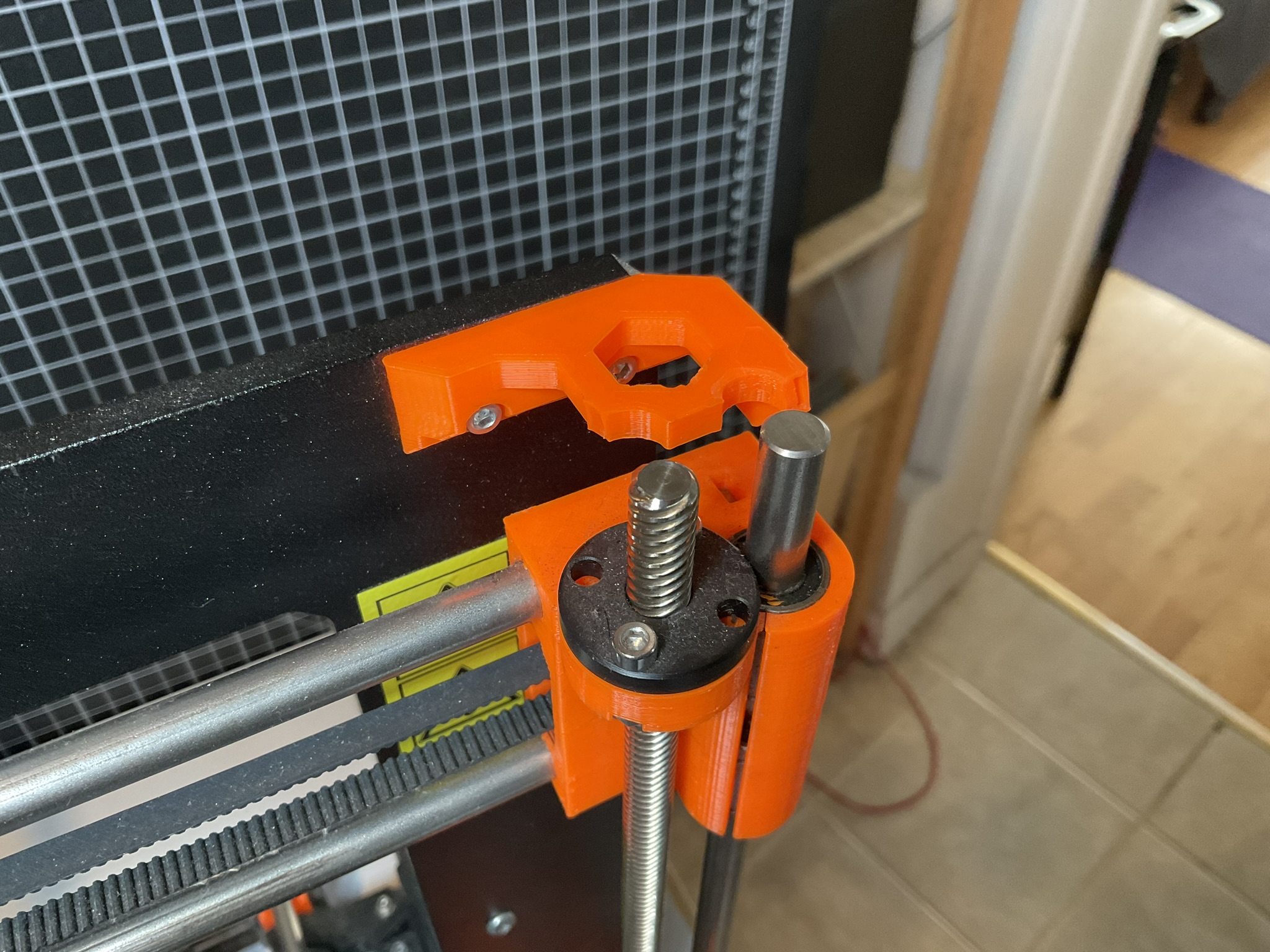

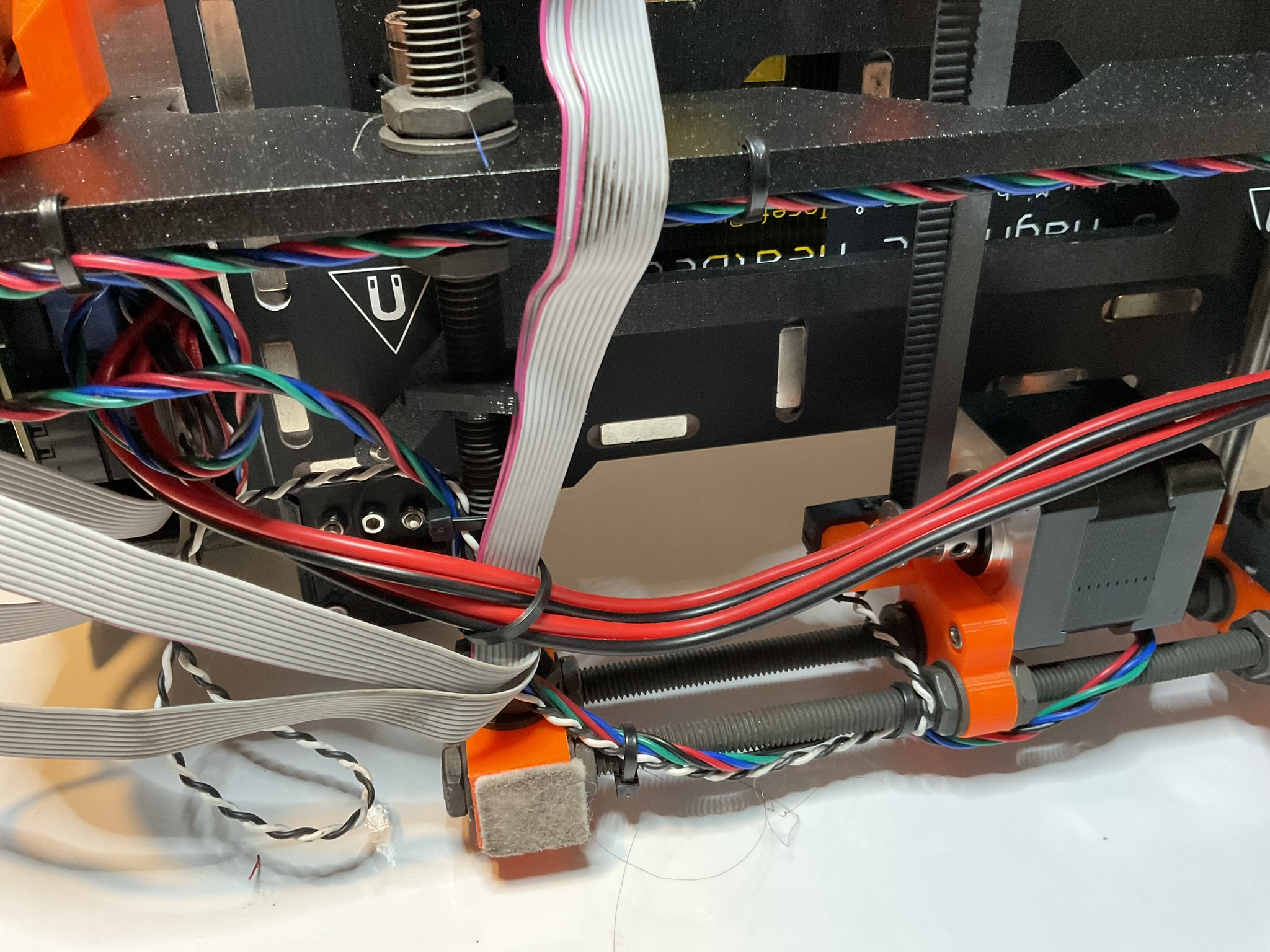

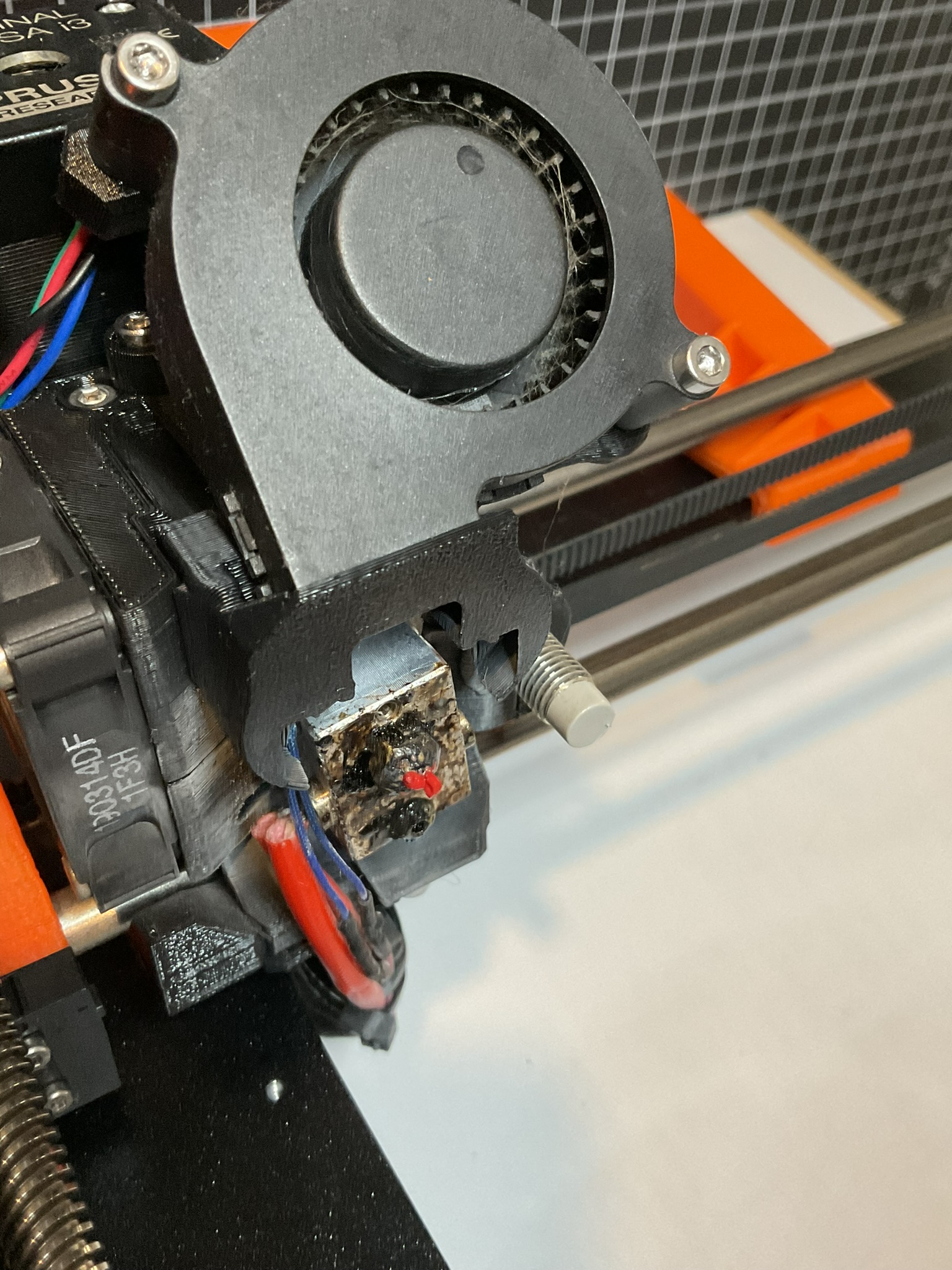

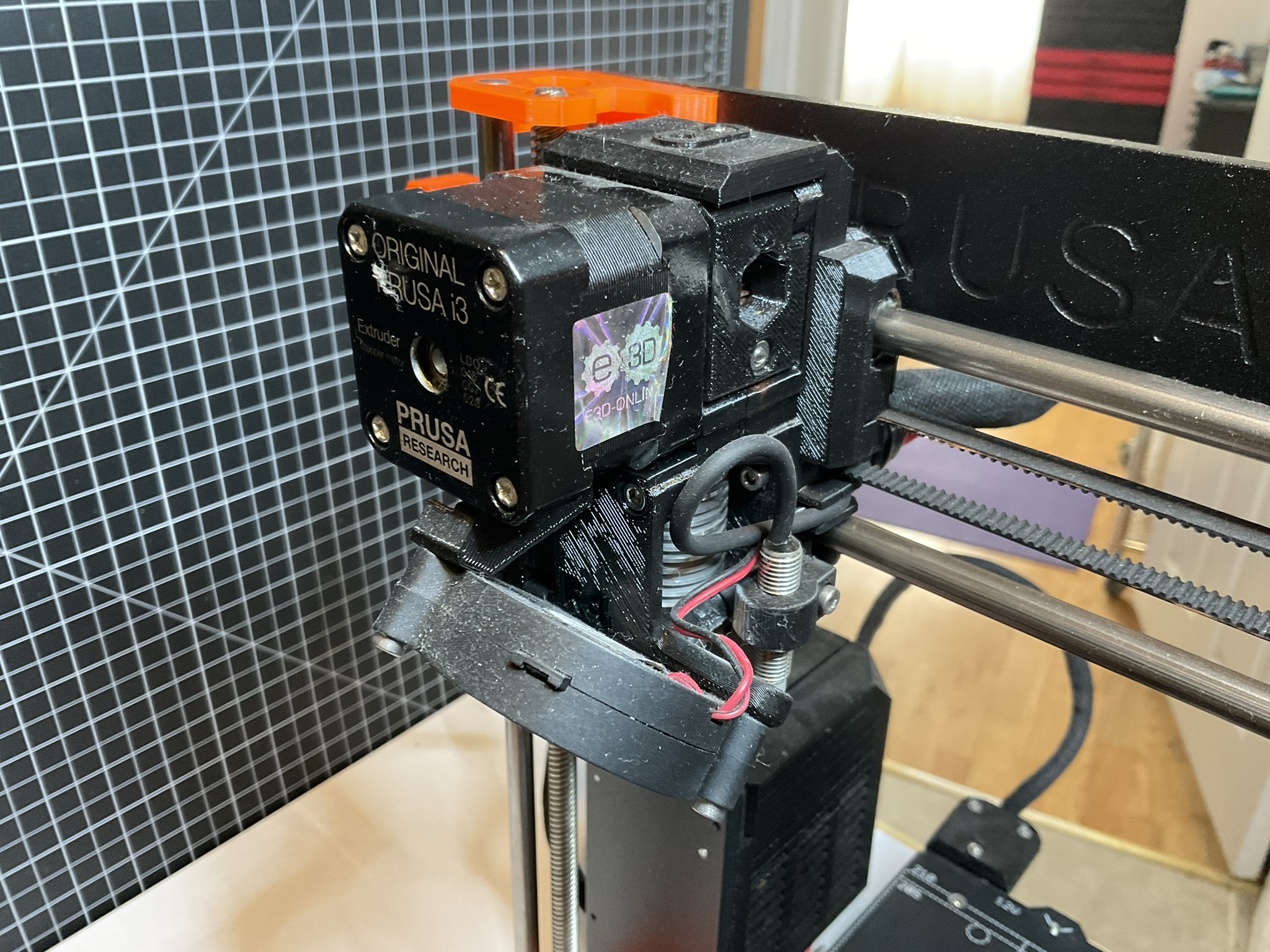

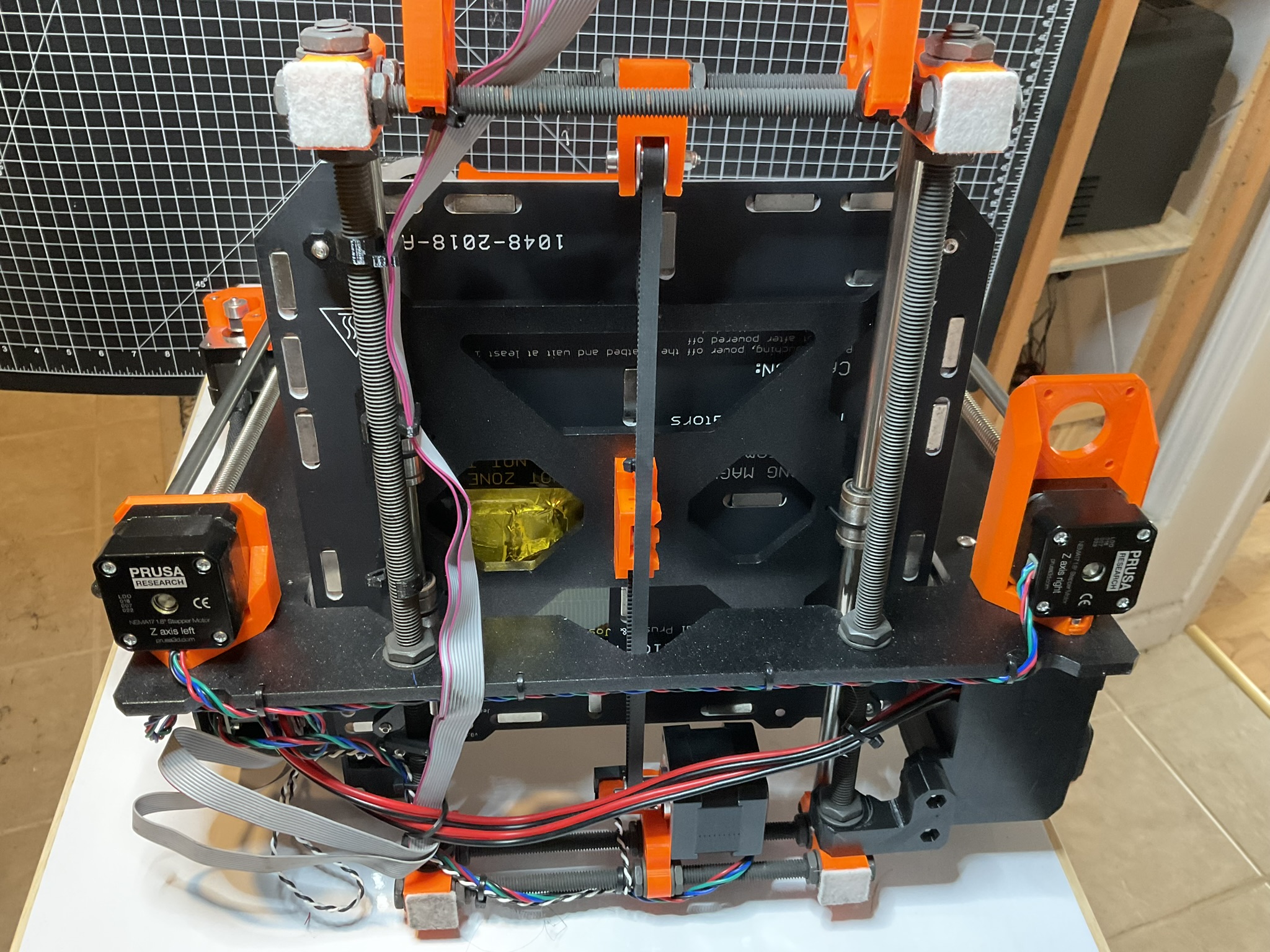

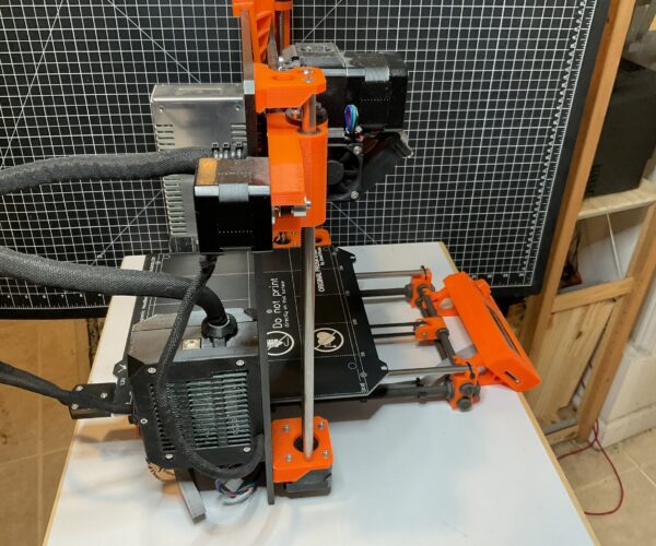

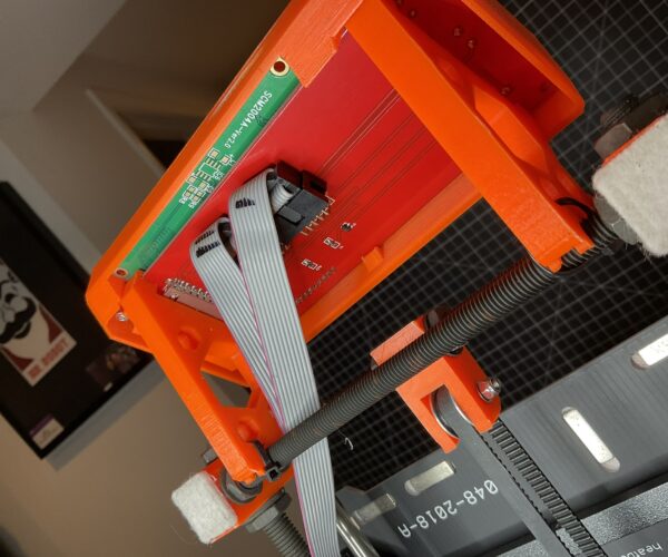

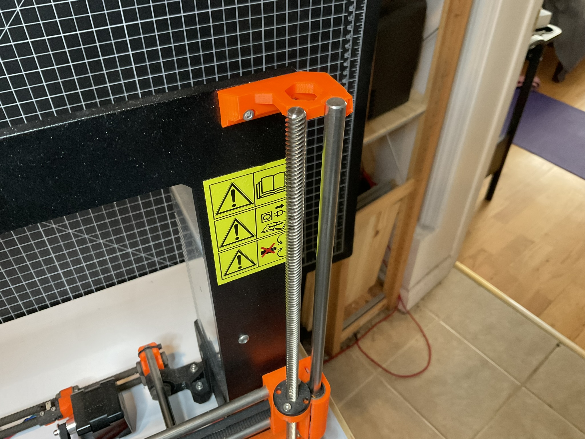

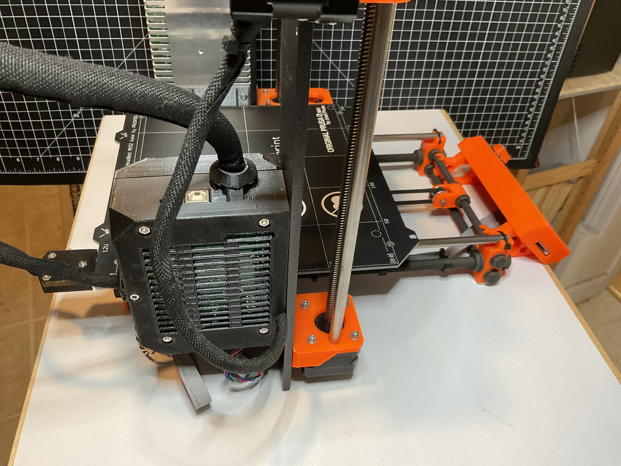

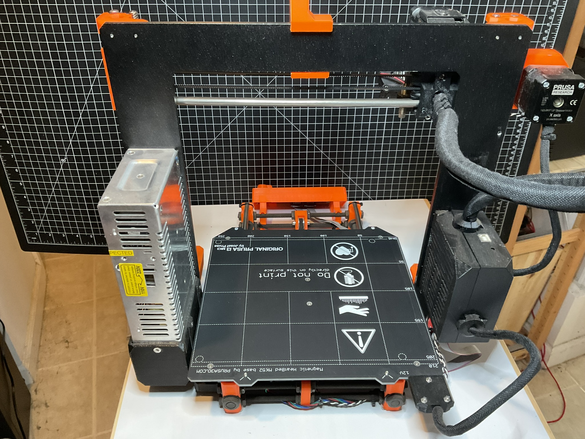

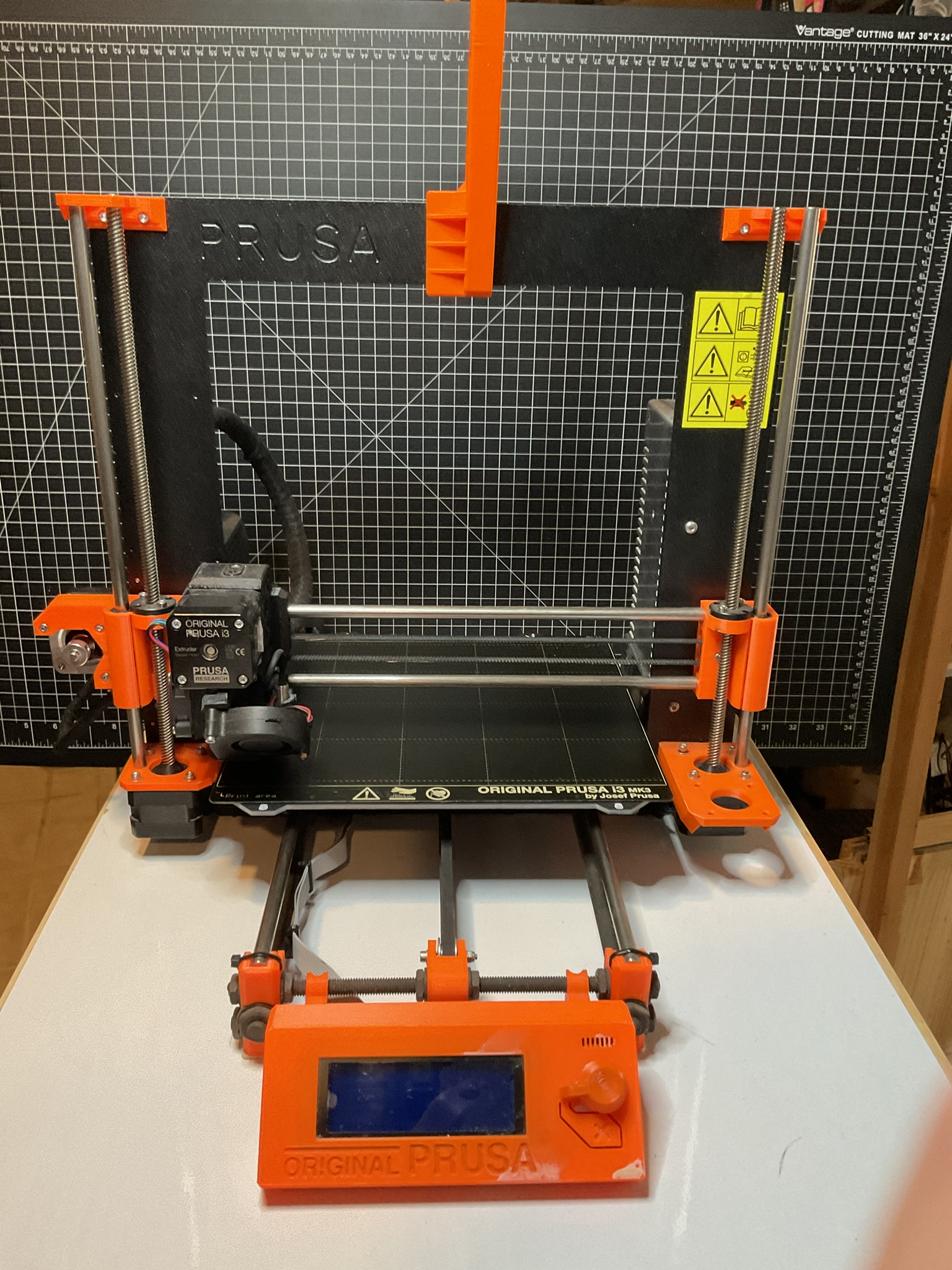

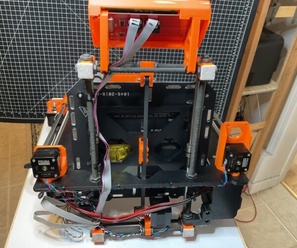

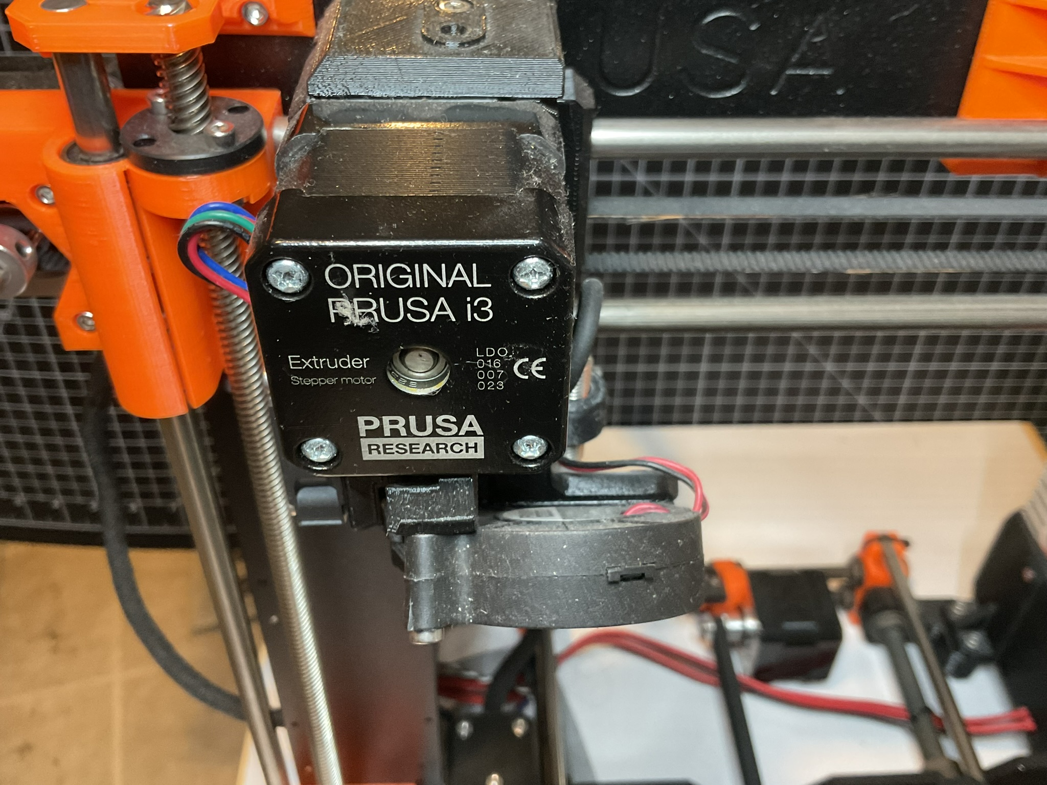

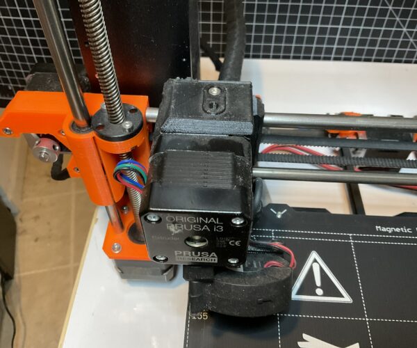

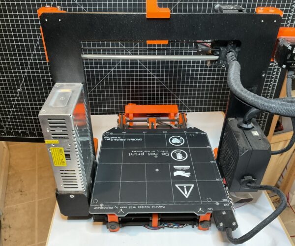

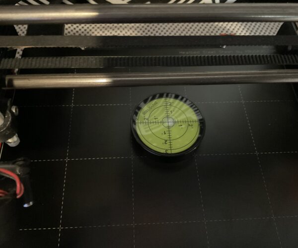

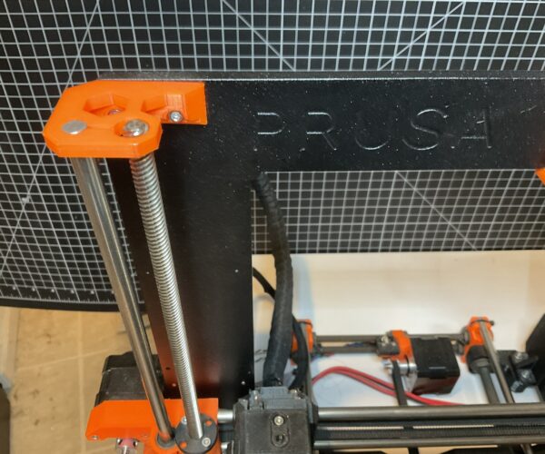

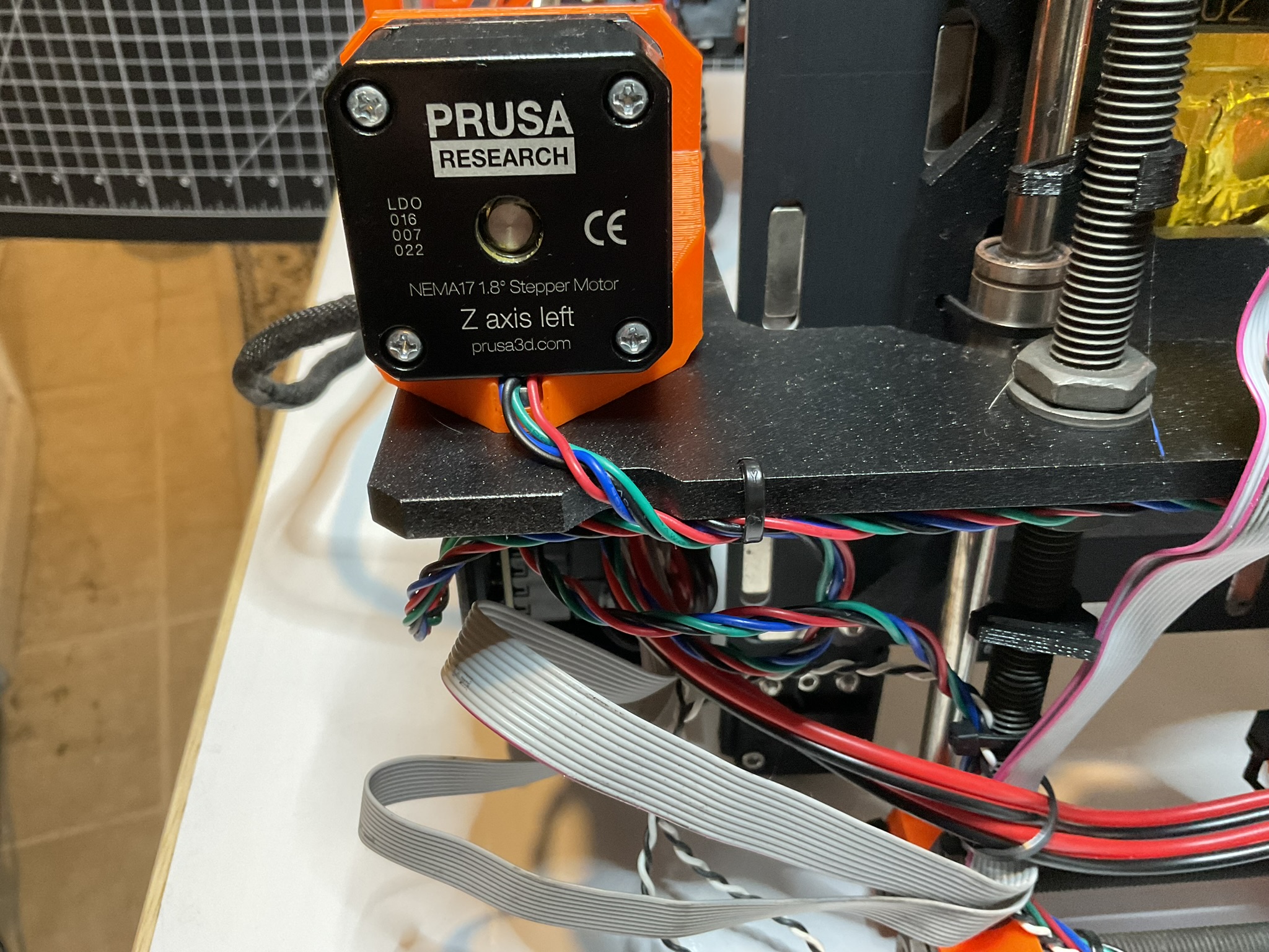

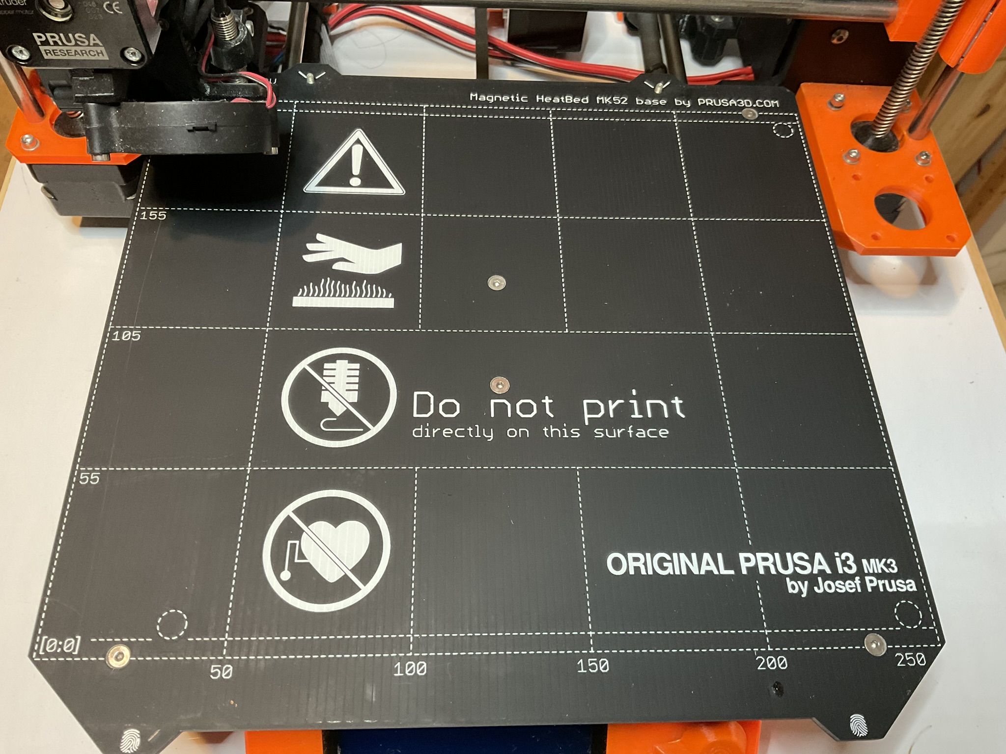

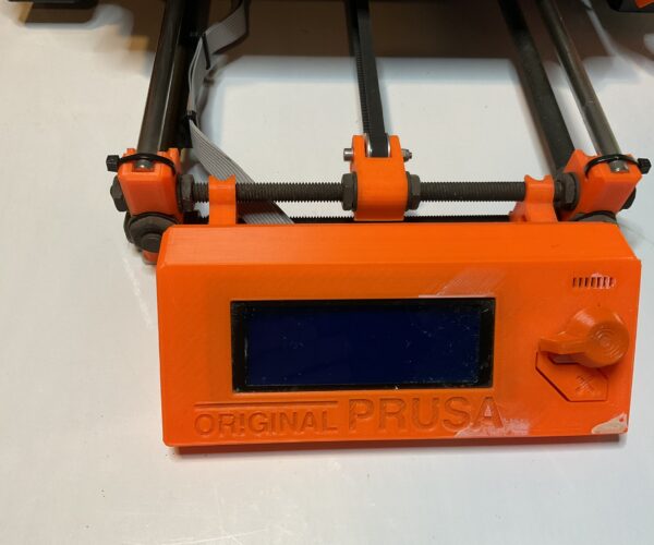

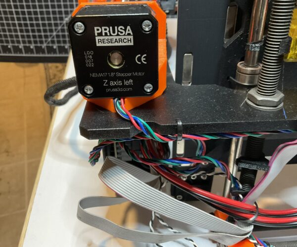

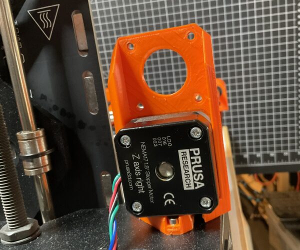

Hello, I hope this collection of pics are OK to post.
I have a slight vision disability so looking at some of these is interesting for me to see what looks worn.  It looks like I'll need a new extruder or hot point (whatever it's called... I'm learning) unless I learn how to clean that part.

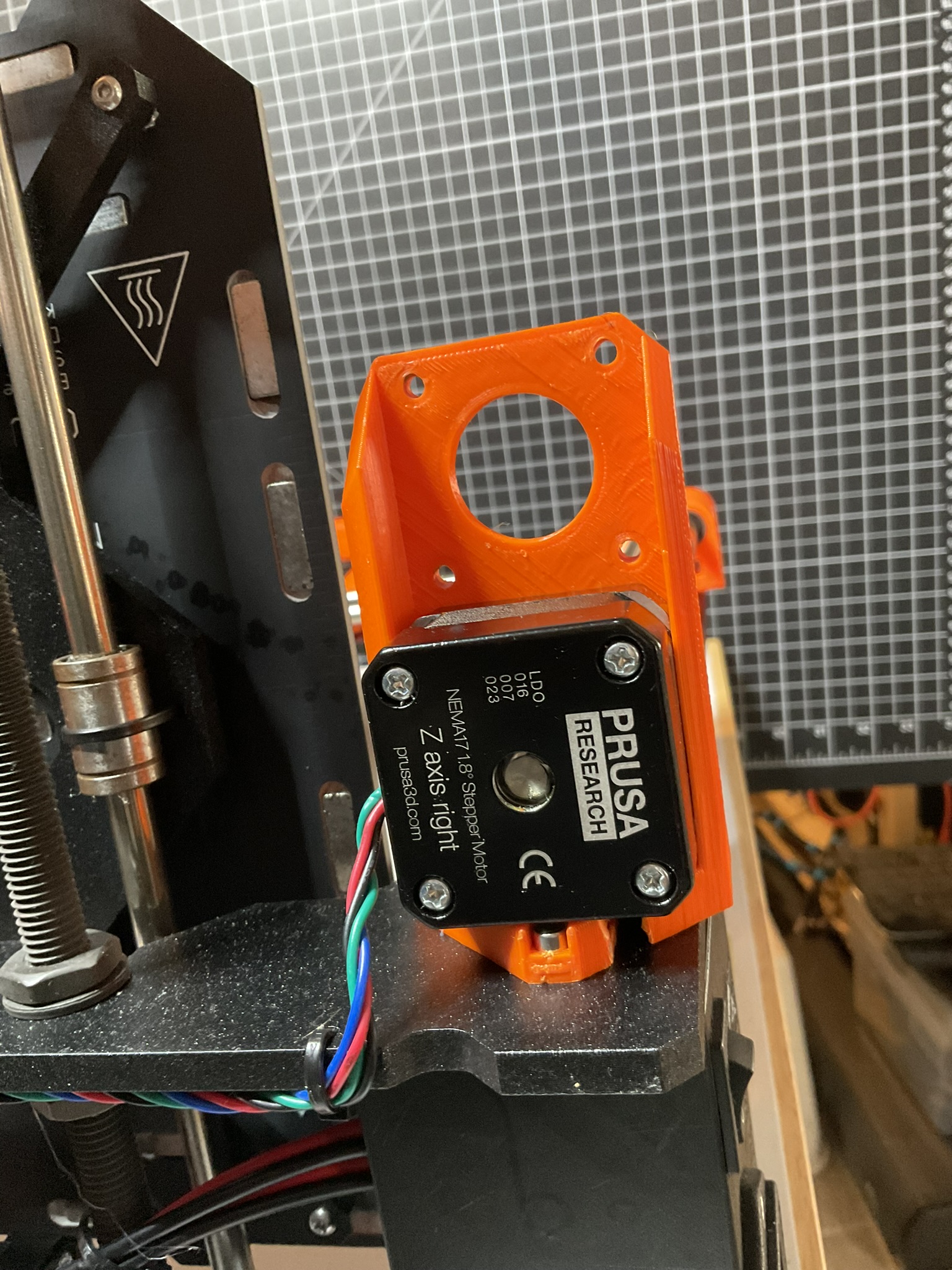

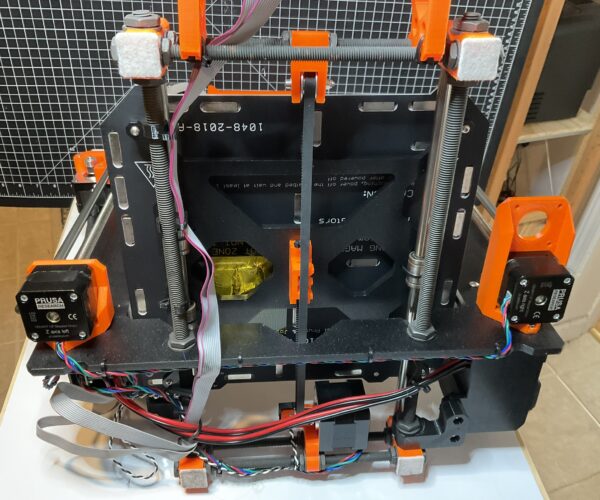

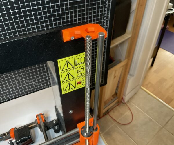

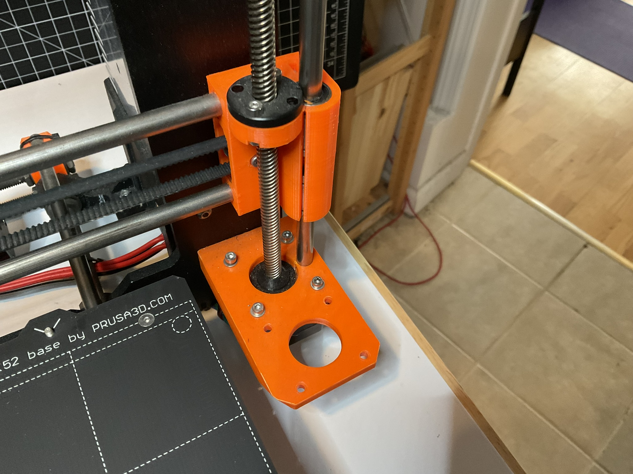

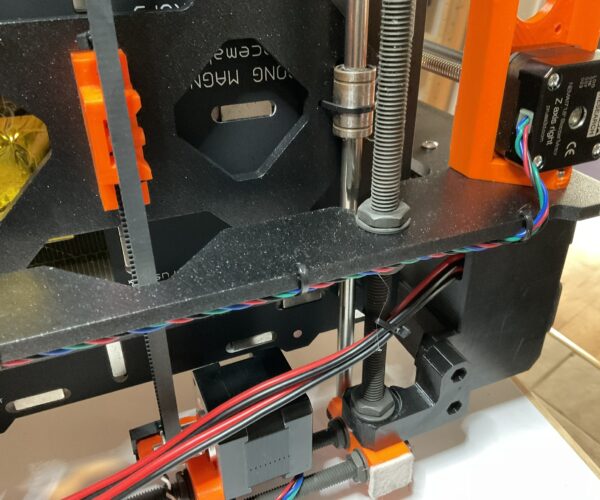

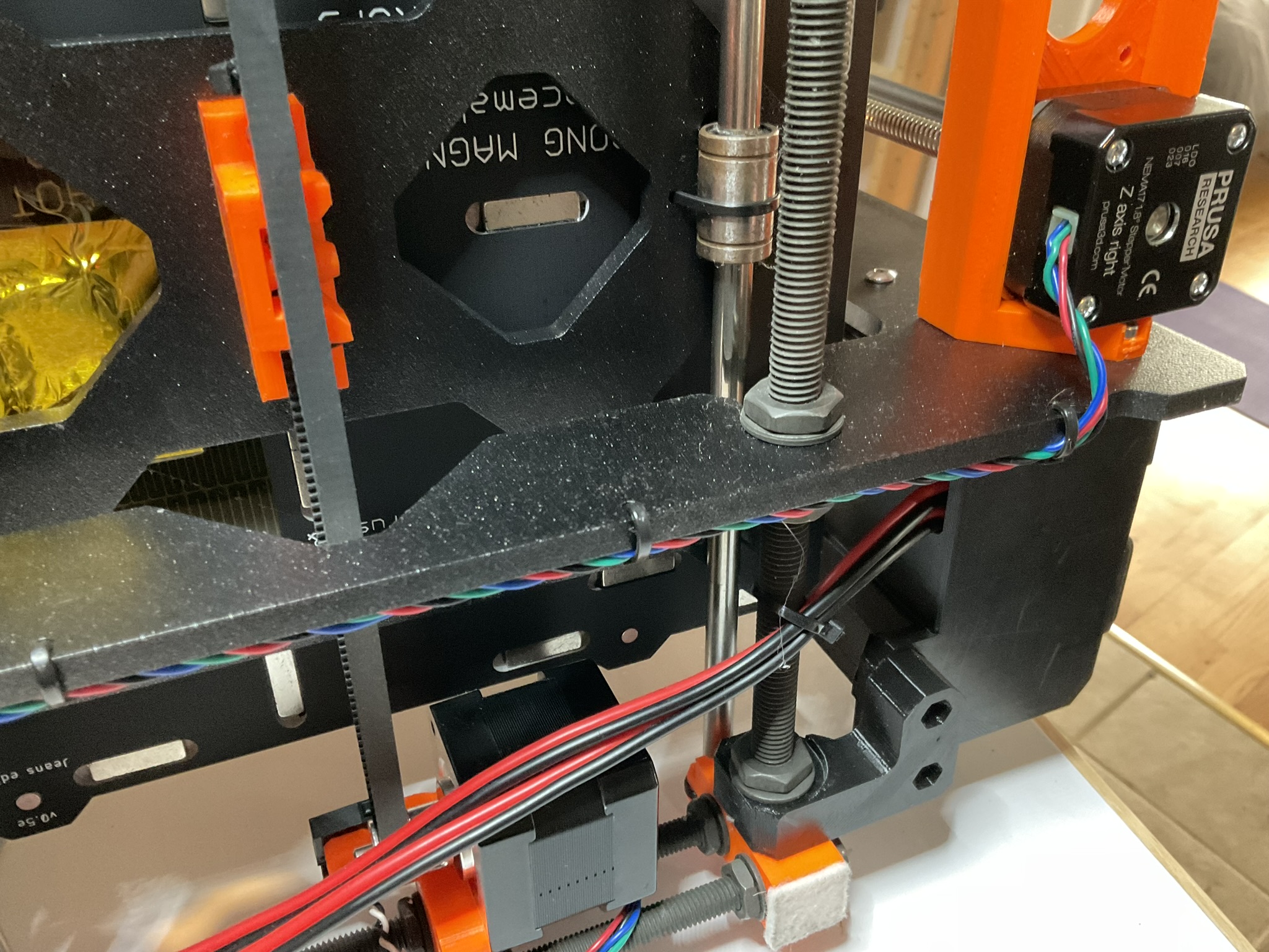

When I look at the upper right Z axis bracket it feels like there is some tension when the Z axis is as far up as it can go, which is probably why that bracket broke.  I can't tell why or what is causing the tension.  I hope the new part that should be arriving soon will keep it in place without any problem.
If you spot anything else that I should pay attention to please let me know.  I'd appreciate it.

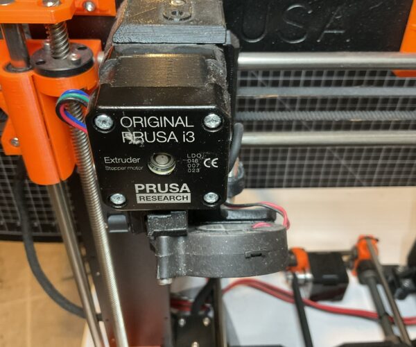

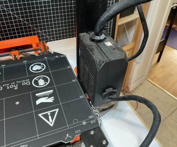

On the first attempt of the calibration wizard it spun up the fans and the front/extruder fan is a little noisy to me so I may need to replace it.
Posted : 13/02/2024 8:56 pm
RE: Hardware to Inspect i3 MK3
try taking the fan off, peeling the label on the back, just over half off, to expose the bearing hole, then putting one drop of light oil in the hole
Clean off any spillage and replace the label and then replace the fan.
With luck your printer will be quiet enough to use while you await the arrival of your new fan
Joan
Posted : 14/02/2024 9:27 am

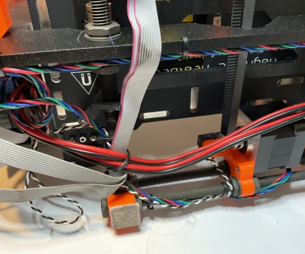

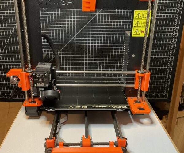

this appears to be a Prusa Mk2.5 S
this is A Mk2 frame with 12 volt magnetic heatbed and Mk3 style extruder (I have one of these )
The lower right Z motor bracket is non standard, and the upper right Z bracket looks broken
if the tension in the Right Z assembly is front to back, replacing the Z Motor bracket with a standard one may help
If the tension is side to side, Slackening off the Black 'POM NUTS'  (Lead screw nuts) on the Z Motor shafts, may allow them to re position in the orange X axis end pieces and resolve the tension (Slacken both sides and move the X axis assembly up and down the Z axis to try and re seat the parts.
the Y Platform is held in place with cable ties  (this was done on the Mk2 printer, as standard) Later models used U Bolts or metal clamps
My cable ties are still working.
Do you have a removable build plate to go on the heatbed?
Posted : 14/02/2024 9:53 am

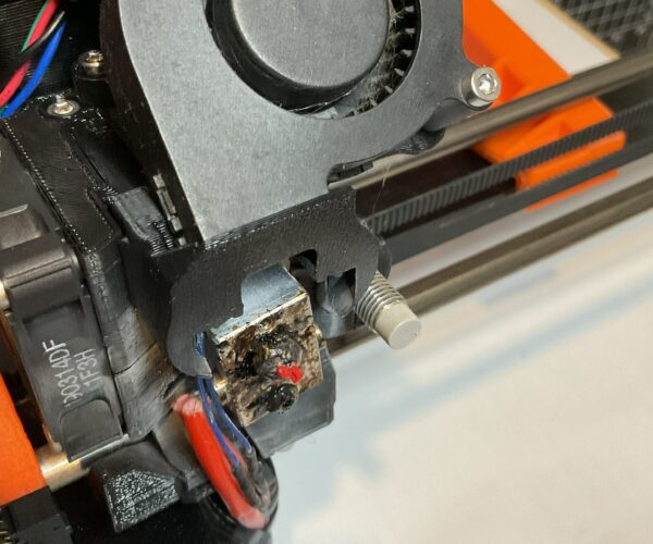

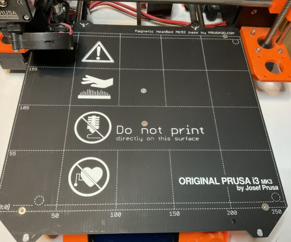

So I make sure I know what model the is is for when I research needed parts and instructions on how to use it this IS a MK2.5S?
The heat bed is marked as a MK3.
If the lower right Z bracket is not standard or correct then it's most likely the reason the upper right Z bracket is broken and creating tension on the smooth and threaded rods.  As the Z axis arm moves up both rods start to lean forward and a little to the right.  When I try to manually hold the rods in place where they should be in what's left of the upper bracket there is tension but not a lot or enough that it seems like anything else might break or be breaking (no crackling/creaking noises).
I'll research the correct part for the lower Z bracket.
I do have a removable build plate.  I believe it's an older one that's smooth or not power coated/textured.  It too is labeled as a MK3 part.
If this is a MK2.5(S) is there anything I can or should do as far as maintenance and maybe upgraded it to has high a model possible?

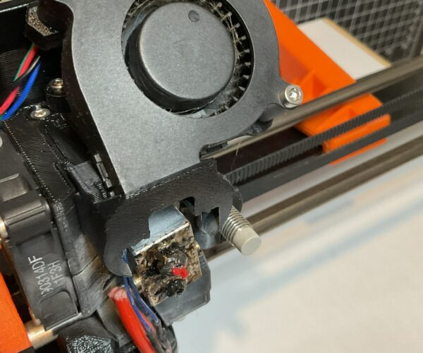

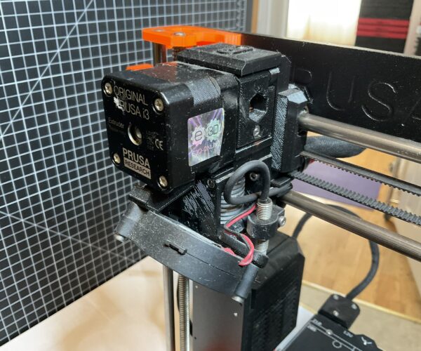

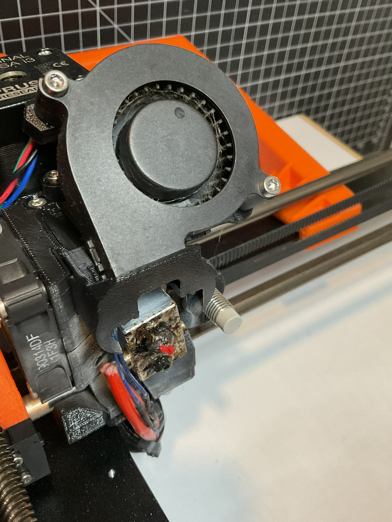

When I look at the pic of the hot end or nozel it looks pretty worn or in bad shape.  What should I be looking for in regards to that part or area?  If I can clean it up to at least perform a test that would be nice.  If I can't clean it up I'd eventually like to replace it, but I'm trying to gather as much info and listing of necessary parts to make one big order to cut down on multiple shipping charges.
Thanks so much for your help, I appreciate it.

Good morning Alan,
Have you considered reaching out to Prusa owners in your area.
Or perhaps seeking a local maker space or Hacker space
Perhaps even a local library with a 3D Printer?
the spare parts that you need are not big parts and someone local may be prepared to print them for you.
I Live in the UK, so I am probably a bit far away
the Z axis part files that you need, are available at the URL Below
https://www.printables.com/model/88231-i3-mk2s-printable-parts/files
these are basic Prusa Mk2S files
Z axis parts  (Z axis top and bottom  brackets in a zip file)
If you need any Prusa Mk2.5S files they are available  at the URL Below
https://www.printables.com/model/88638-i3-mk2s-to-mk25s-upgrade-printable-parts
The frame on your printer is a Mk2 frame with Threaded rods for the lower frame,
the Mk3 Frame, has Aluminium extrusions for the lower extensions, which is different to your printer
Your printer has the Mk3 style filament roll holder, however it is installed Back to front,
The filament roll should be supported behind the main frame, not in front of it.
Where the filament holder is attached on your printer, it will prevent the extruder working at the top of ‘Z’ axis travel.
Your heatbed does say Mk3 in the front right corner BUT in the rear left corner it also says ‘12v’ (for a 12 volt printer)(ignore the arrows this image was cropped from the assembly manual)
The Mk3 printer is a ‘24Volt’ printer  the heatbed that you have is intended for the Mk2.5 upgrade (12 volt printers), similarly the build  plate will show mk3 because that is what it was originally designed for, and Prusa saw no advantage in creating a mk2.5 variation for what would be physically an identical item (A Mk4 build plate would work perfectly fine on the Mk2.5 printer heat bed)
Your nozzle is a little contaminated with old filament, but I have seen much worse.
I would simply heat the nozzle to say 250C and wipe the waste off with a cloth, being careful not to burn your fingers.
Beware! Some folk recommend using a brass brush, to clean the heater block,   there is a very real risk of damaging the heater and thermistor wires and causing a catastrophic short circuit that will damage your mini Rambo printer controller!
your heat block seems a little turned out of line but that’s not a big issue.
You say your nozzle may be worn…
It’s difficult to comment with the red filament in the way
Please be aware that there are LOTS of different nozzle types available on the internet.. the ones for the Prusa mk2.5 like yours are ‘E3D V6 Nozzles’  the design of the nozzle is very important, ‘Mk8 Nozzles’ are very common, but they are NOT suitable for a Prusa printer like yours   Inside the heat block, the nozzle and the heat break, MUST be in intimate contact, in order to prevent filament leaks...
the length of the screw thread on the ‘V6’ nozzle is critical.
I Hope I haven’t caused overload.
Best wishes with your printer
Posted : 16/02/2024 11:17 am

Posted by: @alan-martinez
 If this unit works at a minimum level I'll try to print the parts I need.
I looked at the pictures you have sent. And as far I can see, the printer should (mechanicly) work.
The filament holder is not needed (I do not use one, because my printer is in an enclosure, so any simple solution to hold your filament should work.
The not original part at the right side is no issue. Probably has been used for mounting a camera? Will not  be a problem when printing.
The broken part (right side on top of Z-axis). There is hardly tension on that part.
My advice: During calibration, hold the axis with a tie-rip (like it was before)
Durig Z calibration cut it off, hold it with your hand. (this is only needed at the start of the process)
As soon the calibration is running, quickly mount a second tie-rip and you will be good.
As soon the calibration is done, do some tests with first layer etcetera untill you are able to print the part what is broken in PLA (see my other post).
