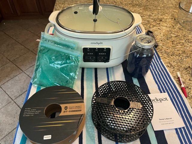

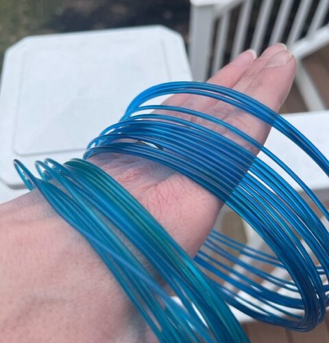

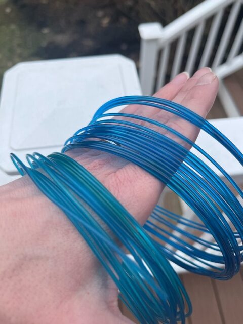

I finally got around to trying this - massive process improvement over juggling pots and thermometers and trying to keep a stable temperature on a stove top (or using my build plate). I am never going back - sous vide is the way to go!
A couple of notes - I cooked both PETG and PVB in this run at 70C and got good results... next time I will lower by 10C for PVB and raise by 10C for PETG. I also struggled to get a good color intensity at this temperature until I used a dye carrier ( https://store.jacquardproducts.com/products/color-intensifier-for-idye-poly?_pos=1&_psq=intensifier&_ss=e&_v=1.0). For anyone else using the Jaquard iDyePoly product, the 14g packets come with a dye carrier, but this must be purchased separately if you get a bulk dye.
For completeness' sake, and for anyone else who wants to try this - my process is below. Thank you, @robfrancis!
NOTE: Any equipment used for dyeing should not later be used for food, including the cooker. While the cooker (should) contain only water, there is always the possibility that dye will leak from the bag.
1) Mix iDyePoly / color intensifier with hot water according to instructions
2) Measure desired weight of PVB / PETG and place into dry sous vide bag
3) Add dye into the sous vide bag, and remove air from bag before sealing.
4) Fill sous vide cooker about 2/3 full with hot water and start
5) Set cooker to 70C and 1 hour cook time
6) When temperature is reached, place sealed bags flat into cooker
7) When cooking is complete, remove lid, and allow water to cool naturally
8) Remove bags, retain dye (if not exhausted), and rinse filament
9) Pat dry to remove excess water, and dry filament in a food dehydrator at an appropriate temp (45C PVB / 65C PETG) for 6 hours
Enjoy 🙂
PVB on the left, PETG on the right in second picture.
Note variable deposition on PVB - in this run, I did not pause to circulate dye in the bag: next time!
