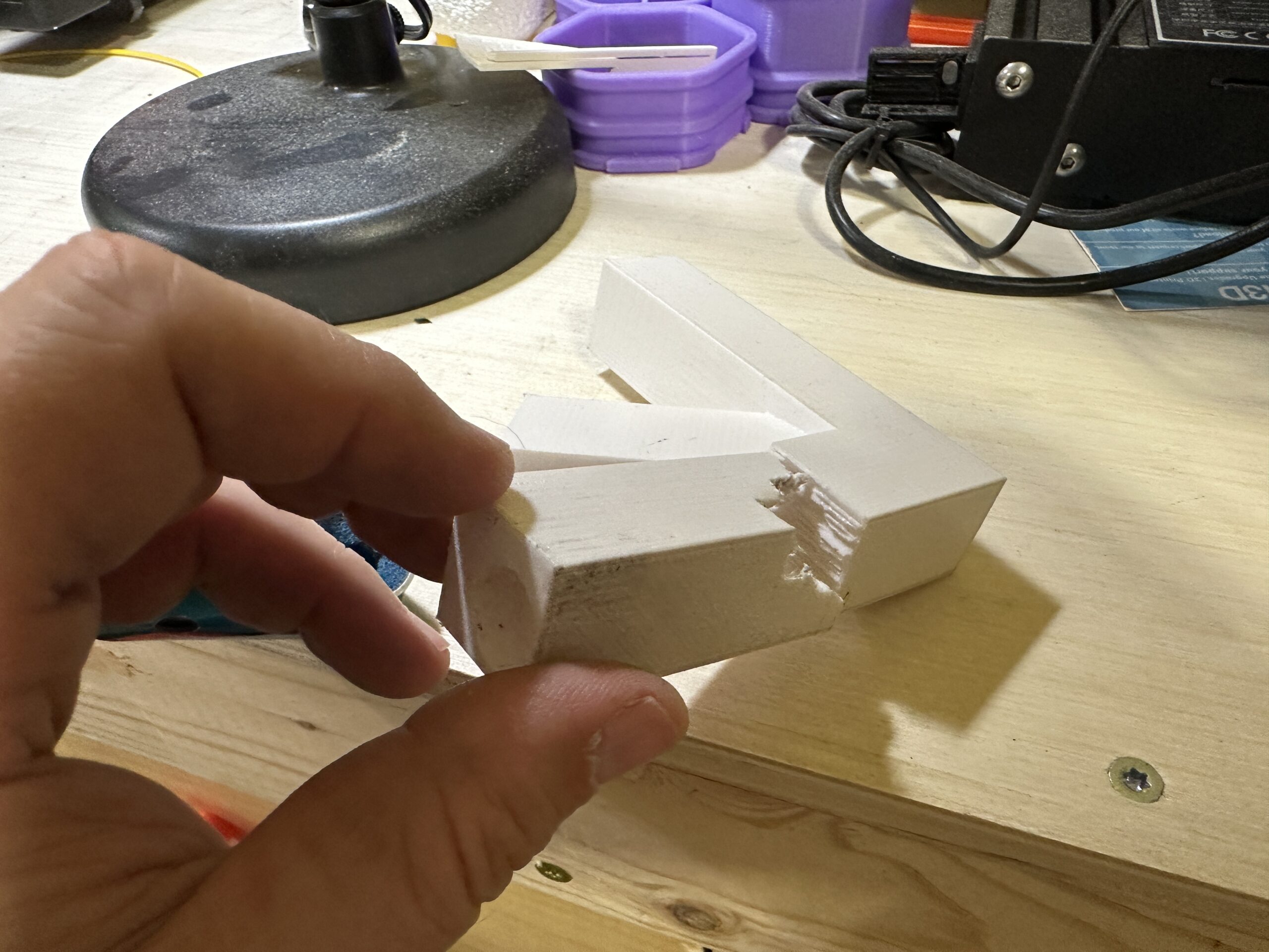

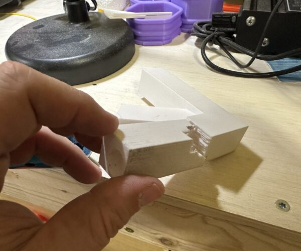

Update on this issue.
Here's the shape I'm working with:
That's 2 test pieces, done in different thicknesses to test the fit. To help make sense of the shape, this is for a vent hood. One piece will be at each of the 4 corners. The diagonal connector that sticks up a bit is for the tubes that will meet near the center, where the vent outlet will go. When printing, I'm using PETG and I slice it like this:
The diagonal is at a 12° angle when it's sitting flat, (like in the first photo), so I need to orient it like this to get a good print instead of wasting support material. For ease of reference, I'm using this screenshot from PrusaSlicer and referring to the two squared struts/connectors as "vertical" and "horizontal."
First, I printed it using a 50% infill for the full object. Due to an accident (I'll get to that later), I found pre-drilling a hole in the end and using a #10 screw in it and found that, with the 50% infill, the screw gripped it quite well, so I'm thinking that'll be sufficient.
I ran into a problem, though (and might start a 2nd thread addressing just this issue - we'll see if people can help me here). I found the diagonal and vertical struts fit in my 1" square aluminum rods just fine. The horizontal strut was too tight and I had to use a rubber mallet to pound it in. On the one hand, that's not an issue, since I seriously doubt I'll ever want to disassemble this hood once it's done. But it would be nice if all 3 struts fit in snugly, but not so tight they done come out.
Why is the horizontal strut a slightly different size square than the vertical and diagonal ones?
As to the screw - once I got it in, to verify I could do it, I used the rubber mallet to try to knock it out of the tube. That broke the piece and left a good part of the strut in the rod. Here's the connector when that happened - and the remains of the strut that was inside the tube:
I was going to just use larger drill bits to try to break down the part stuck inside, but I realized that was a great chance to see if 50% infill would work. So I pre-drilled into the end and screwed a 3" #10 screw into it - it held as tight as I can imagine, so I think the 50% infill is enough. Then I went to a bigger bit and drilled a hole down it, then an even bigger one, then used a screwdriver to chip away and break down parts of the stuck part until the end, at least, was loose enough for me to grip it with a vice grip and pull it out.
Overall, I'm going to just use 50% infill for the entire part. I was going to use higher infill for just parts of it, but I think it'll handle stress better if the interior is all consistent. Also, the hood will be attached to drawer sliders and some connectors may have 2 screws in a strut instead of one, and it'll be a pain to work out just where to put the reinforcements since I might have to adapt to how things fit, so I can't be sure, until it's together, just where screws will go into the connectors.
