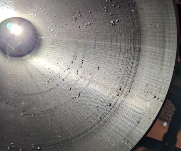

Said lumps Recently I noticed there was zits forming on my 3D prints, my girlfriend argued with me that it didn't look like them because the rest of the print was smooth and not like the over extrusion pictures she saw. Anybody able to identify these lumps?

Z-Seam perhaps? Try to set it to Aligned in Print settings and see if the blobs move. On a circular object with no corners, the slicer can't hide the z-seam.
