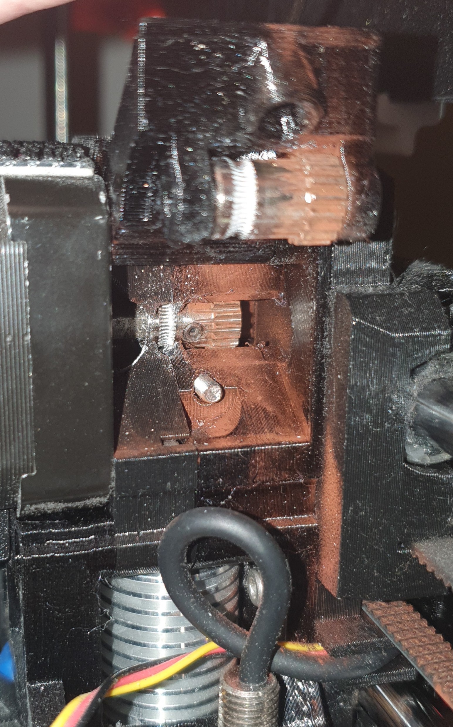

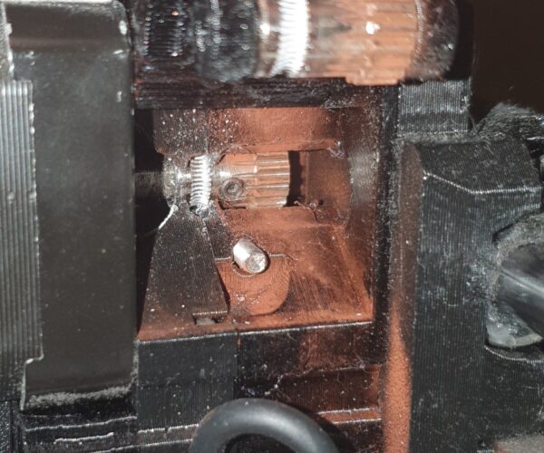

My nozzle was clogged overnight, so my extruder was grinding the filament for quite a while. When I opened up the extruder, I saw a lot of brown dust.
This is puzzling to me, because for the past few months I have only been printing white PLA, and I don't think I have ever printed brown... My first thought was that this is burned residue, but this explanation is implausible to me, because the dust is so far from the hot part of the extruder. The printer is in a clean environment (no sawdust or anything).
Any ideas what might be causing the brown dust?

if the gear teeth have not been lubricated, this could be rust particles.

I think you are right. I cannot remember the last time I lubricated them, and when I try to rotate the gear by hand it is not a smooth movement. Whoops! This is probably also the cause of my filament clogging, because cleaning and replacing the nozzle did not solve it.
Would you recommend lubricating the gear with something like this, or is it a lost cause once they are rusty and should I just replace the part?

Superlube will do

This helped for me, Joan. Thanks!
