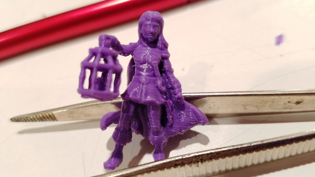

Hi! I just got a new Prusa I3 MK2 printer and have been trying to print various things using in gaming, such as miniatures, and terrain pieces. I'm able to print some larger pieces ok but am having trouble with small pieces, especially miniatures.
This miniature in particular
https://www.thingiverse.com/thing:2121172/#files
I can't get her feet to stick to the print bed for long, she comes free after a few passes (the initial few stick). I'm using the default gcode made by prusa control. I've tried adding supports, and was able to get her printed out, but she was so covered in supports I could barely see the model. Looking for any tips on how to tweak the printer or prusa control to print smaller models.
Thanks!

A brim will help.

This is a difficult print. Besides the brim (I assume you'll need Slic3r PE for this) you could print it together with the base so it has a larger stand.
Of course you'll have to switch on support - even then the cloak and lamp are difficult as they start in mid-air. You might try different orientations, like leaning back 30°. That way supports only connect on the back and the front surface stays clean.
You can increase bed adhesion if you clean it with acetone. For everyday use, I use alcohol (IPA), but once in a while I need to use acetone; after that, prints stick like hell.
What size are you aming for? I have printed 23 mm figurines in 0.05 mm layer height, which is quite tricky.

It can be done with a decent brim and supports. This was done standing vertically at .15mm layer height, 80mm/sec default, and supports. It could be a lot better with .1mm or .05mm, but I don't have the right nozzle for that. I also attached the gcode so you can look at how I printed it.
