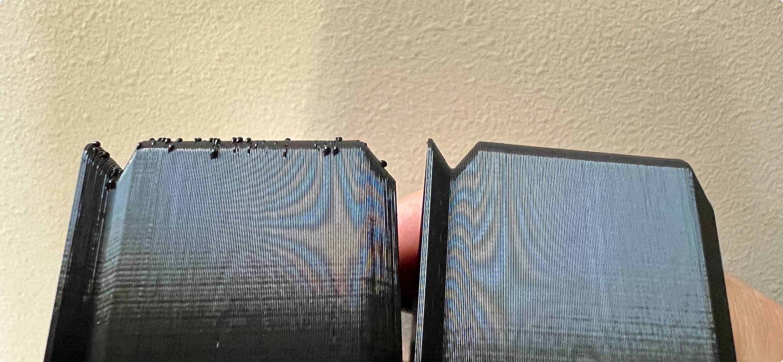

After installing RPi Zero W, my Prusa MK3S+ has frequent, temporary hangs during a print that negatively affect print quality. These hangs usually happen once every 10 or 20 seconds, and only last a second or two, but the extra extrusion during that time will often ruin the print surface.
Photo below is side-by-side, the edge of a model printed using the same Gcode, same filament, etc. The only difference is that I powered down the machine and removed the RPi. Removing RPi resolves the print quality issue. I also confirmed it's reproducible 100% of the time by starting another bad print after connecting the RPi again.
Video shows the in-print hangs when the RPi is connected. I have not yet tried leaving the RPi installed but turning off the port in software.
MK3S+ firmware is 3.14.0-8066
EINSy_10a (2024-05-22)
PrusaLink 0.8.1 on the Prusa-assembled RPi Zero W, purchased directly from the Prusa Shop with the GPIO soldering already complete.
print quality comparison

Removing RPi resolves the hangs and subsequent print quality issue.
