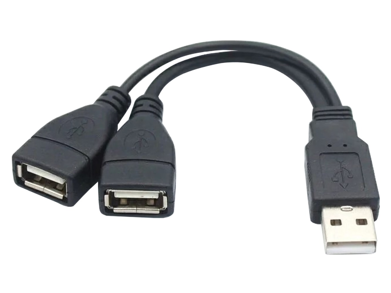

Hello,
my very simple and cheap solution is to use a USB port from the LCD. You just need the Y cable, one connector has a power and data (for USB flash) and the second one has a power only (for Buddy3D camera).
