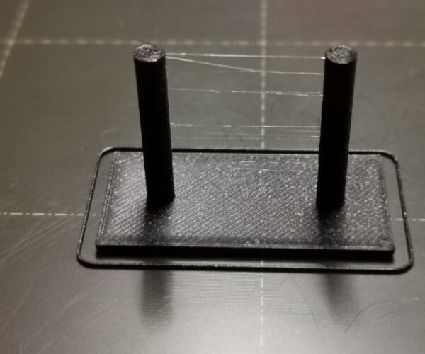

So after fixing numerous issues with the mini i have it printing some what good. The makers muse tolerance test printed great! all 5 parts turn freely and the center can be removed!
So I went on to try a different test for my mini but the stringing is horrific to say the least!
Retraction, how much should i dial it up by?
Are any other settings relevant to help eliminate stringing.
This file was printed with pursament pla and on 0.07 layer height from memory, sliced through prusaslicer.

You can try to set lower temperature and slower print speed from what I searched.
RE: Stringing! how to fix that?
What are you using to slice the model? Prusaslicer does not have coasting and this a bowden printer, so your rely on linear advance if supported by the mini firmware.
I would download a stringing test model and try to calibrate as discussed above, adjusting the print temperature. Printing speed should not matter that much, but bridging speed( or movement speed when not printing ) does.
When troubleshooting stringing issues try to determine where the blobs you see in the string are created. If they are created on the begging of a move you can use coasting to reduce it. if they are before the nozzle lands, at the end of a move, wipe will help. The size of the blobs can also provide guidance as to whether you are retracting too much or too little.
I assume the main issue is the little time your layers have to cool down. Like @peanutbutte7 suggested you could reduce the speed, but simply printing more objects at the same time is more effective and will do the trick as well. 😉
@minos197 confuses travel speed with bridging speed. But increasing travel speed could actually help. Also, coasting and linear advance are features to improve edges and seams. Bad settings will increase stringing, but if you don't have issues with the seams, you don't need to tweak those settings.
Lowering printing temperature will reduce stinging, but it also weakens your object. Same is true for more cooling.
If you want to tweak with your retraction settings: The retraction distance on a Bowden extruder is usually between 2 and 8mm and the retraction speed between 35 and 45mm/s. Start with low values, because too high values will introduce blockages.

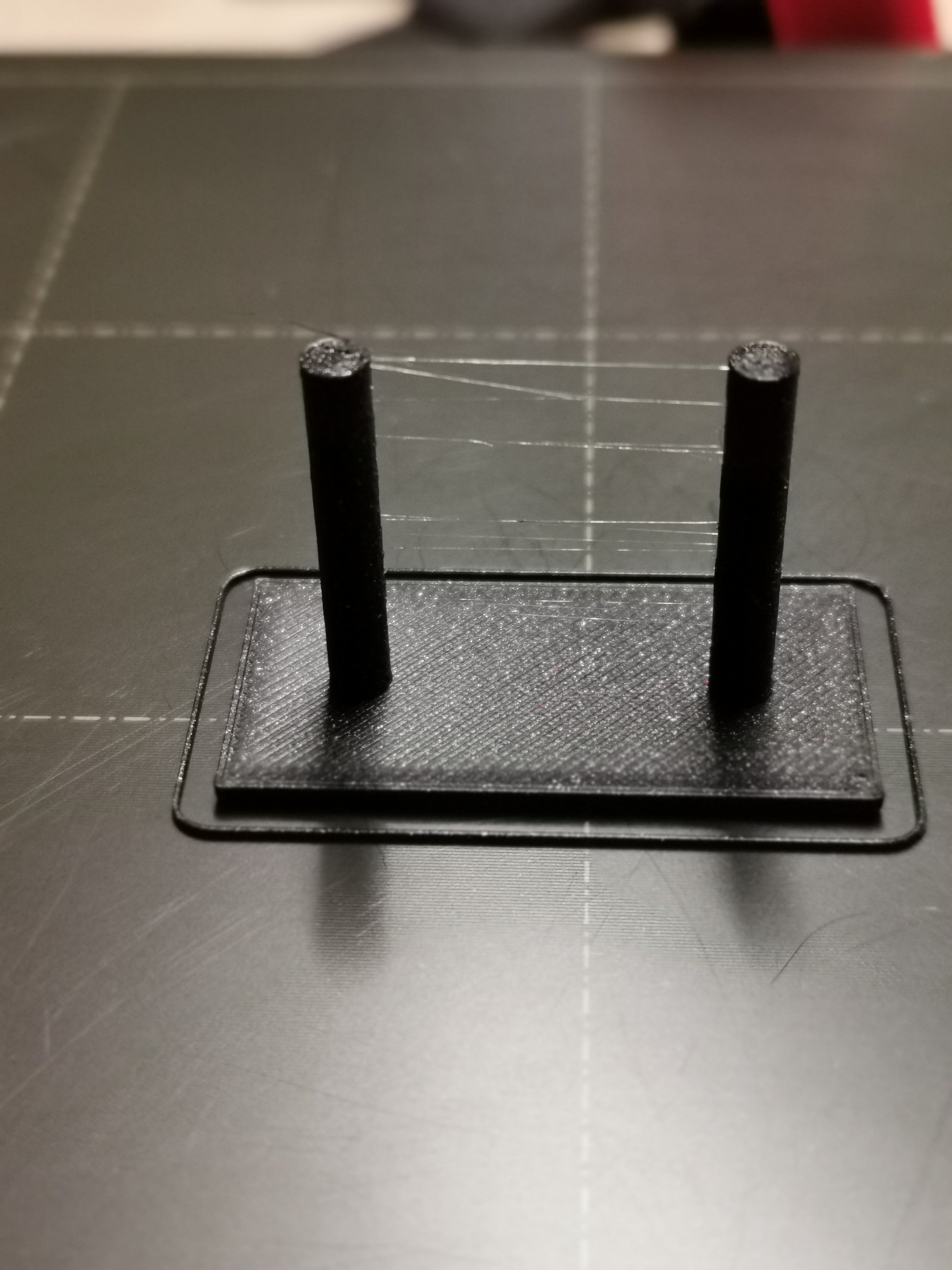

After reaching out to support and waiting a bit for an email back they had me strip this pain in the arse printer down again rebuild the hot end and after 2 jams I rebuilt it differently to the instructions (changed the method supplied) and I have it printing again and after a test print of the same file in the original picture 3d fillies filament printed great very very minor stringing! Granted it was printed at 200 degress and not 215. The print still "failed" as the printer printed the parts but they were fused together and did not turn. The file is 3 "eggs" one inside the other and if printed correctly they should turn independently of each other.
Im about to try again with prusament, fingers crossed.
I will slow the print speed slightly and slightly and report back.

I printed a stringing test and the stringing now is defiantly reduced. The first pin that prints has small blobs on the inside edge that I want to fix, I will have a play around with coasting and linear advance.

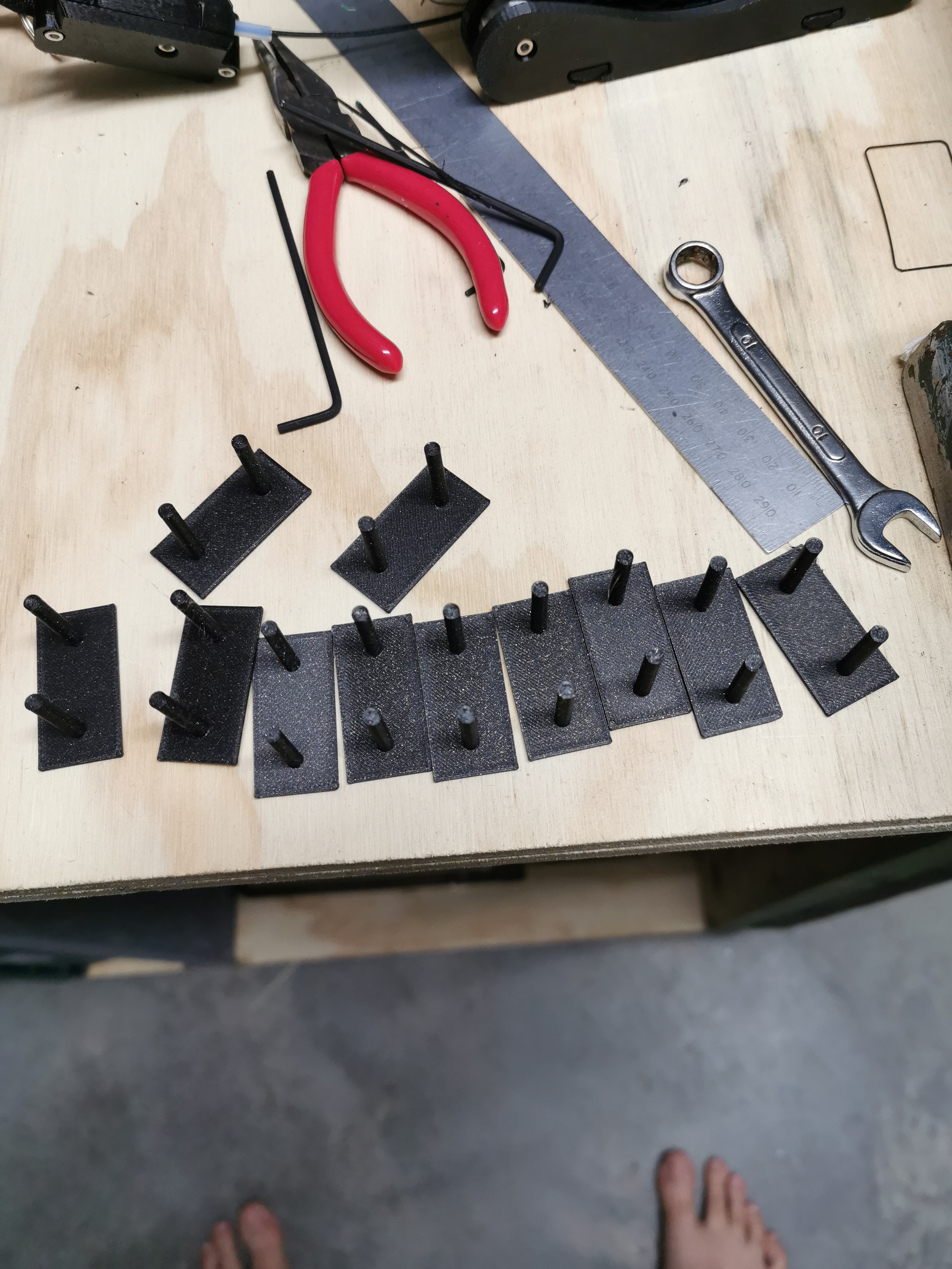

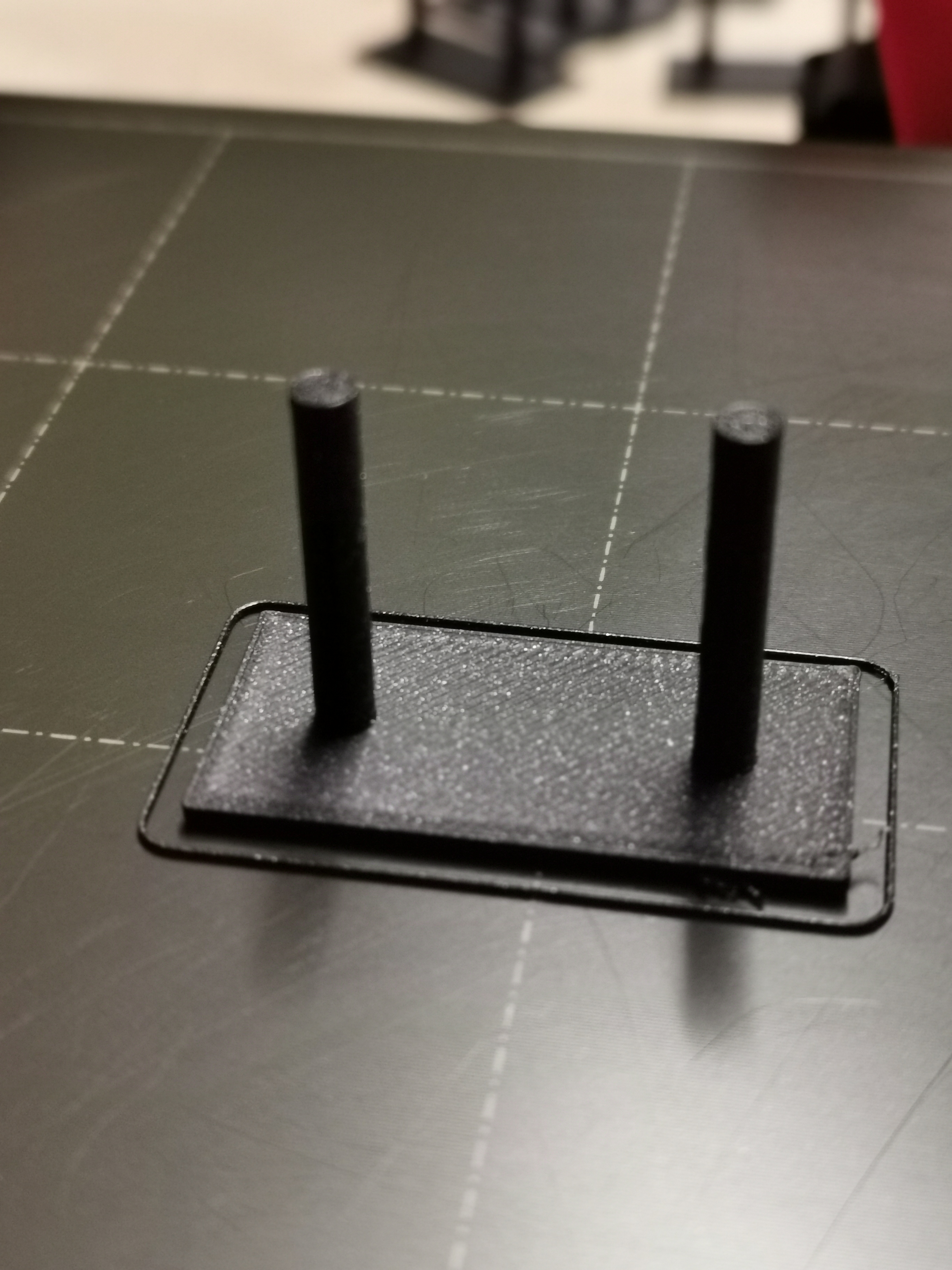

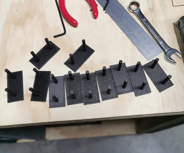

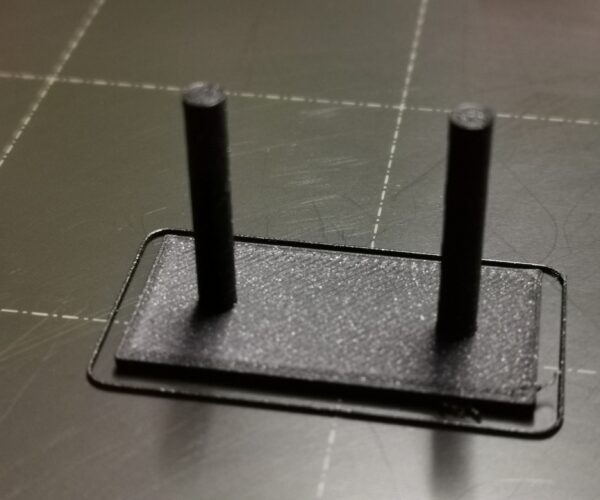

Do after spending 3 hrs on the chat with support. I went from this
To this
Very happy.
Retraction now at 3.8
Idler tension increased
Retraction on layer change enabled.
The stringing test came out great. I'm now reprinting the resliced torture egg to see how it goes
Respect the fact everyone is entitled to have an opinion, you dont have to like it or hate it, just accept its theirs and not yours and you will be ok!
Care to summarize their recommendations for the benefit of others who may be looking for a solution? Glad you got it working.
Retraction now at 3.8 - slowly increased this over prints
Idler tension increased - 1/2 a turn per print
Retraction on layer change enabled. This gave instant results. It stopped the blobs.
Make small changes and test the settings. Had to revoke some changes, but ultimately it's going great now
