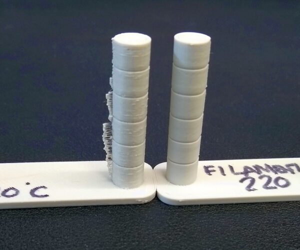

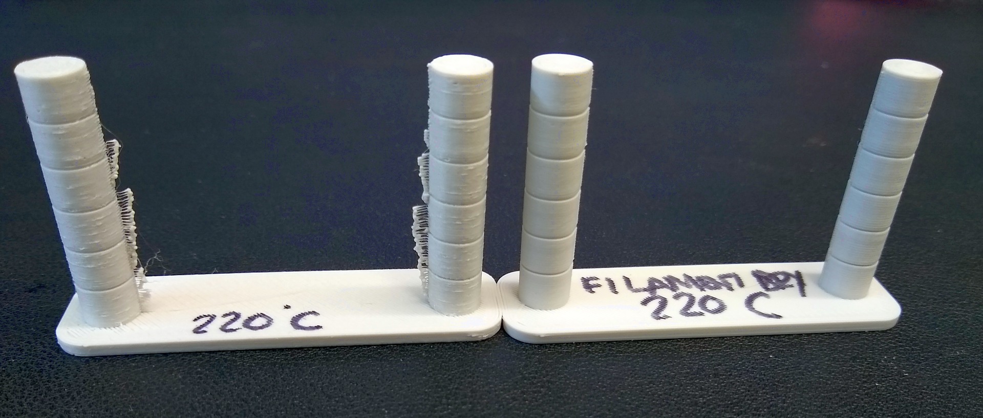

Hi All,
So I replaced the PTFE tube on my mini to see if I could resolve the stringing problem. This only marginally improved things.
I then tried drying out my filament ( PLA-X HobbyKing ) in a domestic oven at about 50 deg C for 4 hours. The prints I get are now significantly improved. The stinging in minimal even on the Prusa Retraction setting of 3.2mm, in fact it could be the best of my tests.
I've attached a picture of the results  of  my before and after. You can also see the surface finish is also a lot better.
I will now try my PETG and see if that improves.
This post was modified 4 years ago 3 times by PaulC
Posted : 26/08/2020 1:26 pm
