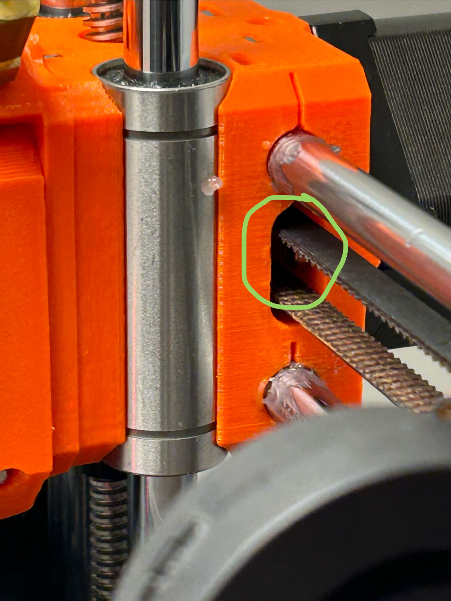

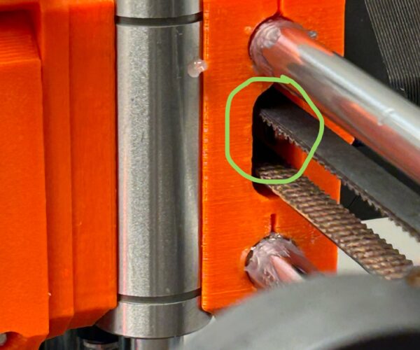

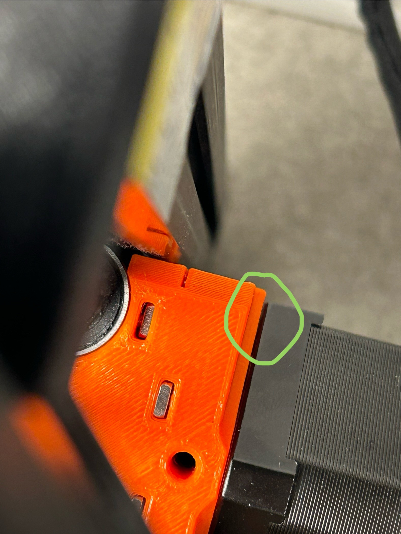

Old post but since I just managed to find the cause of the noise problem on my mini I thought I'd share.
Turned out the occasional noise in certain speed interval especially on x-axis moves was due to the x belt being forced towards the extruder side of the motor pulley, making it slightly touch the walls exiting/entering the motor mounting part (see picture. Taken after I fixed it though). My theory is that over time the motor was ever so slightly tilted, due to petg parts and belt tensioning, forcing the belt sideways. Different speeds generate different resonance vibrations which can explain the noise "sweet spots" where the belt grinds the most.
The holes for tightening the pulley screws allow only minor adjustments so I instead put a thin spacer between the motor and the mounting part on the outer screw. This aligned the pulley better according to belt angle and so far the belt exits/enters with margin to the walls.
Hope this can be helpful
