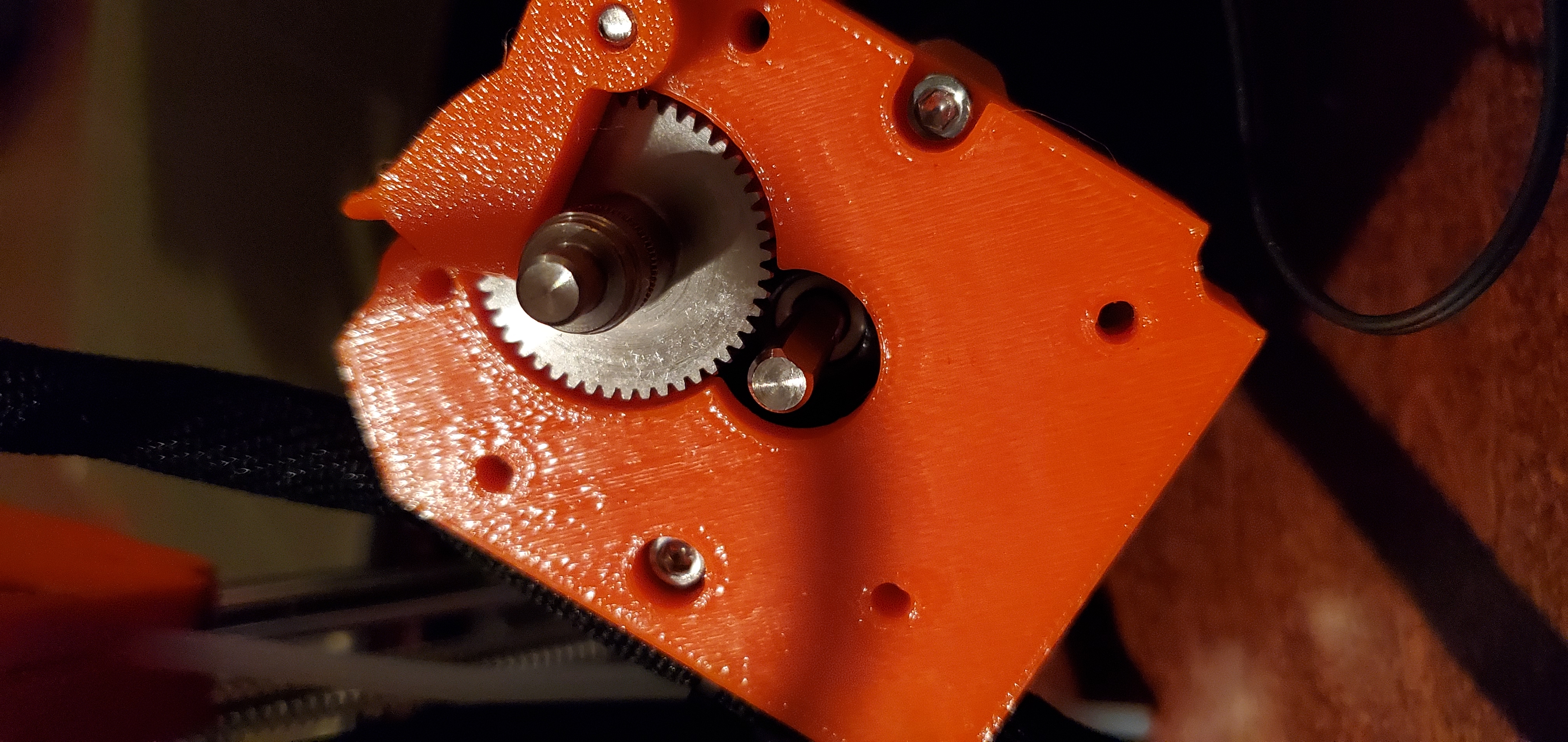

barney
(@barney)
RE: New arrived Mini: extruder doesn't work
@lr66
Thanks for the post. I was having a similar problem after assembling my new mini. After reading this thread to decided to take the extruder apart. As you can see from the picture the gear on the motor is missing. Now what? I am having trouble finding how to contact support. The site indicates there is a chat service but I can't find it or any other way to contact support. Any suggestions? missing

Texy
 Texy
(@texy)
Posted by: @barney
@lr66
If you can't see the chat pop up option , its probably because you haven't logged in to the website.
