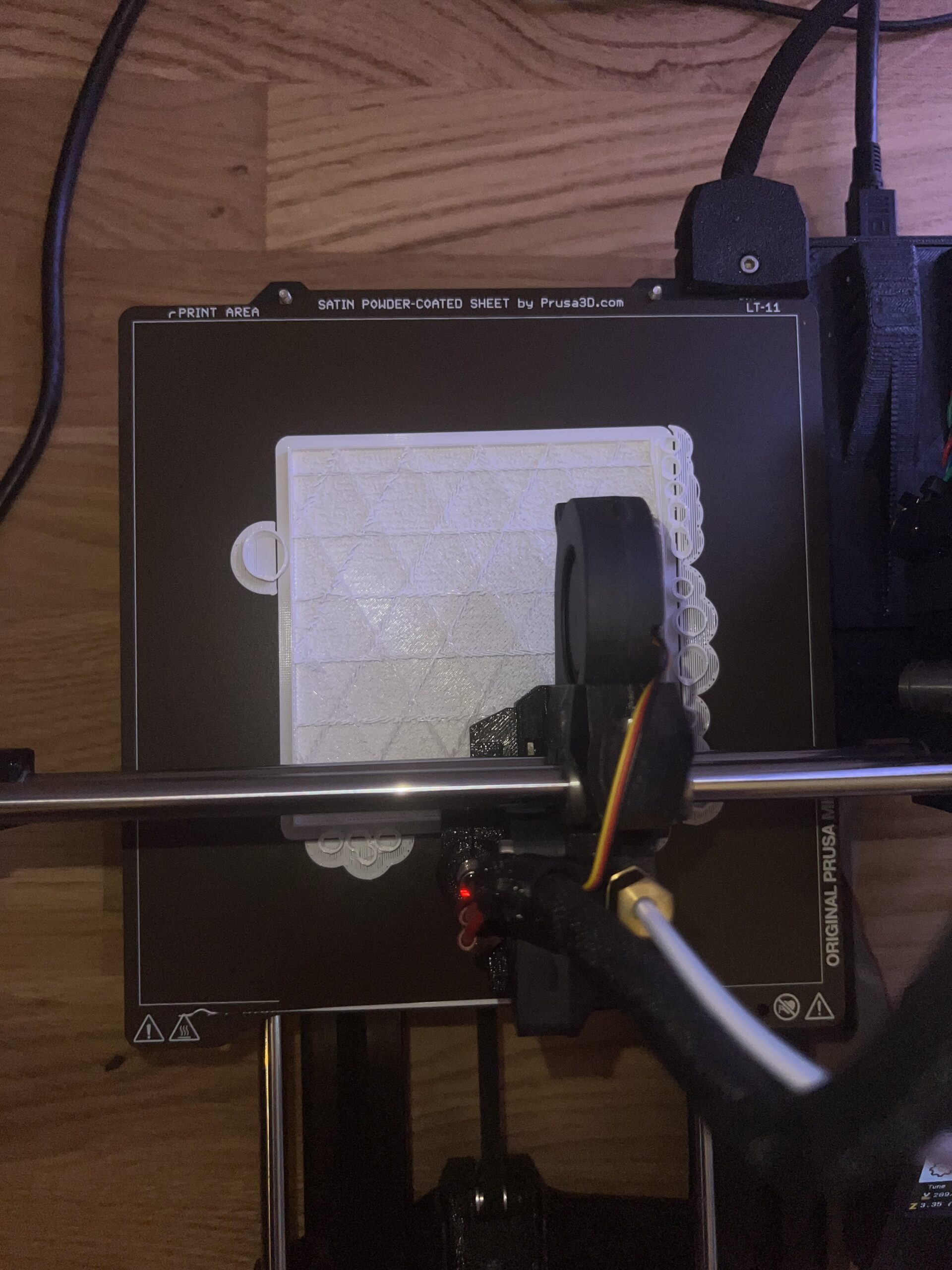

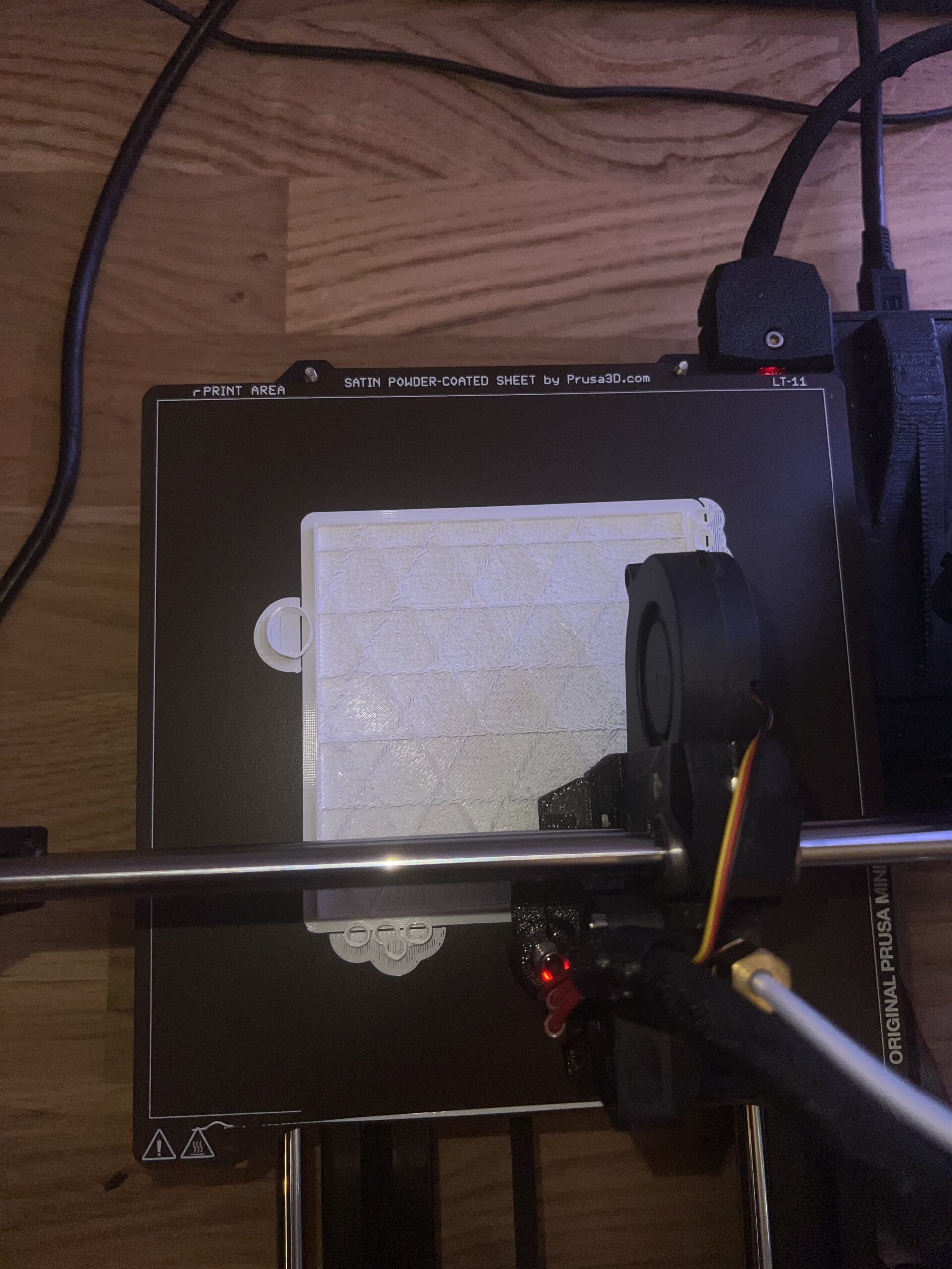

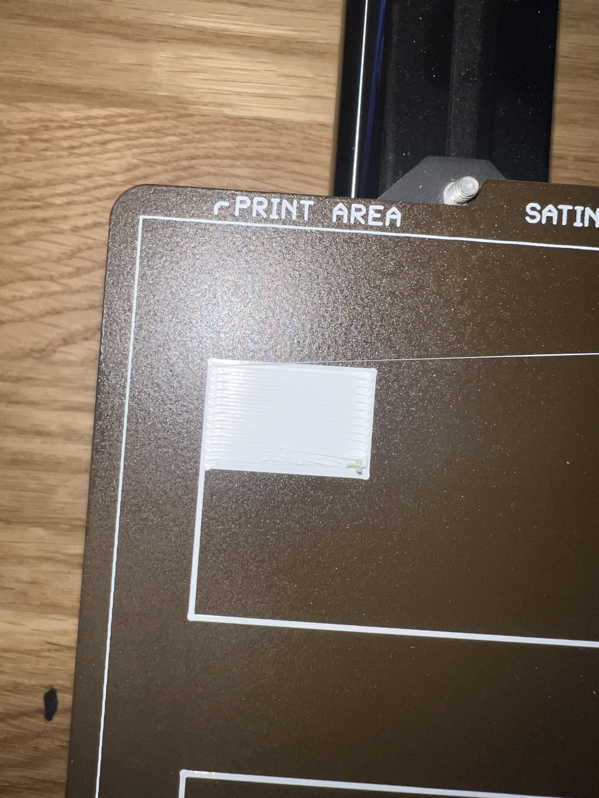

hello, i have already printed some pieces like that and it never happened before, everytime I print this piece it always comes very fragile and everytime I lower the offset Z to see if it gets better but it doesn’t. Can someone please help me fixe this

It depends what you mean by 'fragile', the video doesn't help ... but if you mean that the part flexes and has poor top surfaces then you might try setting infill at a higher value, 5% is not enough, both Adaptive Cubic and Lightening would support better without using too much filament.

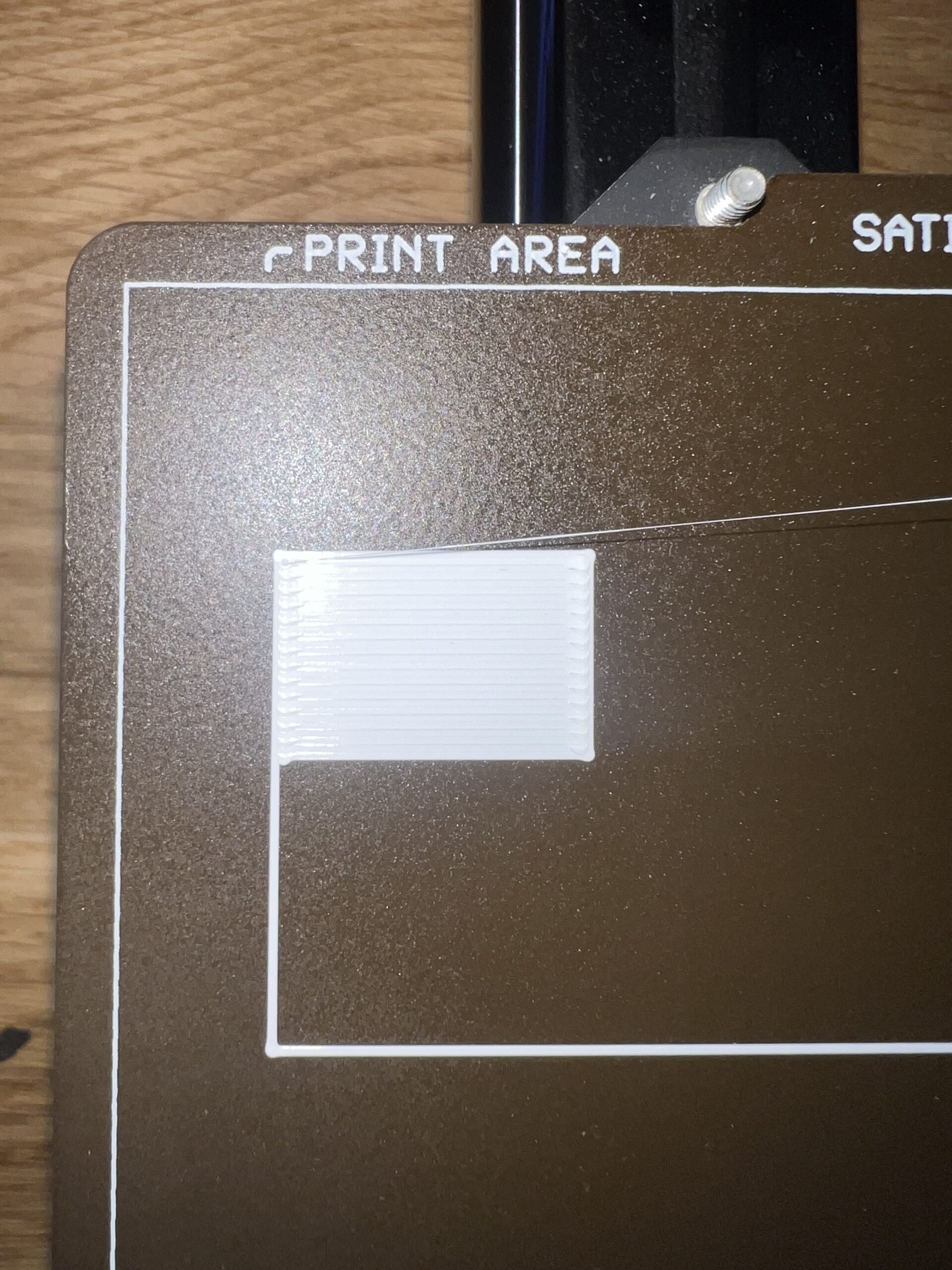

It’s like since last week I don’t seem to get a good surface for the bottom layer and the top layer, it has big holes in it
Posted : 25/05/2024 12:00 pm

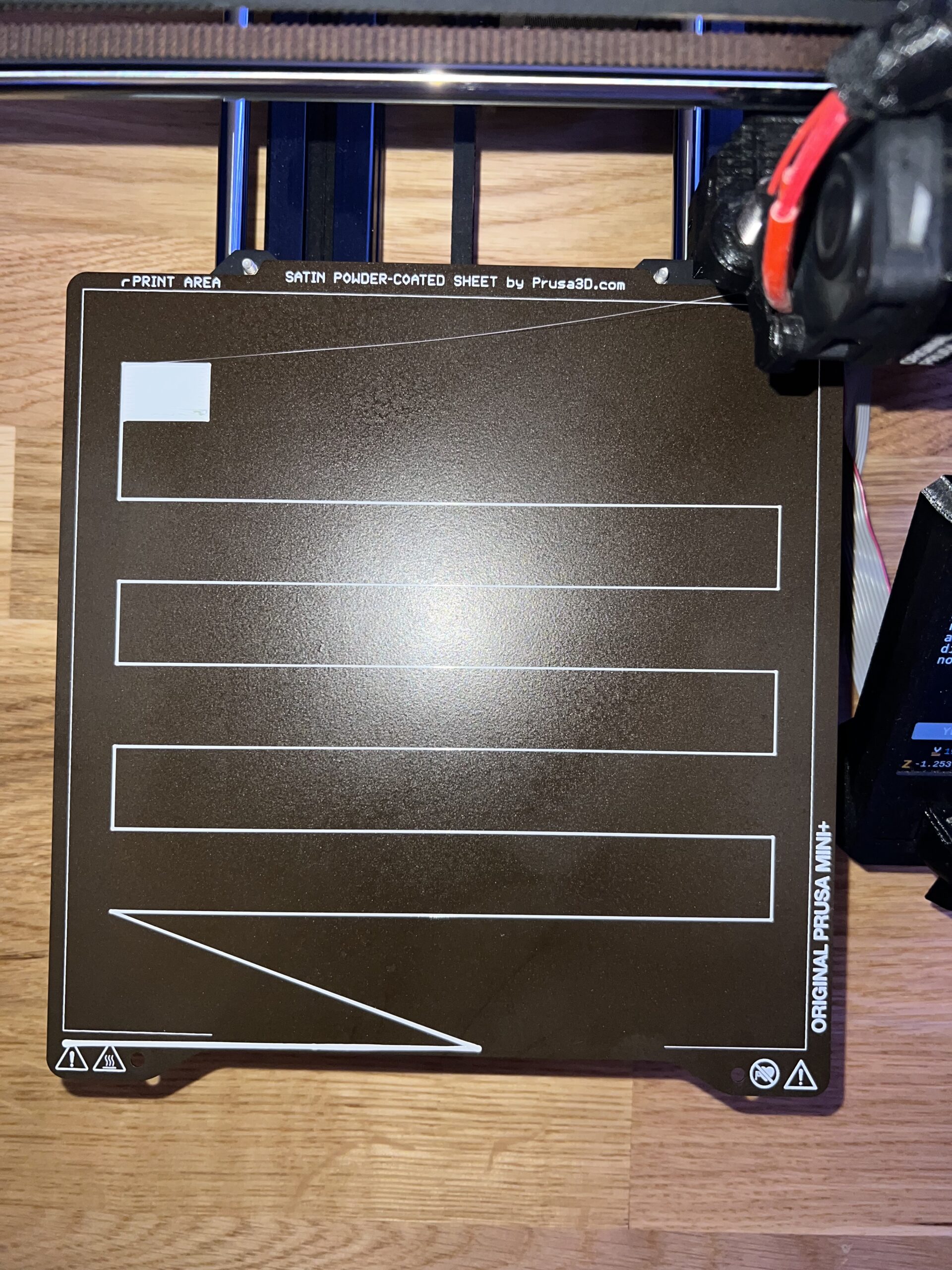

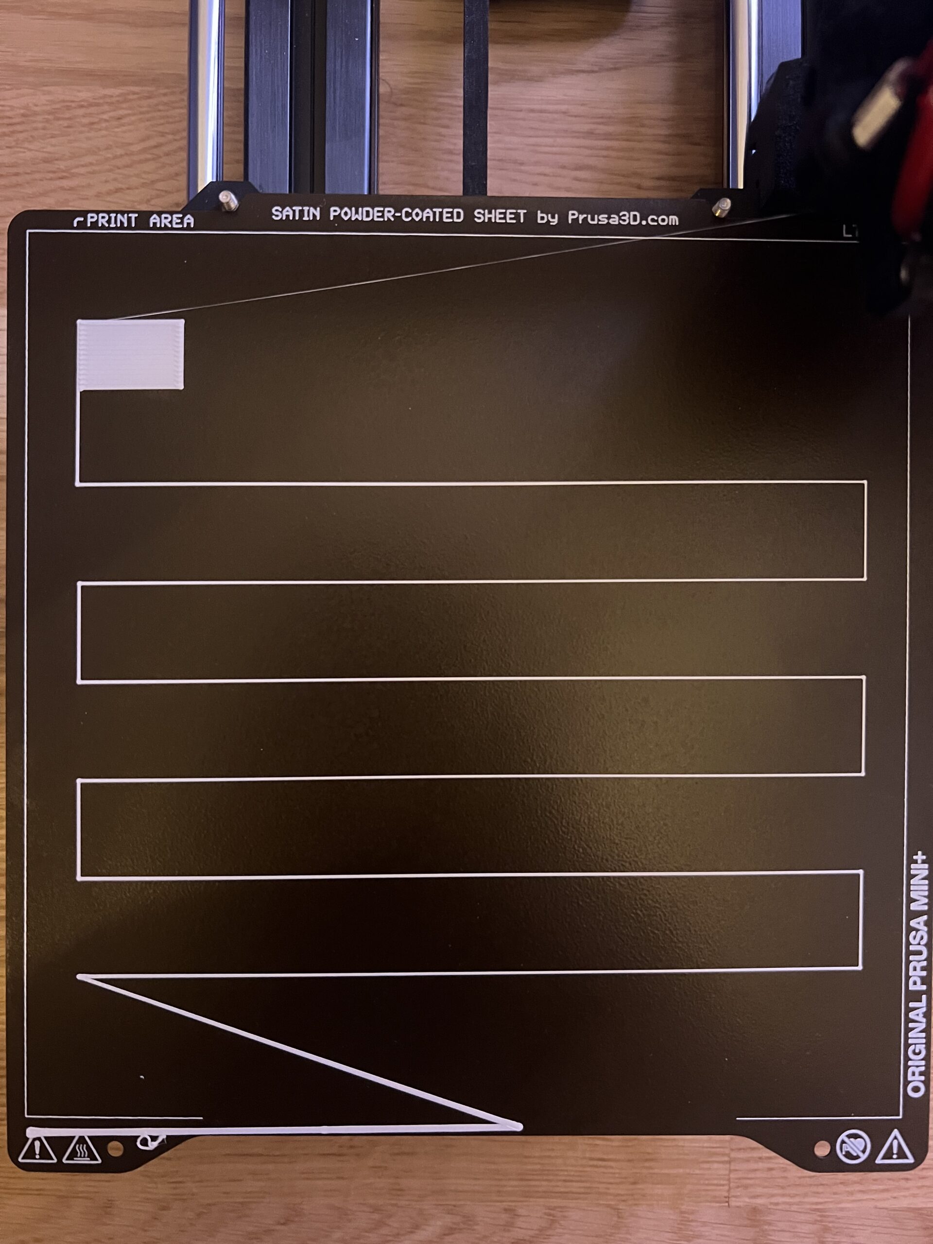

Run the built-in first layer 'Z' calibration and show us the result *on the print sheet*.
As above, 5% triangular fill is not enough.

I also tried it with 15% and it was still the same with the holes on the top layer.
Still triangles?  They're not ideal with flat surfaces.

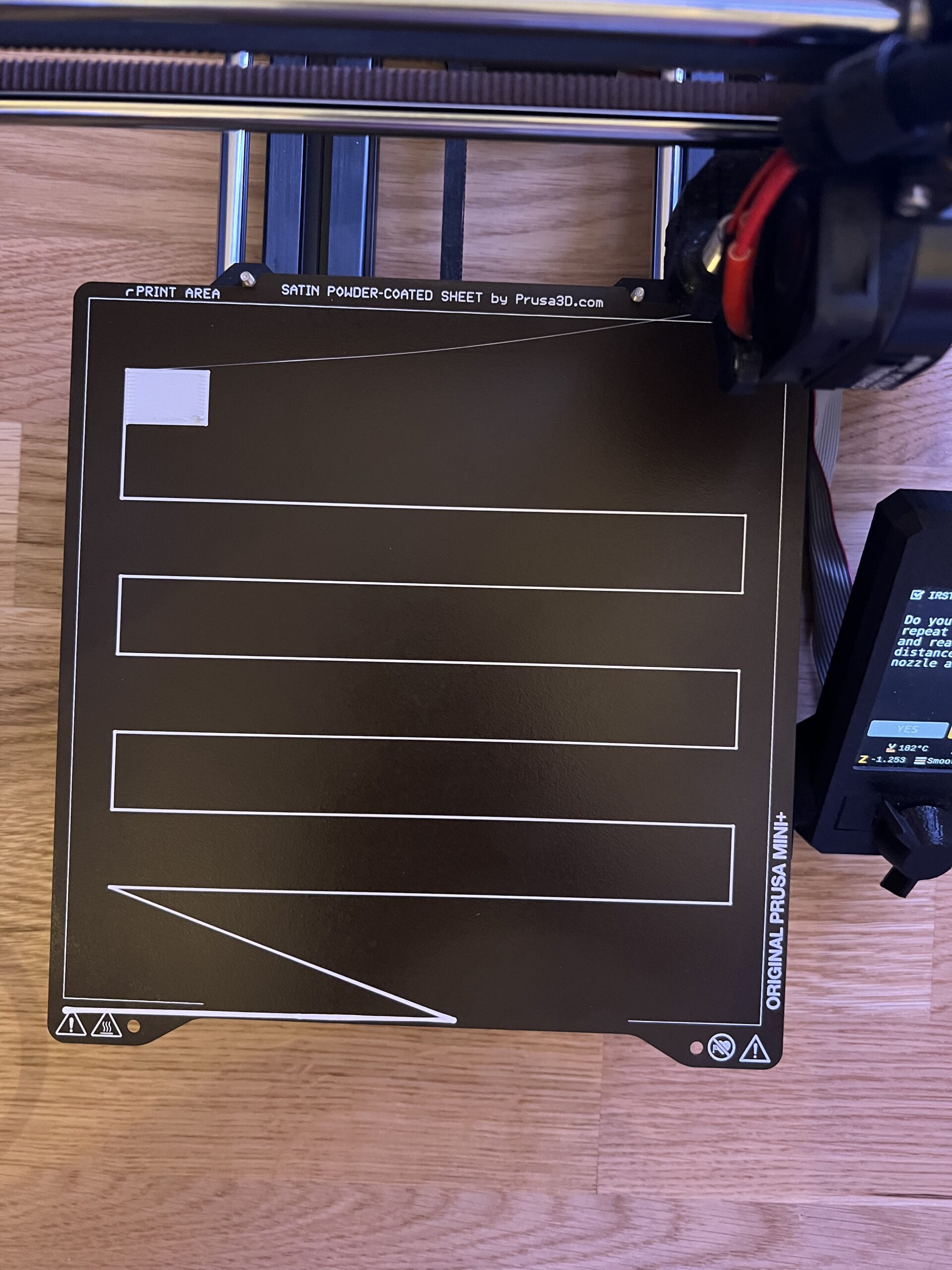

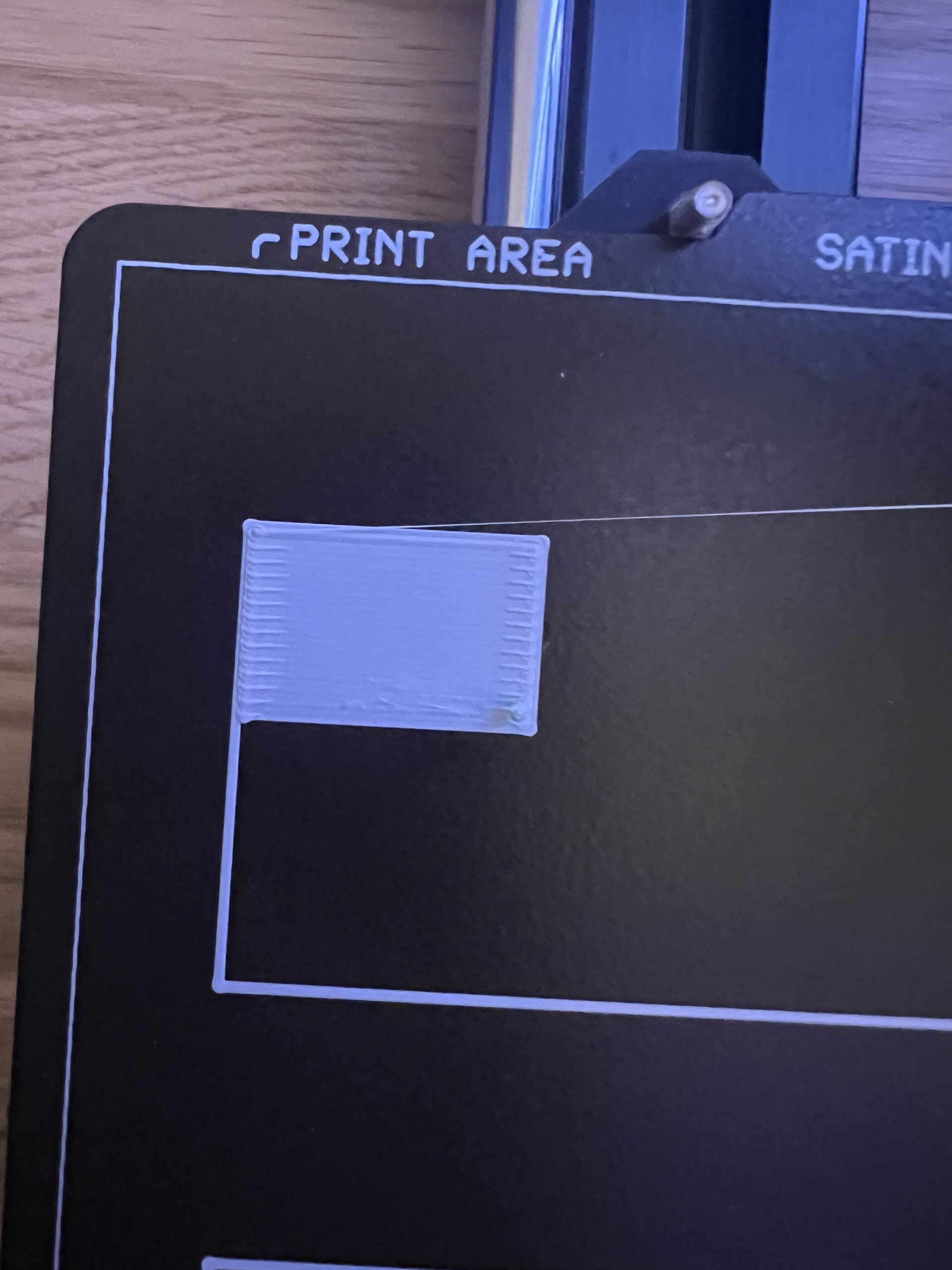

Your first layer 'Z' offset is a fraction low - back off until those ripples disappear, atm your nozzle is scraping up filament that has squished sideways and this excess has to go somewhere.

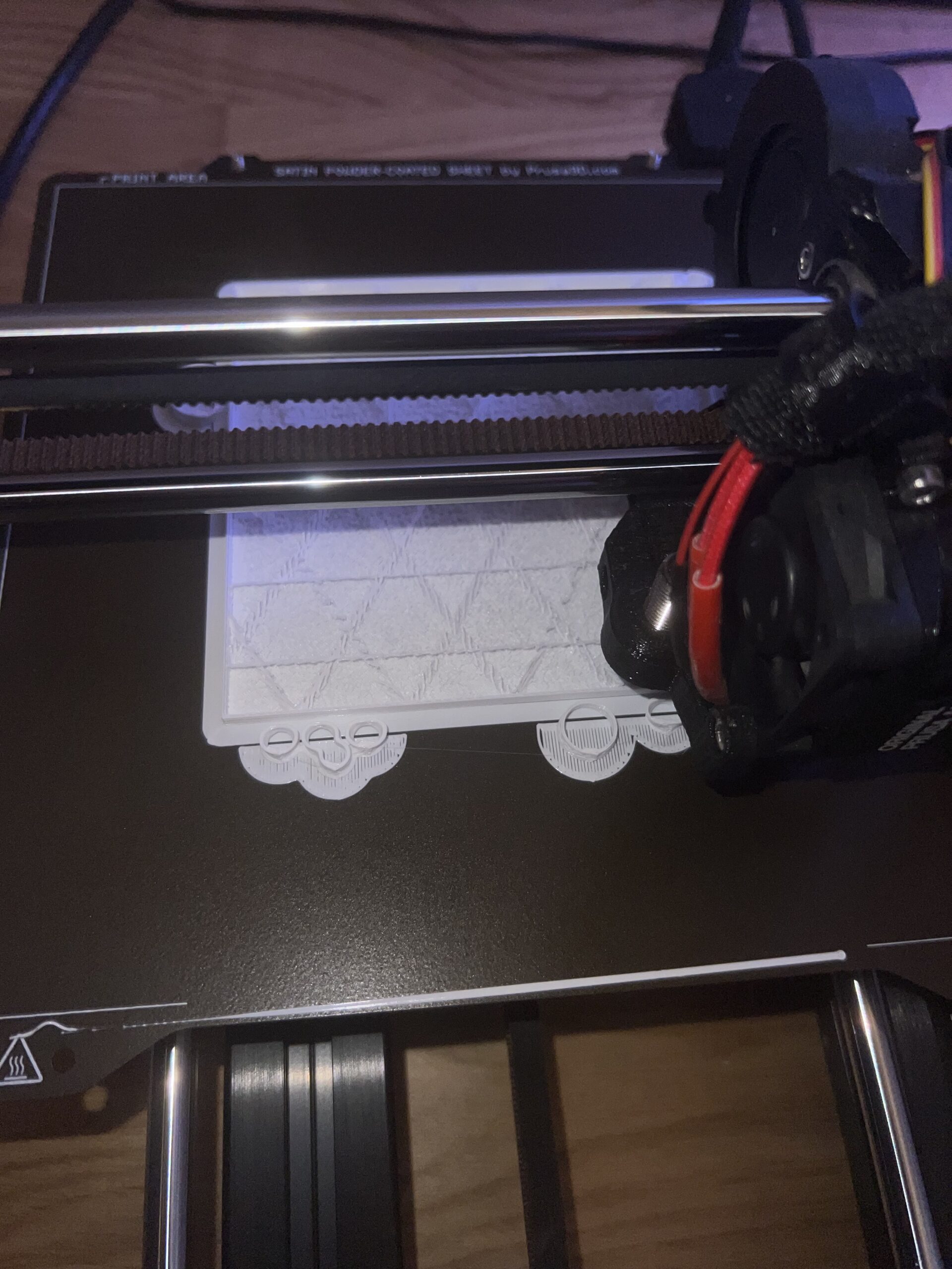

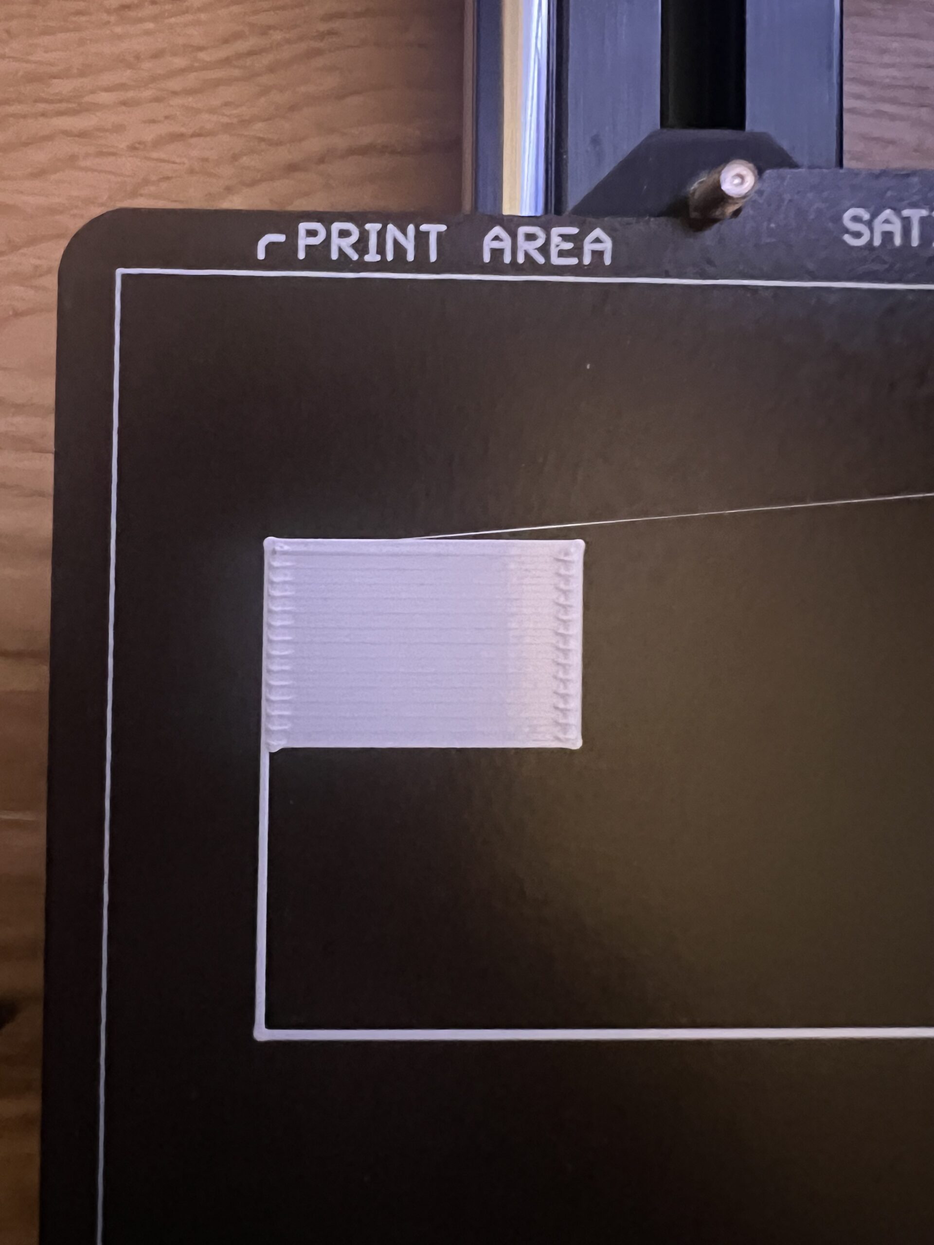

With grid

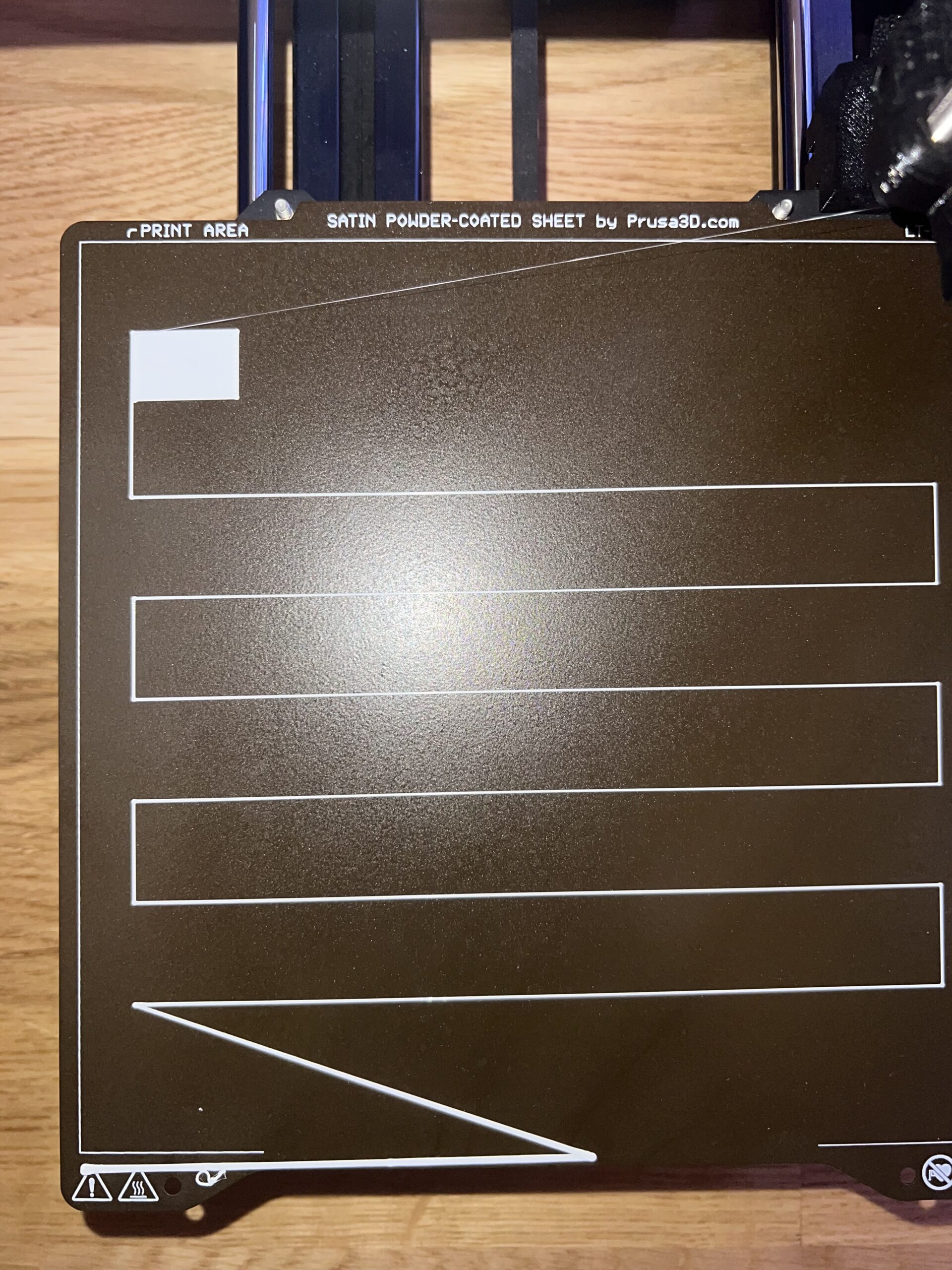

Is the offset Z now better? I lowered it from -1.250 to -1.170
Posted : 26/05/2024 1:27 pm
That's an improvement and will probably work but you could go a little farther.

Here is my favorite again: https://www.printables.com/model/251587-stress-free-first-layer-calibration-in-less-than-5/files

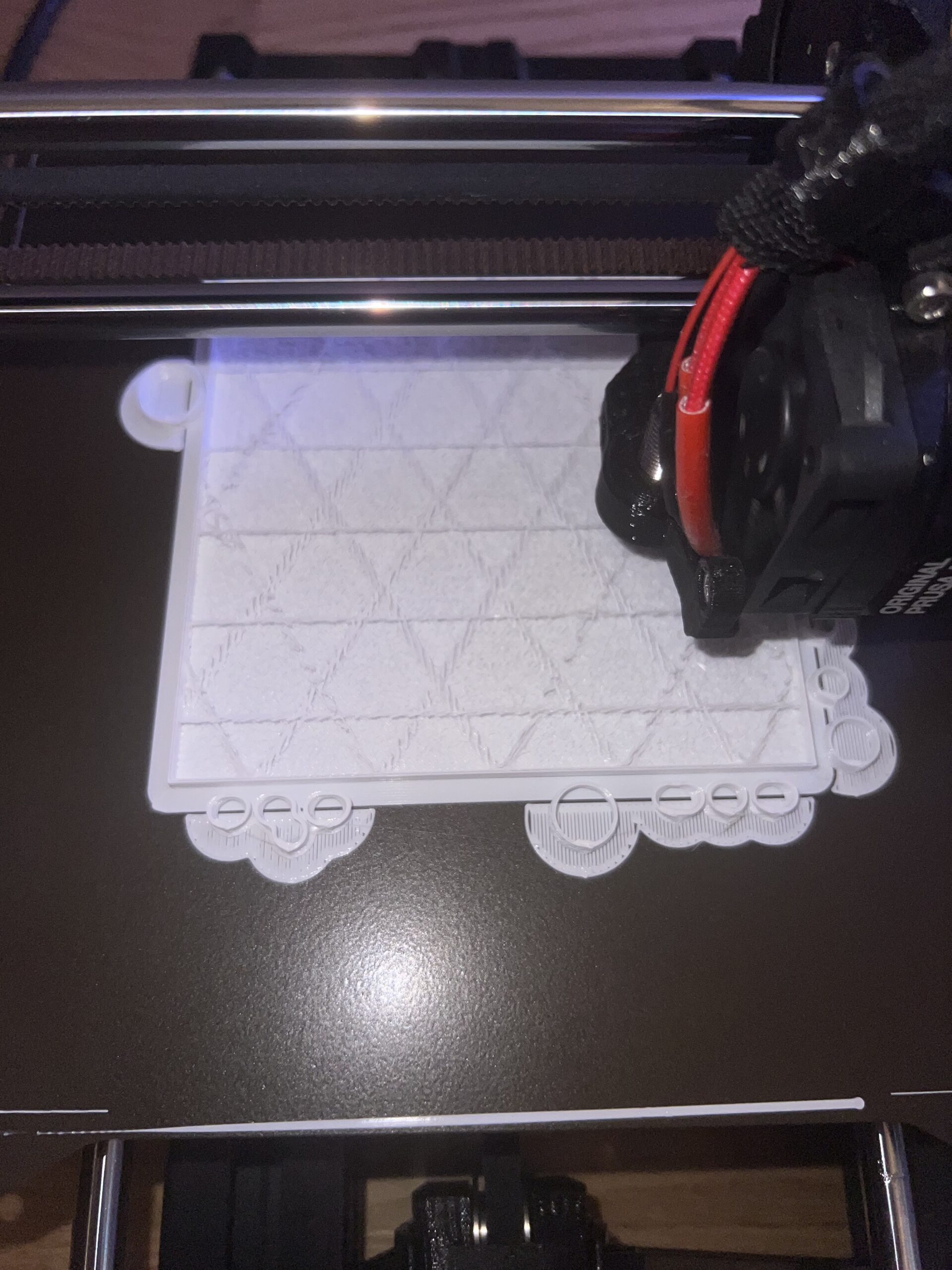

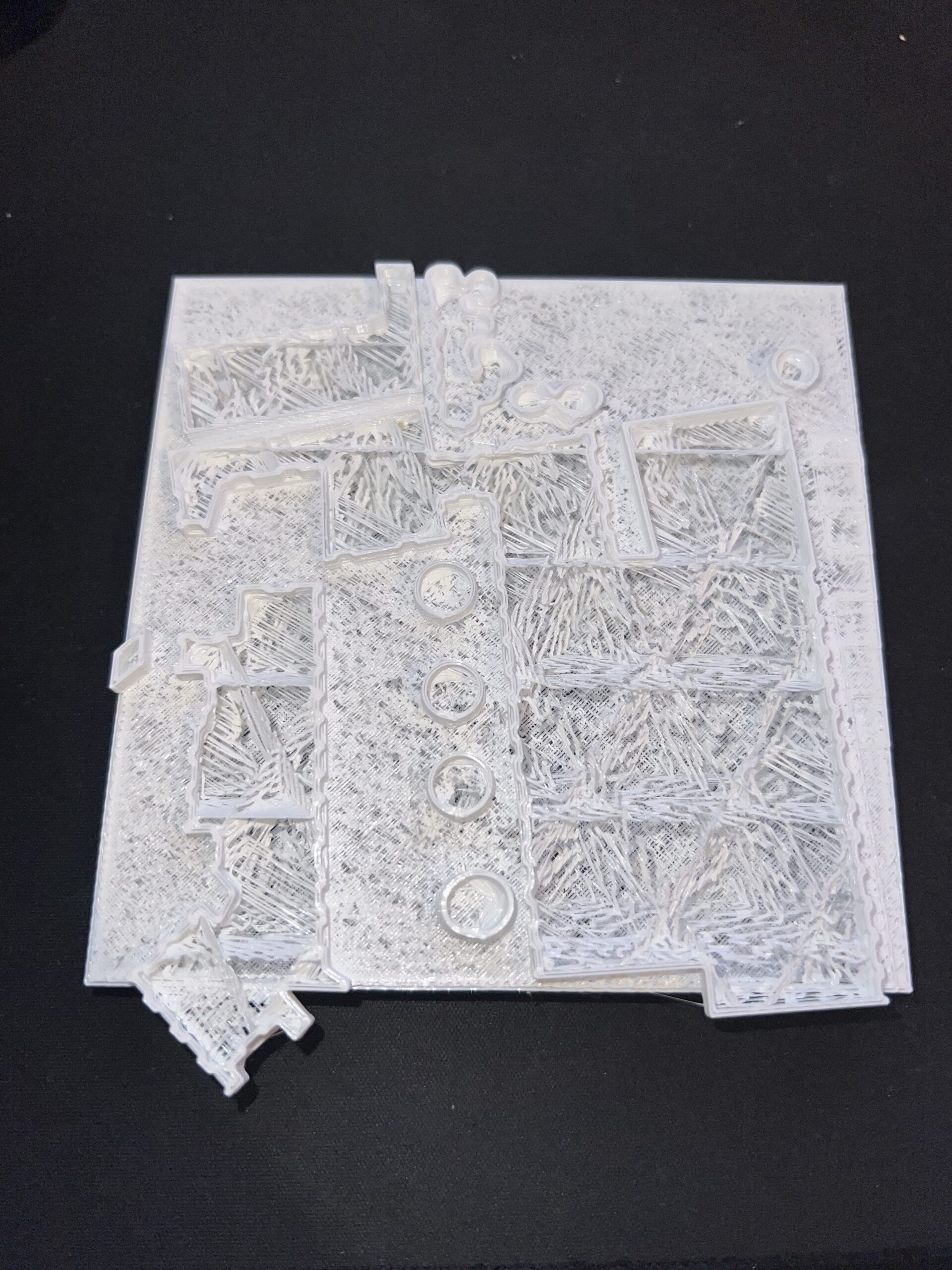

does this look normal? It’s 10% infill with adaptive cubic
Posted : 27/05/2024 12:13 pm
Keanu
(@keanu-2)
RE: Bottom and top layer very fragile
I canceled the print because it’s still very strange.
Posted : 27/05/2024 2:42 pm
Dry the filament for a few hours and try again.
